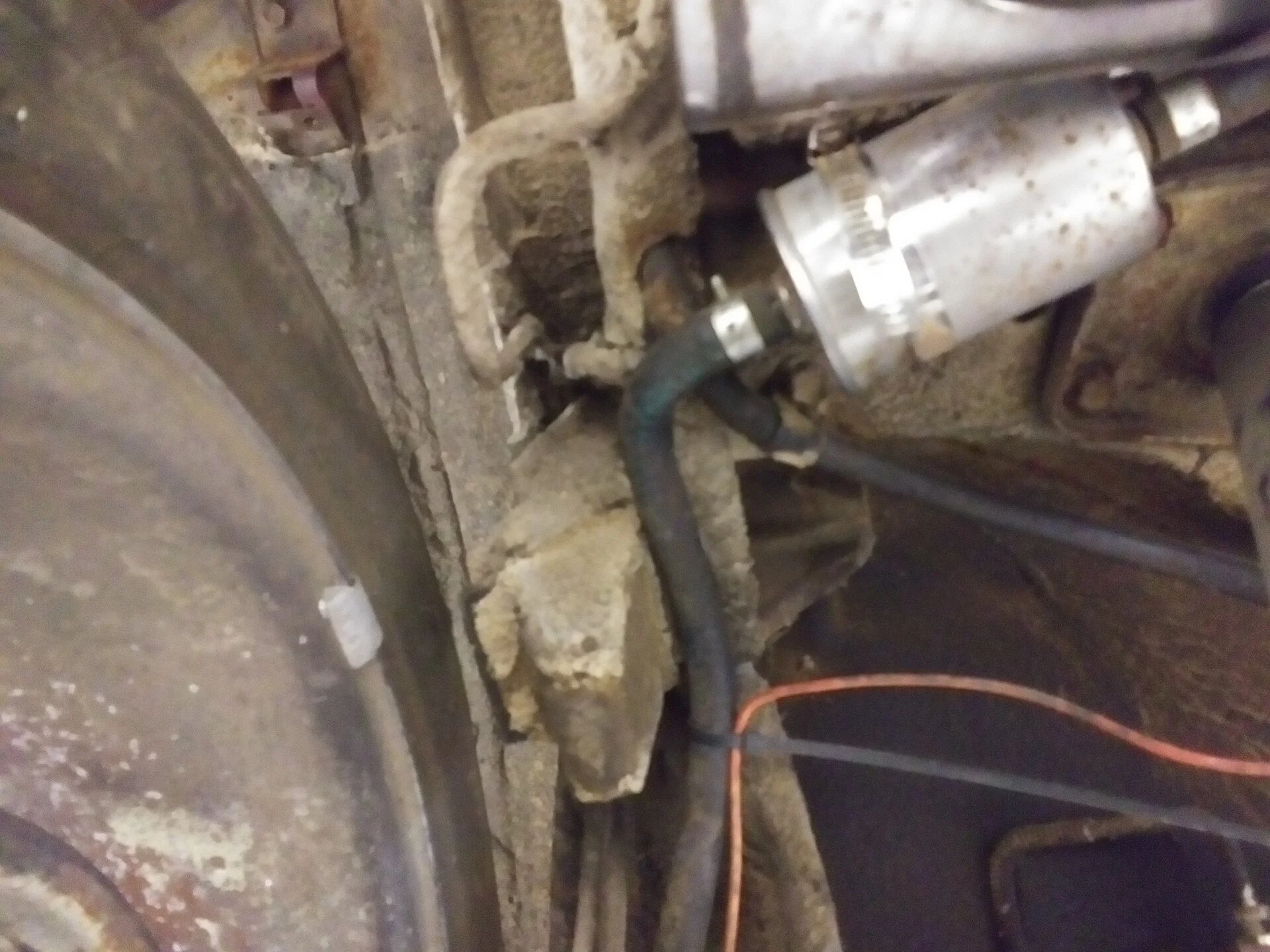

There's the fuel filter that got replaced.

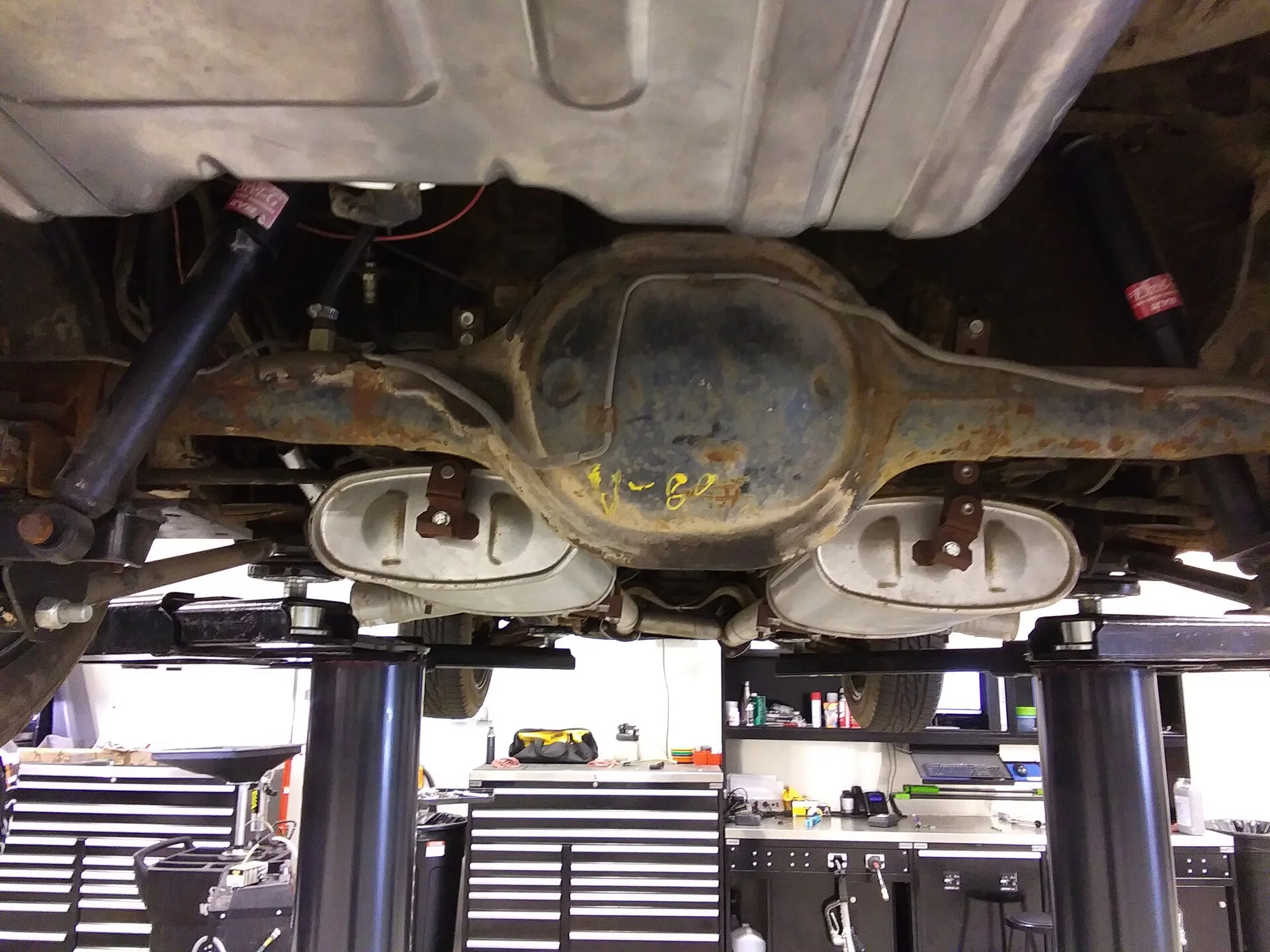

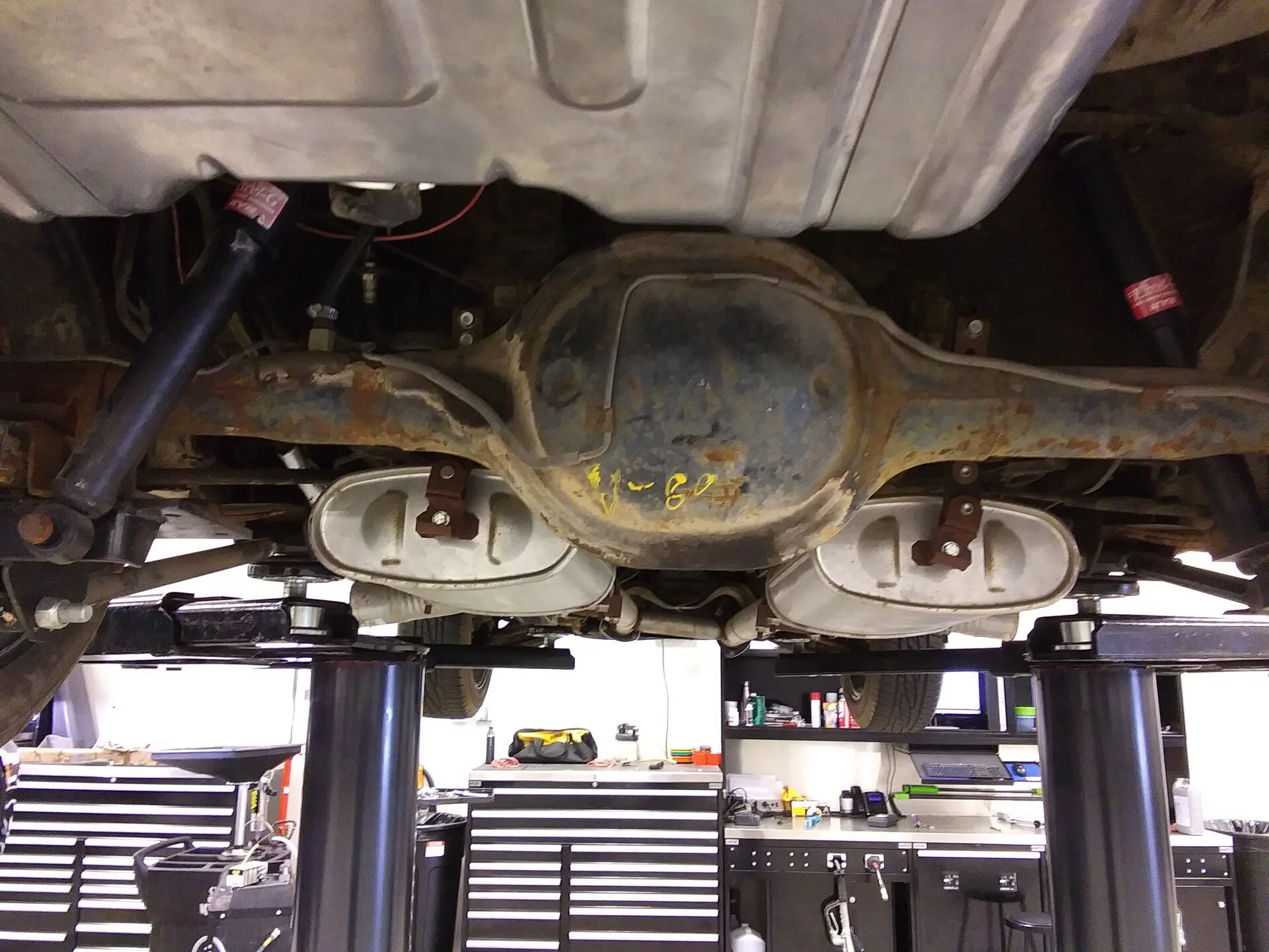

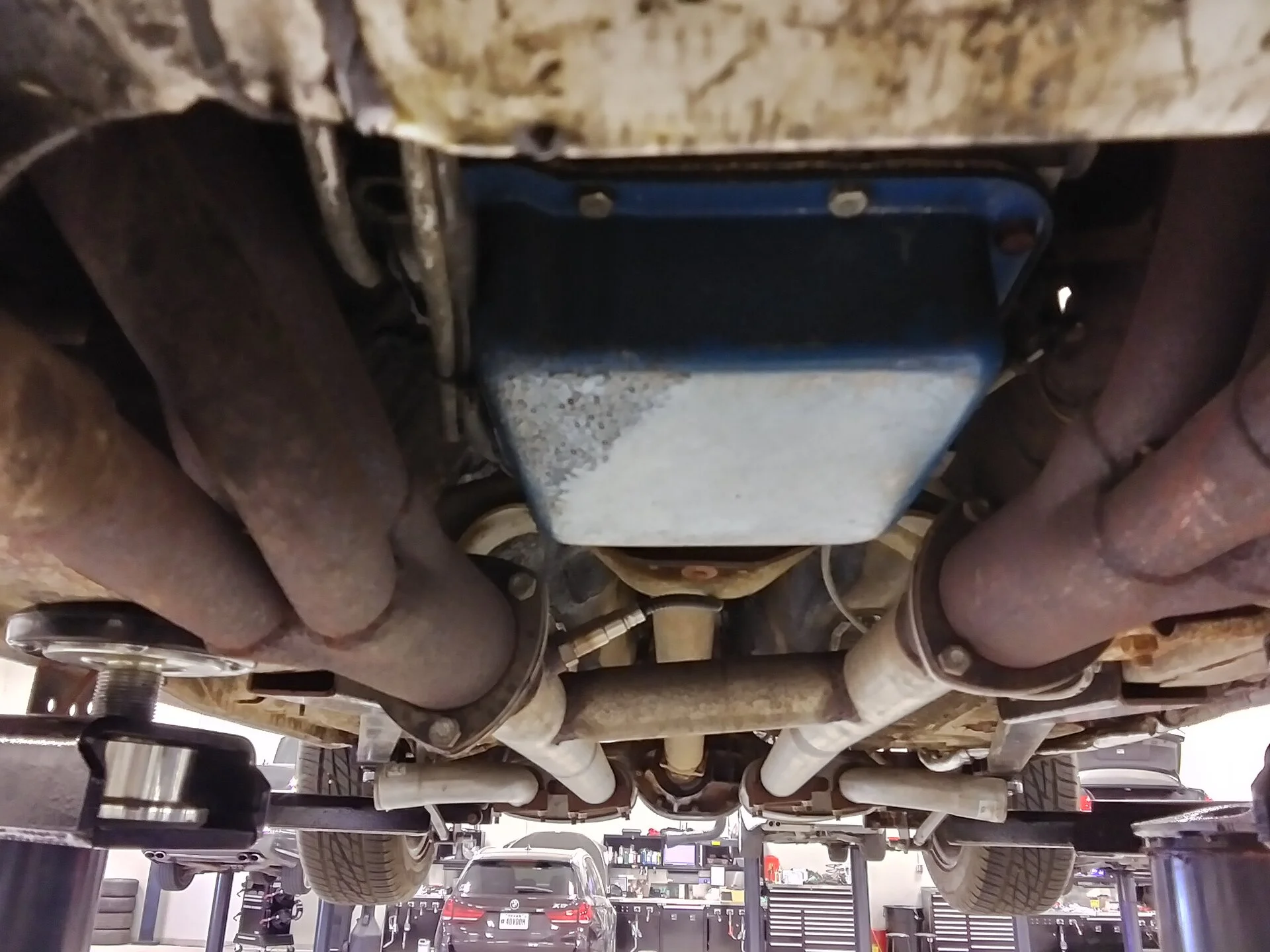

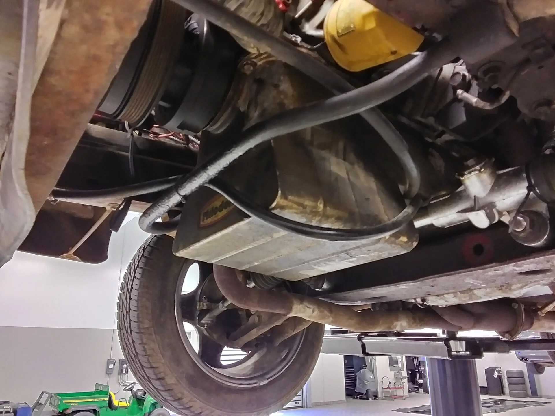

The next two are showing off my exhaust setup for @LILCBRA
Wouldn't you know? The crankshaft seal is dripping again. I mean, it could be worse, it could be the rear main, but I replaced that seal all of three years ago before I parked the damned thing, and it's the type that's driven-in from the inside, so that means tearing down the front of the engine AGAIN! I'm sorely tempted to see if I can't yank the engine on a Saturday at the shop, clean it real well, replace the oil pan gasket, timing set, and paint it before dropping it back in. That'd be a couple of Saturdays' worth of work, but I don't think my boss would care as long as I got BMWs fixed and made THAT my priority.

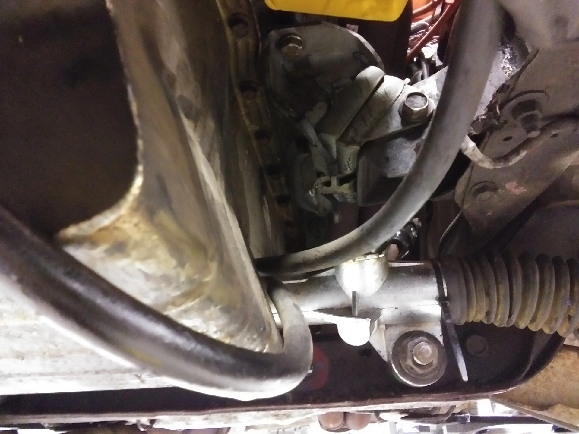

Wow, that's some fancy hose routing, don't let cma see this, it be 'Lucy you gots sum splain'n to do'.
The transmission cooler hoses were routed differently before the manual rack install. Now they're routed in the position known as "it ain't hurtin nothin so I don't give a damn right now".
The fuel hose... well... that's on the list of reasons I don't like the Mostly Starts Dammit Catatonic EFI. You have to run rubber hose with it due to cavitation concerns apparently. The day that $2100 mistake is off the car will be a very good day.
View: https://www.youtube.com/watch?v=-t3G1uvnzfA
For the record though, the fuel hose's only questionable routing point is that bend against the left rear bump-stop. There's just not enough room up there to get the hose away from it without wholesale re-routing and re-wiring, which, I'm actively trying to avoid while I weigh my options. (If this damned pandemic would shove off and the economy would stabilize it'd be easier to figure out the next step.) From that point forward, the hose is tied to the factory fuel line or brake lines, and is even wrapped in insulation where it passes above the exhaust and subframe connector. Once it gets to the firewall, it is tucked tight to the underside of the car, and passes through a body plug below the master cylinder (with a grommet around it) before it snakes along the firewall to the throttle body.
See here: https://stangnet.com/mustang-forums...ts.894996/page-19#lg=attachment651138&slide=0
Those transmission cooler hoses though? Yeah, they're sloppy and laying on the sway bar right now. :D
