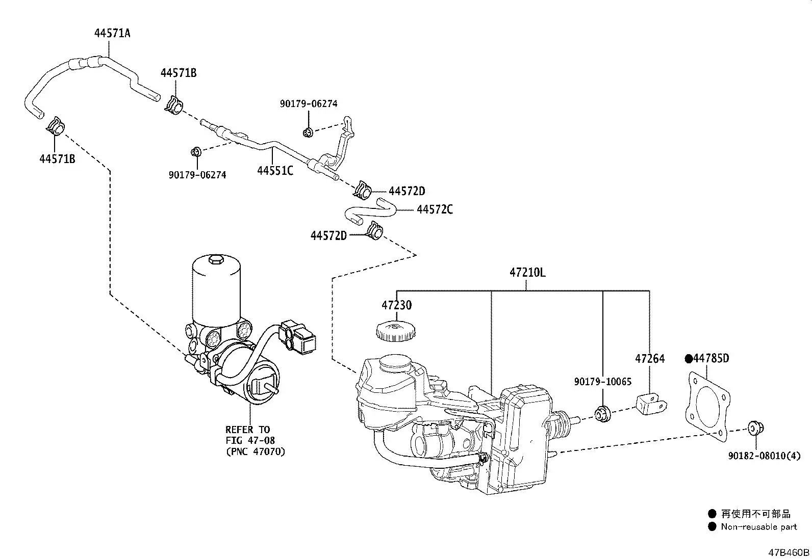

The top 2/3 of the picture is what all is included in the Prius booster/master assembly I bought. I need to look at the electrical side of things too, so I can see just what connections I do and don't need to make. I know this unit's controller has a fail-safe mode to provide a certain amount of assist, just like the electric power steering in the Prius (in fact, that's how Mike and so many others use that system, by intentionally putting it into fail-safe mode so that it can run without using CAN-BUS data from other systems), and that may be adequate (or more than), but there's also the remote possibility of getting it to work at full power if I can figure out what I need to do to convince it that it is in a Prius with no faults.

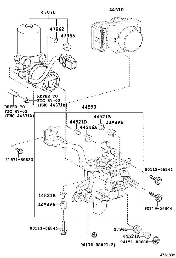

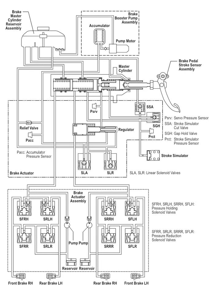

(Just stashing these here for future reference... more or less...)

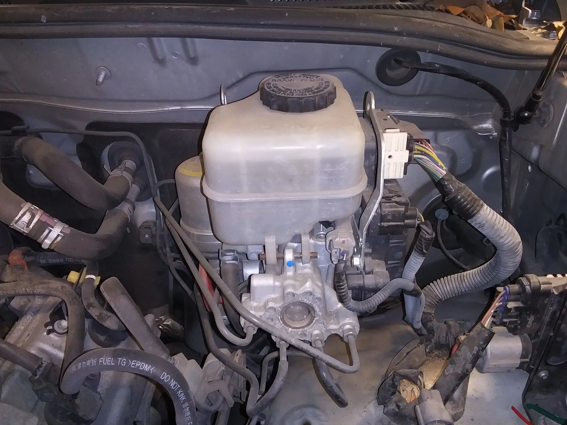

That's okay, until I opened the hood on the 4Runner today out of boredom at work it never occured to me that my 4Runner uses an electric brake booster. The Prius unit is much narrower (and much longer, but that shouldn't be a big issue). It showed up today, it looks good, I'm going to take it to the shop tomorrow and look up wiring and pinout info on Alldata to see if I can't figure out what makes that little monster tick.
My EGR b-off plate for the Lincoln intake also arrived today, I sent a PM to Mike about those injectors he's had for sale in the classifieds, waiting to hear back, and I have a junkyard trip planned for a list of parts including the valve covers, COPs, oil pan and pickup tube, alternator, and more.

Scare me with that pic why don't ya. First thought was that ain't gonna fit. Glad to read further and see it's not the Prius one. Also happy to see they are doing the same basic design on other models. Implies it's more mainstream than I thought.
I like the 4Runner unit more, because it incorporates the ABS, booster, and master all into one compact and robust assembly, but the Prius one should be better for retrofitting into the II precisely because it omits the ABS.

Back to square one on brakes.
I talked to a Toyota master tech friend of mine for a bit today about the crazy idea of using the Prius master. He was able to explain why it wouldn't work.
