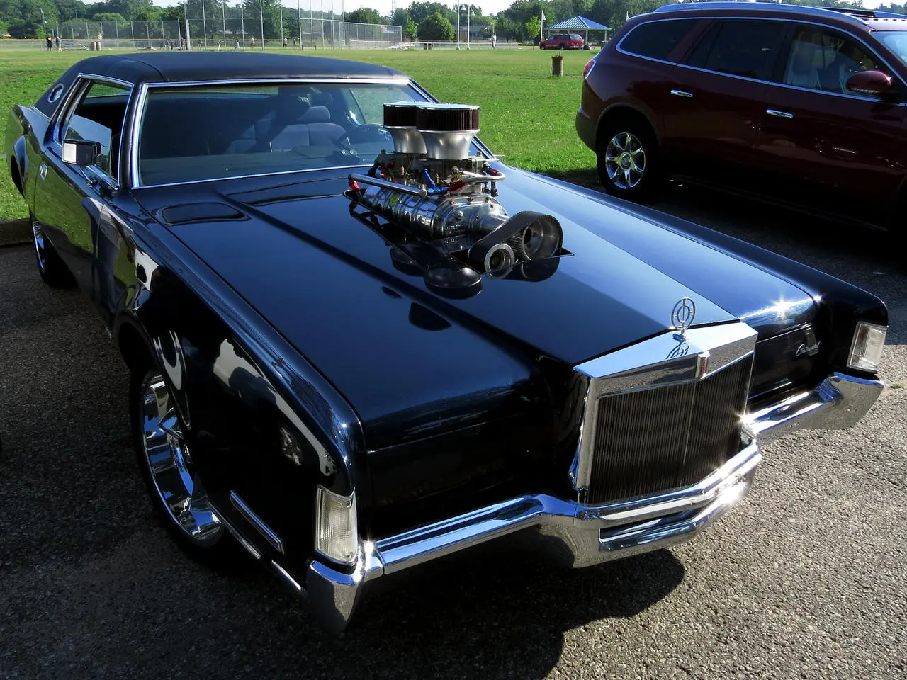

Got me thinking of my old truck..... This is pretty much exactly what it was. Mine had the steel wheels with trim rings and was a solid, dark metallic brown. Loved that truck.....

I had an 86’ with that same stripe package-mine was the dark maroon- Ran like a top- Smoked like a freight train

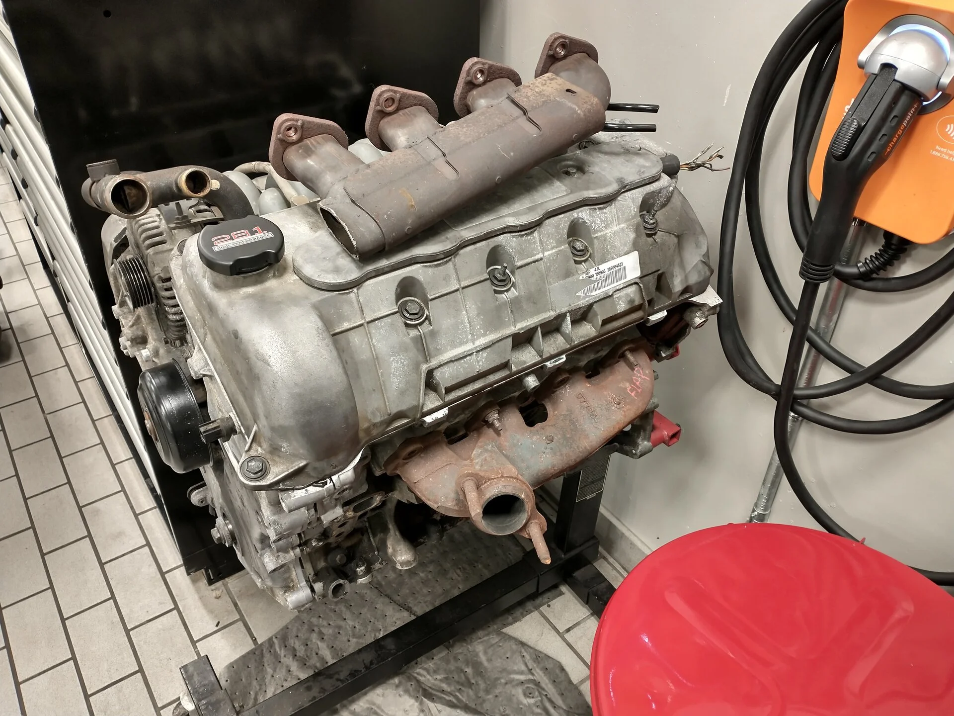

It's super-slow in the shop today, so I decided to mock up the 4.6 with all its new junkyard-fresh parts... even with everything wearing a "patina" it's starting to really look like something.

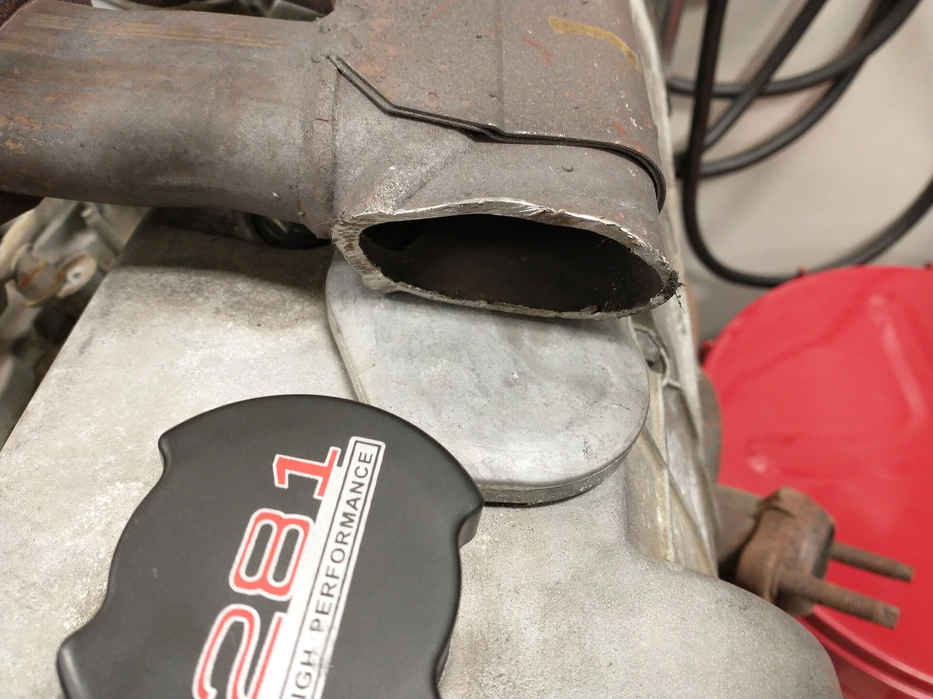

Sometimes Ford is a little... special.
You see, on the 4.6 DOHC in the Mark VIII, one of the exhaust manifolds incorporates about a foot of pipe and the catalytic converter all as one piece like so:
This means every salvage yard out there cuts the converter off, leaving you with a manifold that looks like the one laying on the valve cover here:
Well, not wanting to beat a piece of pipe into the right shape to match that odd end, and wanting a flange to bolt new pipe to for routing to the turbo, I did a bit of research and discovered that the 4.6 DOHC in the Continental (which is front-wheel-drive) used a cast iron manifold that hugs tight to the block and has a turnout that, while not perfect, will work for my purposes. I found one for the cheap-enough sum of $40 on Ebay, and ordered it.

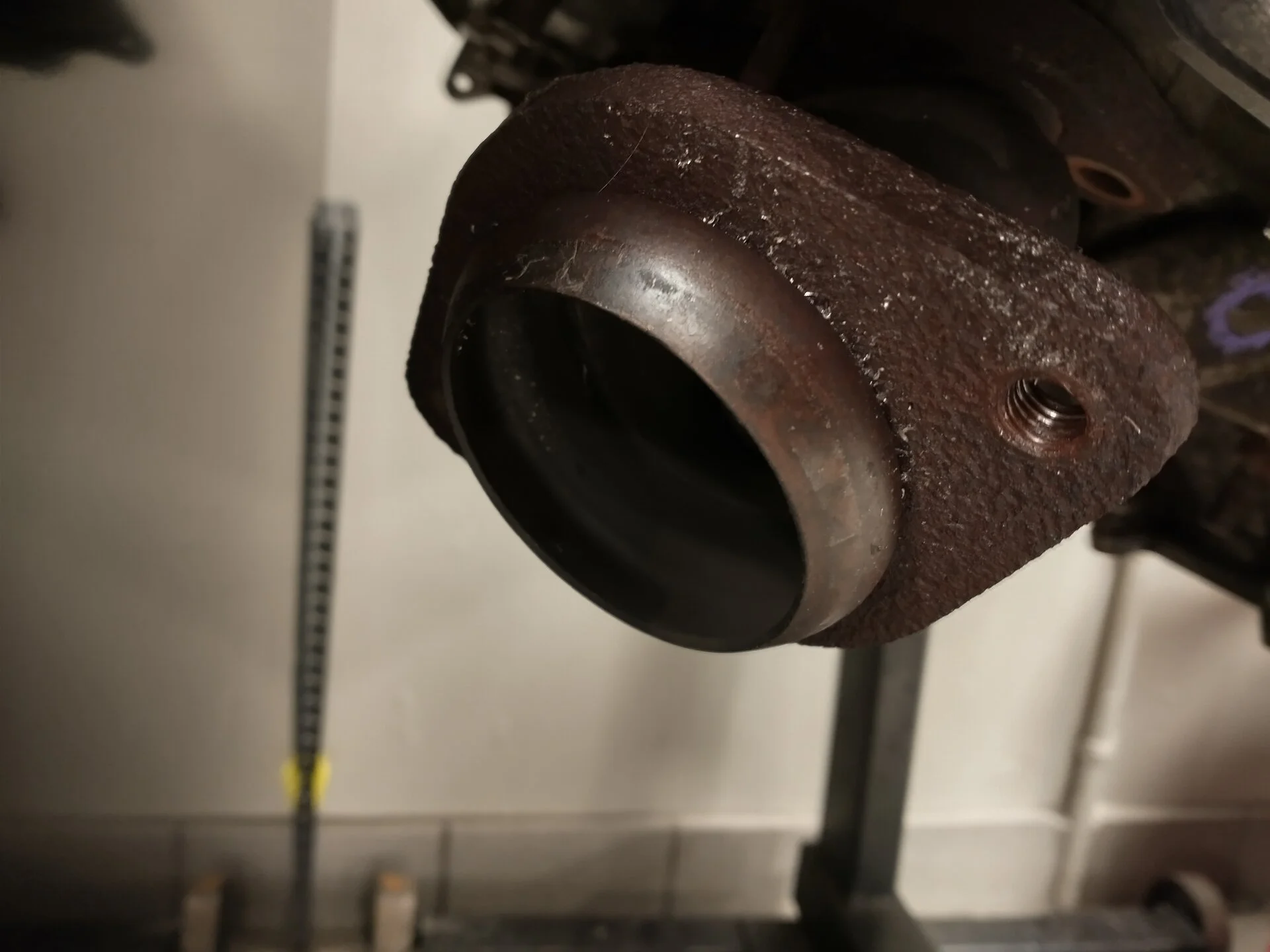

When it got here, there was a problem. It has a 2" exit.

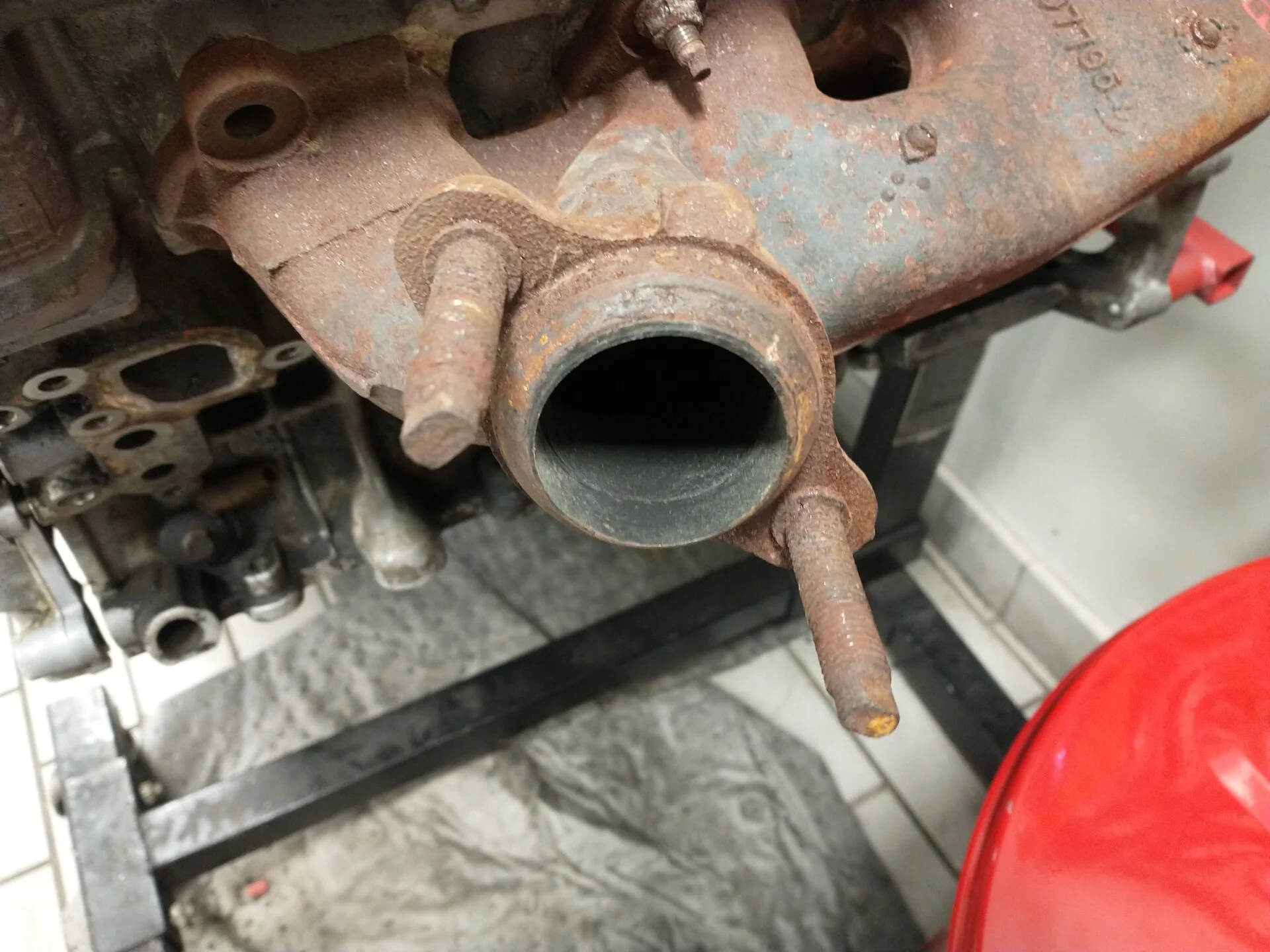

This is opposed to the exit on the other manifold, which is 2.5" at the flange:
I think I'm going to take both off and measure them internally as best I can and see if the tubular manifold on the passenger side is really going to be that much less restrictive, and if I could possibly port the iron manifold to bring it closer. I plan on mounting the turbo on the passenger side, so maybe this will work out somehow. I don't know at this point... maybe I'll say screw the turbo, put the big Sullivan high-rise manifold on it with a carb, and make it look like an old-school big block in spite of its tiny internal displacement. It'll make all of the power of the current 302, but look and sound a lot better doing it.
Nah. I want that 500 or so horsepower... I've been playing with the idea of rear-mounting the turbo STS-style, it's not like there's not a lot of room right by the gas tank (there would be a heat shield) or where one of the mufflers currently resides, and it'd actually simplify everything but the oil plumbing (it'd need an electric pump to send the oil back to the oil pan).

I think you are on the right way to measure/compare the cross-section of the manifolds. It doesn't need to be that bad if they are just a bit smaller. I also would compare it to the cross-section of the turbo flange.
Is there a big diffrence in HP numbers of the the two engines where the manifold comes from? If there is no diffrence, I think it is a sign - beside comparison of the cross-section - that you can use both.
I like the last monifold more, because it looks much more beefy...

There was 20 horsepower difference in power output between the two versions of the engine, with slight differences between the intake manifolds in addition to the different exhaust manifolds. Maybe it won't matter.

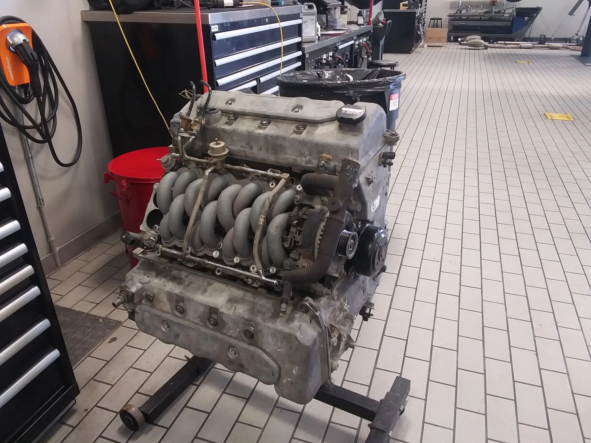

So... let's see what I have...
Lincoln Mark VIII long block, wiring harness and various other pieces
Lincoln Continental fuel rails, exhaust manifold, alternator, and coolant crossover
Lincoln Town Car ignition module
Lincoln Aviator valvecovers and coils
Still need a Lincoln Continental oil pan and pickup tube.

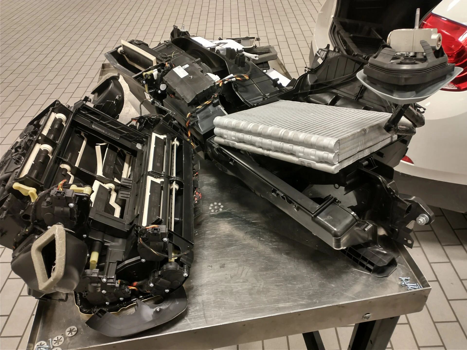

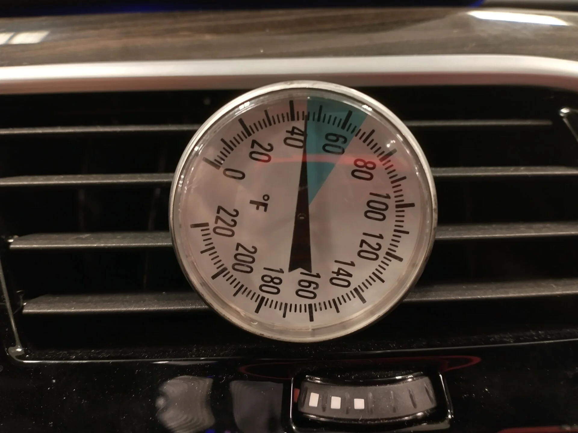

When I say 1234yf cools, I mean it COOLS! This is at idle, not moving, in a heated shop almost immediately after startup. I've had 1234yf systems dip into the 30s on a 100 degree day with the car moving.
Too bad about all that other stuff.

Meat locker temps,Right on!
