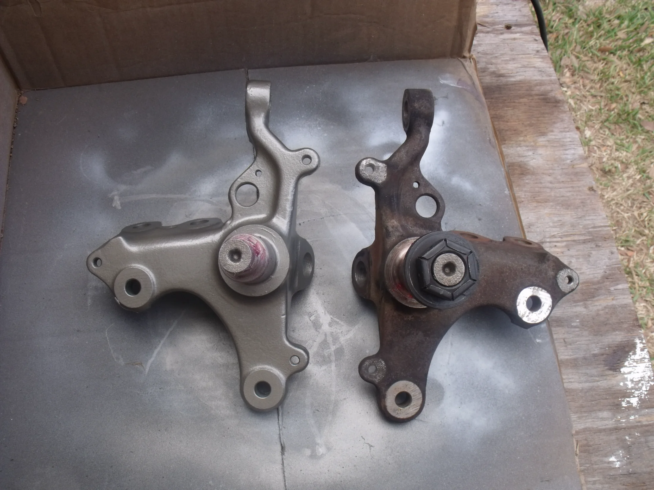

Finding the 94/95 spindles is the hard part... Everything else is a click away.....
