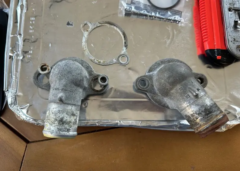

Do you have a picture of the thermostat housing area, as well as a pic of the housing itself, as there was a 99-00 version and a 01-04 version.
99-00 left, 01-04 right
With regards to the OE intakes there is no spacer. O-ring drops in the housing has a taper that compresses it. The Dorman intake does use a spacer, at least the old versions do. that's in my pic at the top center.
