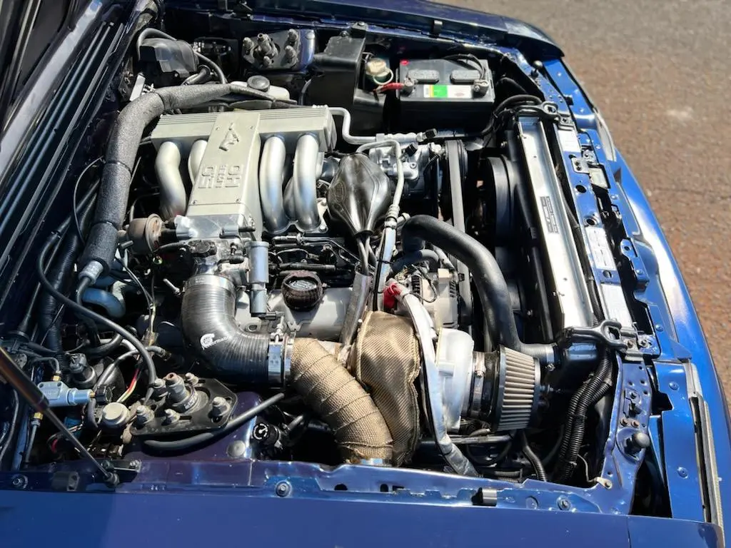

I have an on3 turbo in my 93 with power steering and AC with ZERO fitment issues. I didnt have to modify anything at all to do with PS or AC.
