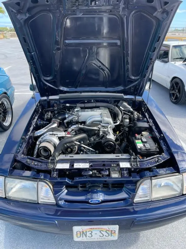

I'm running on3 and have had the kit for a few years. It's worked well for me. I haven't had any issues other than a couple minor things during install. The original PS pump wasn't in the way but made it harder to get to the oil filter.

The problem with the on3 kit is it puts the alternator right up against the turbo,which in turn makes you want to look for a different spot for it. The PS location. Unfortunately,you cant drop the PS down because of the forward facing headers. The Volvo ps pump is the best way to rectify the situation. Hopefully it's on my winter mod list.
The alternator is close to the turbo for sure, but with the turbo blanket it's not an issue. I'm not sure what you mean about drop the PS down? It fits fine with the forward facing headers.
The on3 install was not bad at all. Actually, pretty straight forward. The hardest part was tapping the oil pan for the return line.

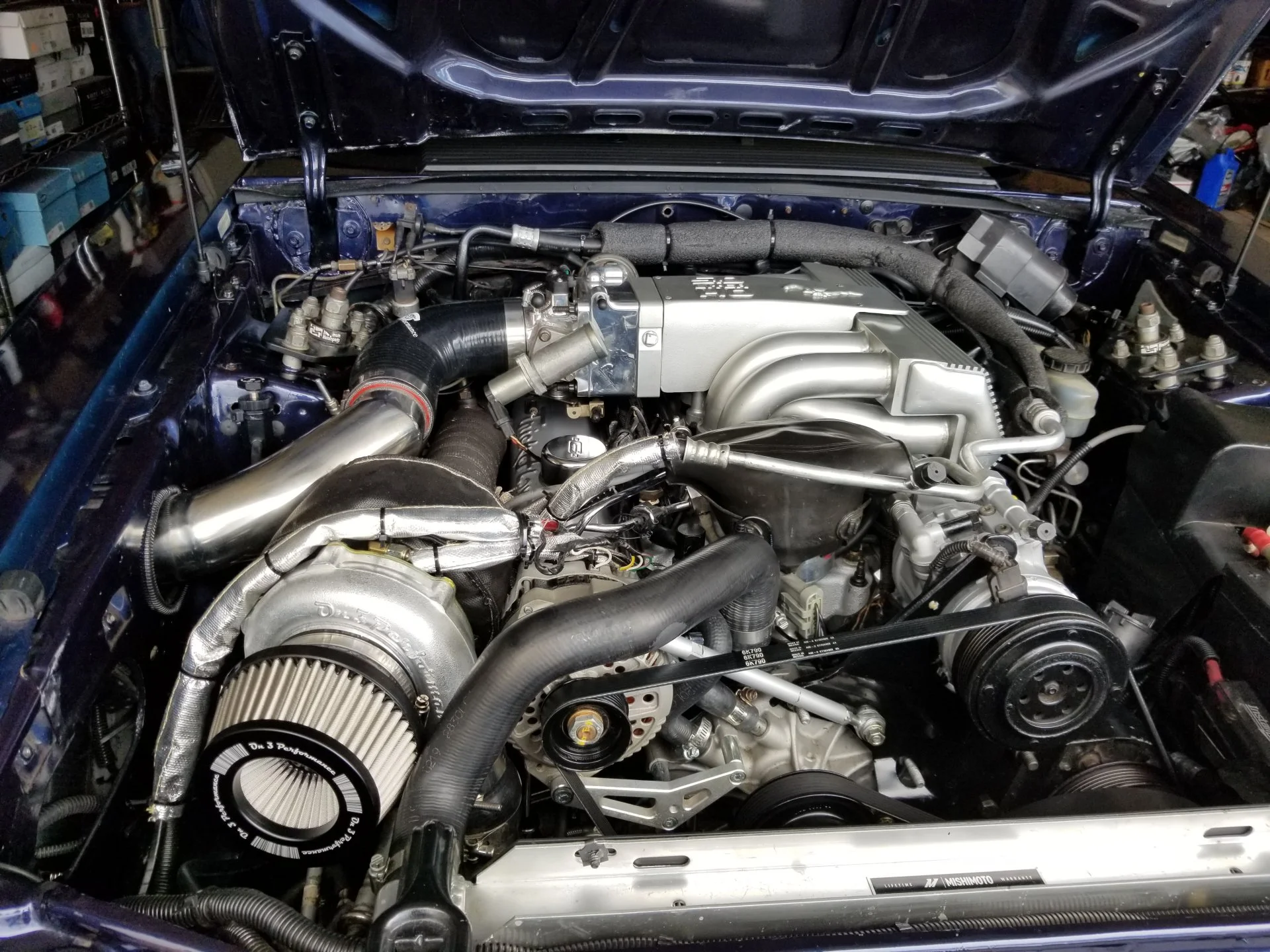

Hey, I used a new pump, bracket, pulley and asociated parts from a company called wild horses.
It now handles and performs amazingly and was much easier for me to figure out than the Volvo pump.
This is on my turbo street car with a spool and 15” wide tires and I retained my AC which was a must for me.
