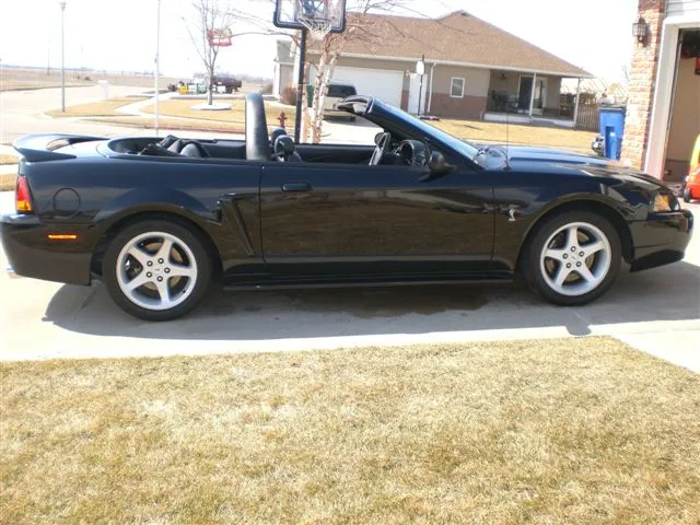

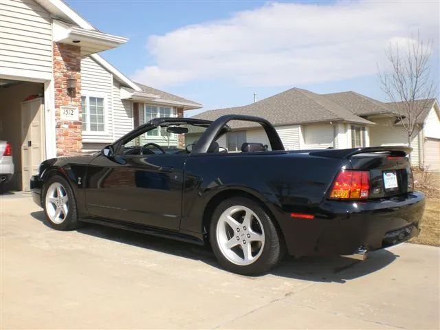

This is my ride with 3/4 rear and 1/2 front...could have gone a bit lower in the front

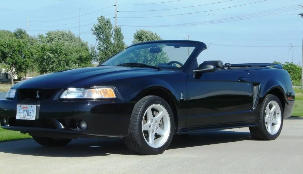

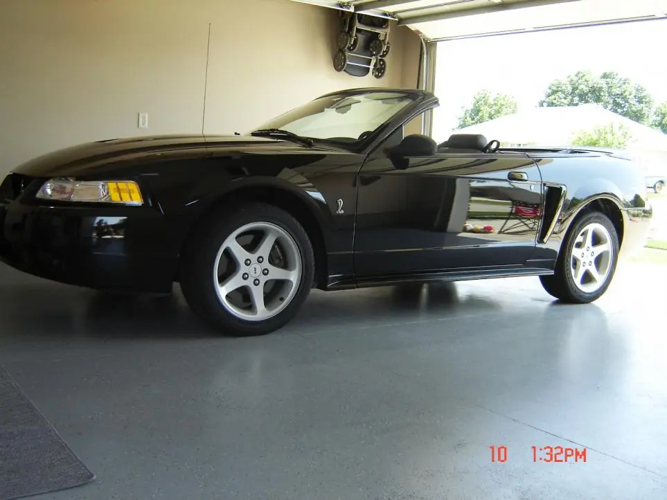

I cut mine. It is nice to lower it as much as you want. Still thinking about more in the front yet. Waiting on new wheels first though.

i am not sure. i know i started at a 1/2 but kept cutting little more and more till i liked it. i bet it was around 3/4 in the front and 1/2 in the rear. Doesn't take long to replace them after you do it a few times. Cut little by little so not to take too much.
