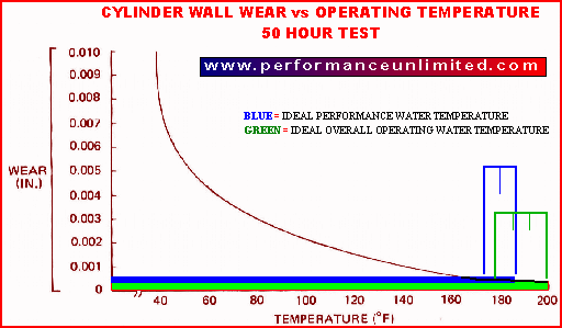

Sorry dude, I really don't like poking at people, but WTF is too cold?? Doesn't a cooler engine make more power? I'veresearched this and people who KNOW, try not to run their car as cold as reasonable, preferably between 110*-120* at the track. A dyno pull will tell you exactly what temp to run.
Isn't cold better when it comes to running an engine? I will agree that it will run richer but it will allow a more 'aggressive' tune. It will allow more fuel and colder temperature which translates to more power. The optimum for longevity and performance is 180* but the optimum for performance without suffering too much from longevity is 160*. A 160* will give you more performance but you will lose a couple of MPGs. IMO, run it and get all you can from your car. I've talked about this with an expert so I know this is accurate, JOEL5.0.
Not necessarily for fuel injection believe me I know guys that do tunning for a living on carb and fuel injection the most optimal temp for making power is around 170-180 degrees on fuel injection thats when the engine is at the right temp especially for fuel injection.This is CORRECT for carb engines why do you think guys like to run carb engines and make them run as cold as they they will make more power but fuel injection doesnt respond as well when its too cold believe me I tried it with fuel injection and carb engines. As for the thermostat rating the 160 temp thermostat will actually make our cars run hotter when we beat the heck out of it because the coolant isnt in the block long enough to take away the heat from the block to the radiator the 180 temp seems to be the the one our cars like for better cooling.
