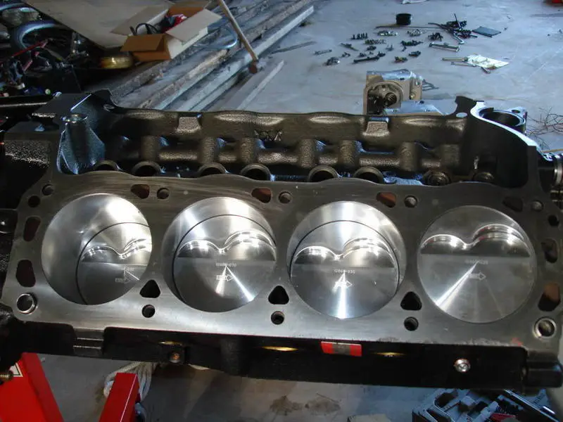

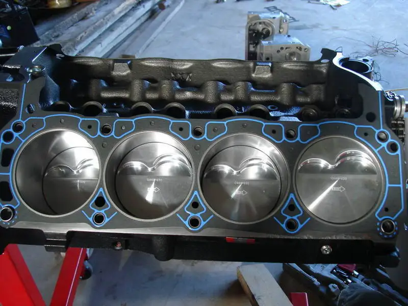

OK, drove out to where my car is being stored right now, to bolt on my twisted wedge heads with the new springs for my new custom cam, woo.
THEN, i notice i left my torque wrench sitting at home.
So, im sitting there staring at the motor and i notice the coolant passages on the gaskets are about as big as a tip of a pencil.
and that the passages on the block and cylinder heads is about 10 times bigger.
Obviously, with the blue rings matching the size of the passages, this was done for a reason. BUT WHY?
I would think youd want maximum flow around this area...:shrug:
Heres some pictures to show my point.
They are Fel-Pro 1011-2 gaskets, listed as the suggested gaskets on trickflows website.
Any reason for this? does it make any sense to anyone?
Derek:shrug:

They restrict flow, so it will circulate through the engine/heads versus taking the least path of resistance. That's also why head gaskets are labeled "front" on them and block the front coolant passages.
Edit: I'm running the same heads and gaskets with absolutely no cooling problems whatsoever. Just make sure you trim the intake gaskets around the water ports if you use the Fel-Pro 1250's.
like it was said earlier. i did a post on this earlier when i was wondering the same thing. the passages need resistence so the coolant doesnt just flow where it wants. basically it forces it where it needs to go, regardless of what the sidenotes of trimming say
