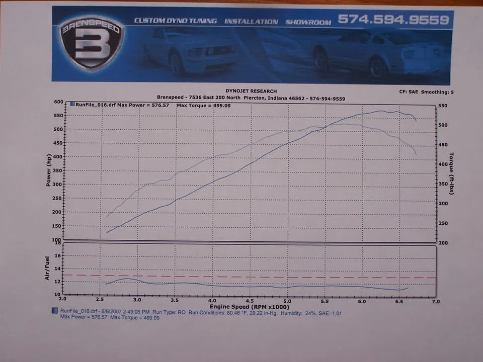

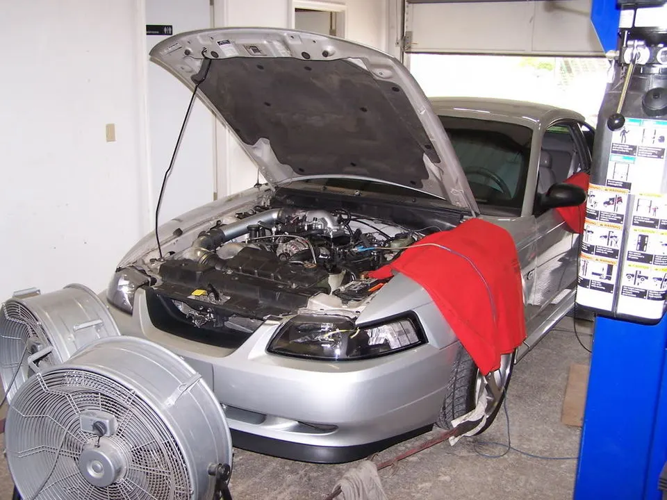

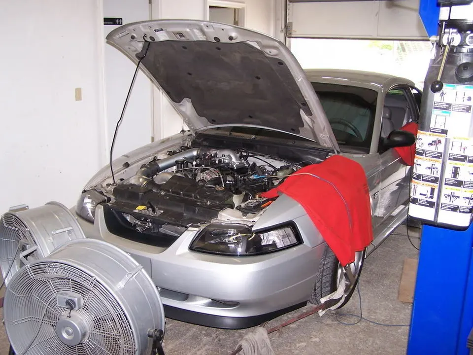

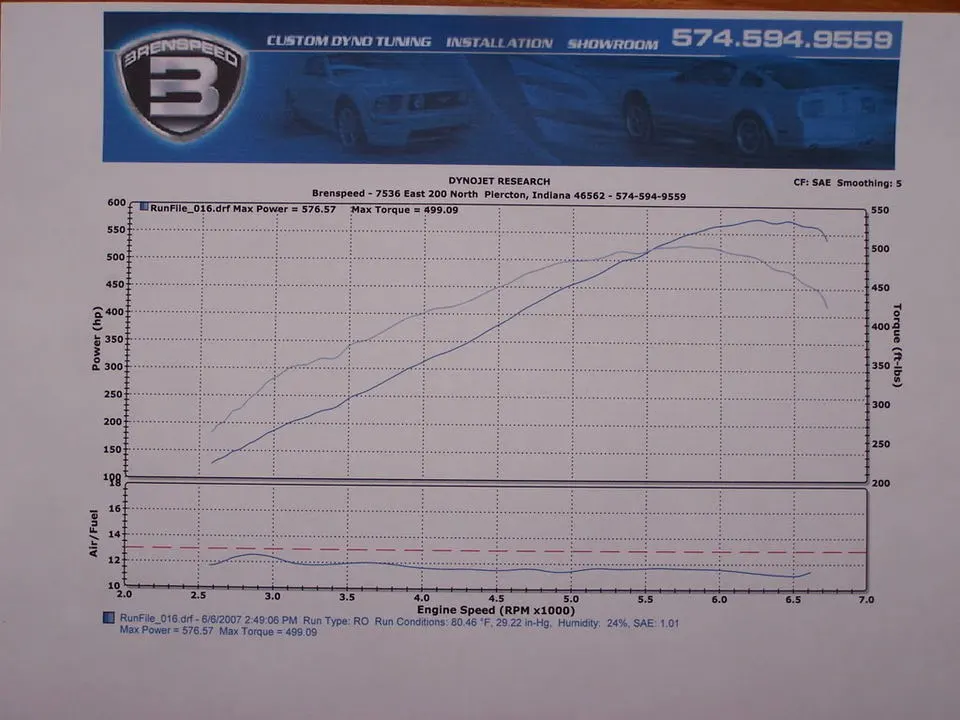

I have a novi 2k as well I put down 576 HP with a bored and stroked 302 forged block.

New dyno numbers will be comming as soon as I get the tranny rebuilt.
I am hoping for close to 700HP, and then I will be done with the engine.

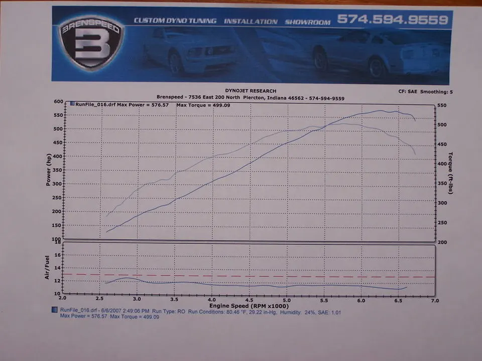

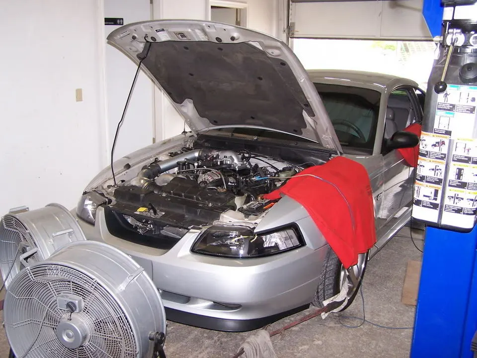

Before I swapped the engine I was using 42# injectors with the stock fuel system. I also used the stock pulley that came with the paxton kit. It put down 389HP. (note- my kit is intercooled)
After I swapped the motor, I just swapped the blower pulley to a 2.9RR 6 rib. I also upgraded my fuel injectors to a 60#, and put in new pumps and the cobra tank. I also got a new clutch. That time it made 576HP. I think it would have done much better had I not had so much belt slip from the 6 rib set up. I was also only making 13#s of boost with this run as well. If I kept the stock displacement of the block the boost would be a lot higher.
I know I have shared these before, but here are the vids I have of the dyno run.
