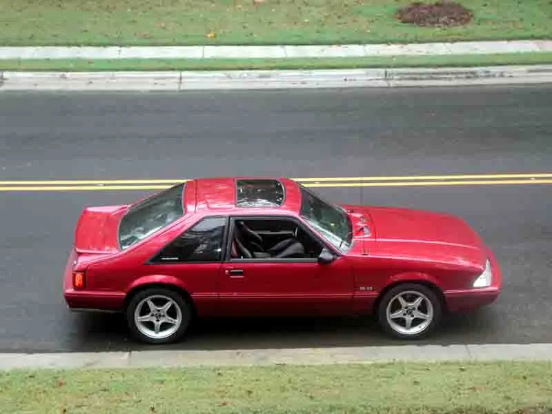

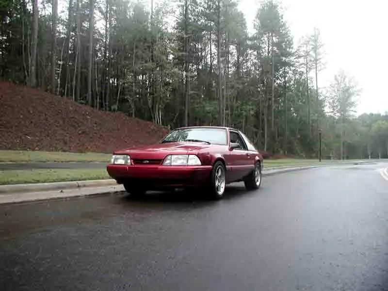

read sig for times with Drag launch set. I cut a coil off of both fronts to lower car a little under stock height. Before I cut the coil the front was about an inch above stock height.
here are some pics of mine, sorry the car is really dirty.
