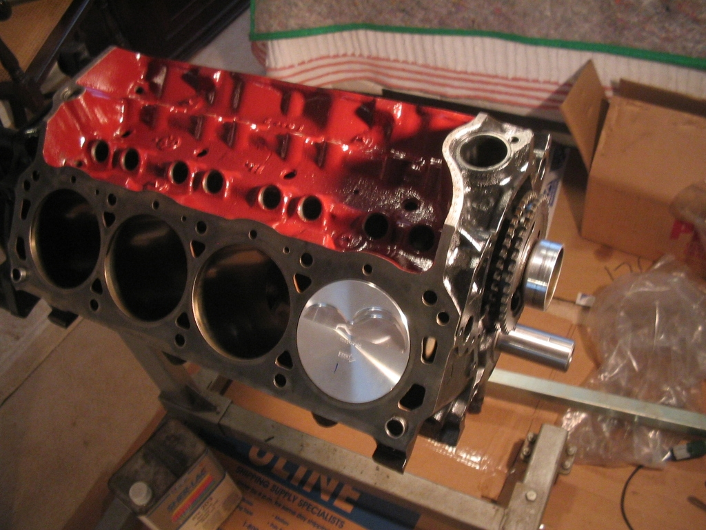

Hi Mate,
Check with Probe. I'm running similar heads and these pistons:
Which similar heads? Those look like a straight cut valve relief? Honestly, the heads are the biggest headache on this process! The ones I bought would be great for a 5.0, up to a decent 347. I really wish I hadn't bought the trick flow because of the piston concerns. Can you run a straight cut valve relief? Sure. Will that take maximum advantage of the twisted wedge design? no...
Hi,
I'm running TFS- 51400002 170 TWs. The concern you need to address with TWs is knowing the intake valve is "twisted", therefore, when running higher lift cams, that second relief step comes more into play. I read somewhere, when running TWs and a cam with a lift at duration exceeding .500 things can get ugly with "straight cut" pistons. My cam's lift is .570/.562, these pistons allow me to run these higher lifts. TWs are very good heads. I would trade pistons before trading heads, if running big lifts, or, lighten up on the cam. Good Luck!
HI,
They are part of their SRS line .Their P/N is 10666 -. 040. However, be aware, the ".040" refers to my over-bore size. Also, you need to know what CH (compression height) dimensions, you may need. These have a CH of 1.175. I'm running a 331 stroker kit. My rods are 5.400s. With these rods, the reduction in my block height (through various decking true-ups), and milling approximately .013" off the top of these pistons, my pistons are out of the hole .005".
So, it's not quite as simple as ordering a set of pistons, except that you want the dual relief valve cuts.
Here's the Summit link:http://www.summitracing.com/parts/PBP-10666-040/?rtype=10
I see where Summit comments "Designed for standard cylinder heads, will not fit Twisted Wedge® cylinder heads." This is not true! I'm running this combo of TFS -TW heads, as I mentioned, with a cam lifts of .570/.562. without any problems. So, I don't know why they make this statement. I'm going to contact them about this statement.
