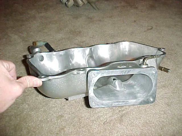

On any website it says that in order to install an accufab oval TB on a 97 cobra you must make minor changes to the intake? Has anyone done this, and can you tell me what they are referring too?
For one, don't waste your money, a TB on an N/A car isn't worth it...The stock one flows plenty...
If you are really wanting to get one though, the modification you need to make is you have to cut out the center section of the throttle body neck between the 2 bores of the stock throttle body are...if you take your throttle body off you'll see what I'm talking about...That center section won't let an oval blade open all the way...When I had my intake done I had the guy cut away that section incase I ever wanted to upgrade to a single blade TB..
Here's a picture of what mine looks like after that center part was cut out...
