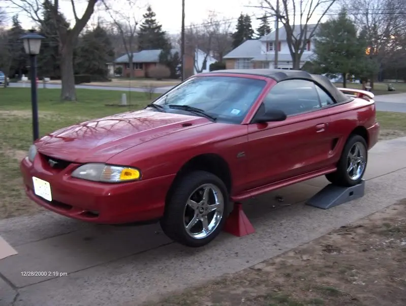

I use the black plastic ramps for the front and then jack up the rear to put the jackstands under the rear axle tubes to level out the car.
Once it is suspended on the ramps and stands I give the car a good shake side to side. It should feel very solid. I don't try to knock the car off the stands but I give it enough effort to move the suspension quite a bit. Safety first! :nice:

I know what you're saying about the jackstands, back when I was green(er) at this it didn't look right to me. One thing my uncle taught me, and you should do it anyway to protect the pavement, is to put inch thick boards (I use plywood squares but same deal) underneath the base of the jackstands. When you jack the car they will visibly sink into the boards. Saves your drive way and provides a tiny bit more peace of mind.
I always jack the front up, put in the jackstands, then jack the back up and place the jacks under the axles like said above, and if I can, I leave the jack in the raised position under the differential anyway.
Just know that people have been doing this basically since cars were invented and unless you're on uneven ground you'll be fine.
