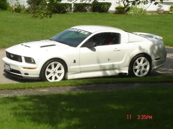

Hey gang, this my custom car that I have built myself over the yrs. I have been running all stock suspension with exeption to 20" rims, 305/35/20 rears and 255/35/20 fronts. It rides beautiful as it is my daily driver and I have put 35k on the clock. I noticed while changing my oil on the lift that the passanger side rear shock had leaked oil. So now I'm in th emarket for a replacement rear. I have lost my job and I'm on a really tight budget. what do you guys recommend for a replacement? my streets aren't smooth (boston roads) and i drive slow in the city untill i let loose in the city highways but I've been good with my stockers until recently. I dont want to go race part since I'm not racing, but I woul dlike a nice option other than an oem replacement.
any advise on this?

all stock springs no aftermarket at all AS AFAR AS SUSPENSION GOES. ONLY WHEELS AND TIRES. the stance was exeptional when i mounted the 20" extereme saleen wheel package.
I may just replace the blown rear shock with a stocker until I make up my mind. as far as handling, my rear rim is a 10" and the fron is a 9" rim..and like I said I'm running 305/35/20's in the rear and 255/35/20s in the front and that combo alone made the car handle 100% better than stock and ride is good stock. my buddy has roush suspension with stock wheels and tires and I kid you not, the sidewall thickness (profile) and with makes a lot of diff already, so I may not want to go stiffer just yet.
hmmm...your car looks pretty damn low. Many non-lowered stangs with 20's look like trucks..from my previous knowledge.

I HEARD IT AND CHECK IT. bingo shock showed signs of leakage. was oily wet . it didn't sag , shocks have nothing to do with a car sagging , the springs do that. The shocks just dampen, and in some cases stiffen, they dont control ride height.
oh and Yes these are the stock springs.
example: stock tire height was only about 3/4 of an inch shorter than my current set up. it may look lower than usual on stock springs due to my side exhaust sideskirts and from lip spoiler.
