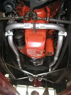

The VT's are last resort. Today we will open H-pipe, and open the holes in the two main tubes (they are very small) in order to increase crossover flow.
I will report how that works.
Another tip we got i n order to reduce drone was to move one of the mufflers a couple of inches forward so that they no longer align.

Report fro mincreasing holes in H-pipe.
We cut off the H-pip (transverse pipe) and inspectes the holes in the main pipe. On the left tube the hole was 1 " diameter, on the other only 1/2 ".
We opened noth holes to match the diameter og the h-tube, and welded back in place. However, it did nothing to the drone, meybe even increased it.
So, I'm back to replacing super-turbos with "drone free" VT's..

Just a note: From what I understand, a cross-over needs to be properly placed to be beneficial. And not doing so may even hurt performance.
I don't see how improper placement could hurt, but it's been established it needs to be as close to the engine as possible. Placed back by the mufflers, it'd be useless.
Fuel-Injected Corvettes have the crosstube wrapped around the engine.
