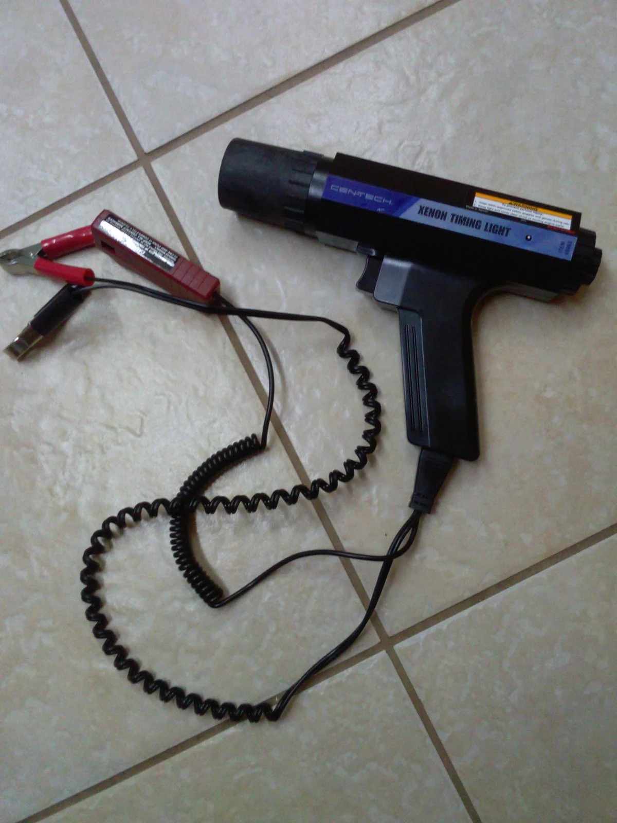

Ok - timing light it is - I did learn how to gauge a 2 degree rotation thanks to you guys !
Hate to say it and sound like an ass but no you didn’t . I literally just timed my engine the other day. A nudge was a 2-6 degree swing . You just don’t know without the light
Reactions: Gs1987GT
When I said I learned how to gauge how much to turn , I was referring that I learned how sensitive the amount of turn should be - before I asked I was thinking 1/2 “ turn , now I realize 1/2” would be closer to 15-20 degrees . And I also learned use the light just to be sure and know exact , not a guess .

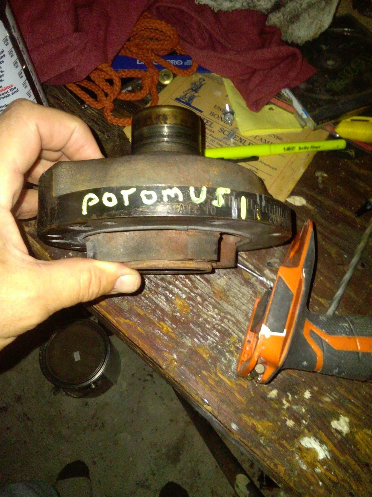

I mark everything else as well. Tip for the future, use Wite-Out. I mark everything with that :poo:. Comes with a fine brush in the bottle, highly visible, and dries quickly.
Kurt
That's what I use, Wite-Out. Doesn't make a super fine line, but it's wide enough so you can see it. It doesn't wash off, will last many years.
Reactions: revhead347
@revhead347 You're right, Kurt. My math was off by a factor of 2. The dizzy spins off of the cam... That's what I get for doing public math when the real takeaway is "don't try it, get a light." Thanks for the catch.
