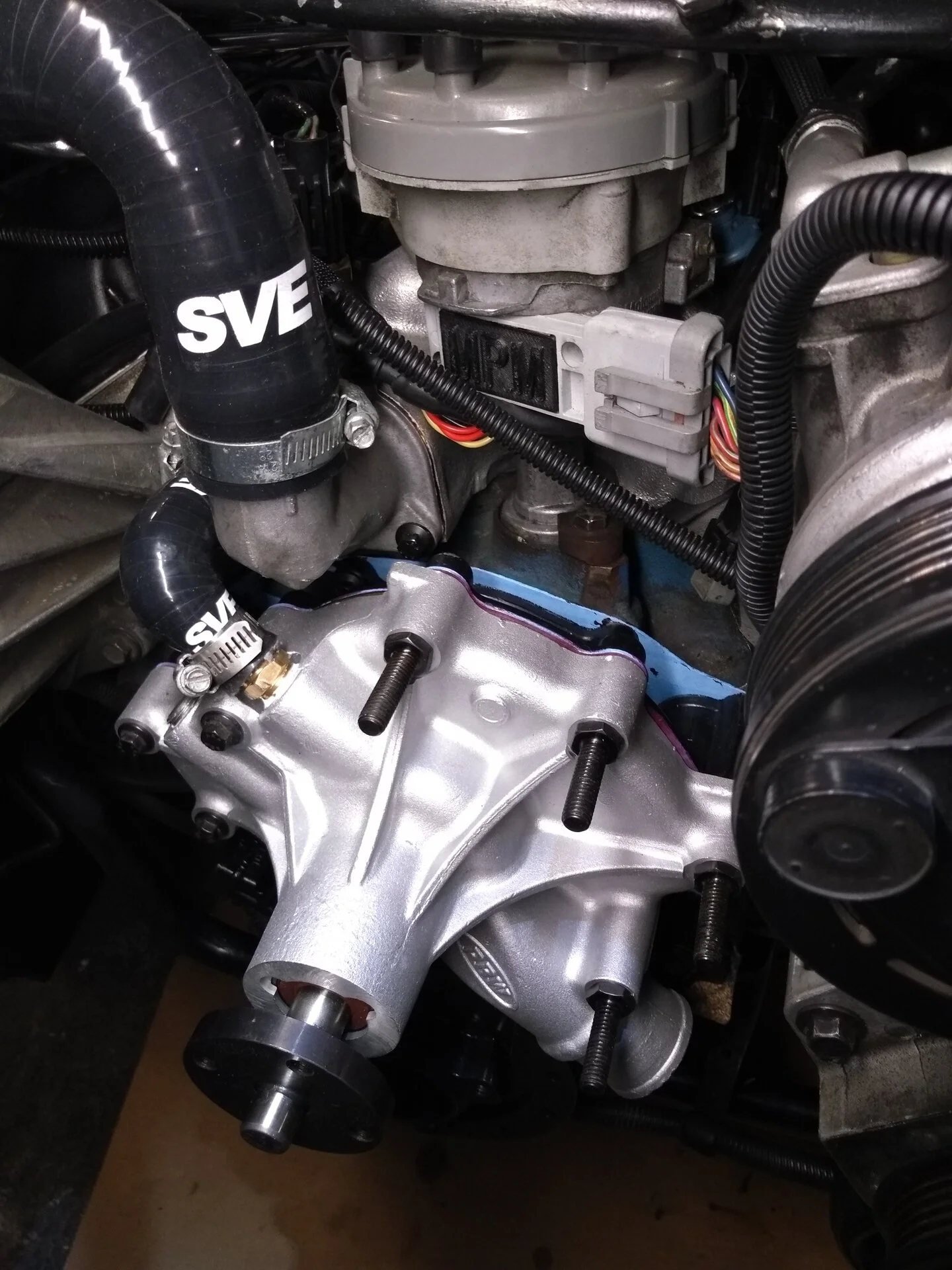

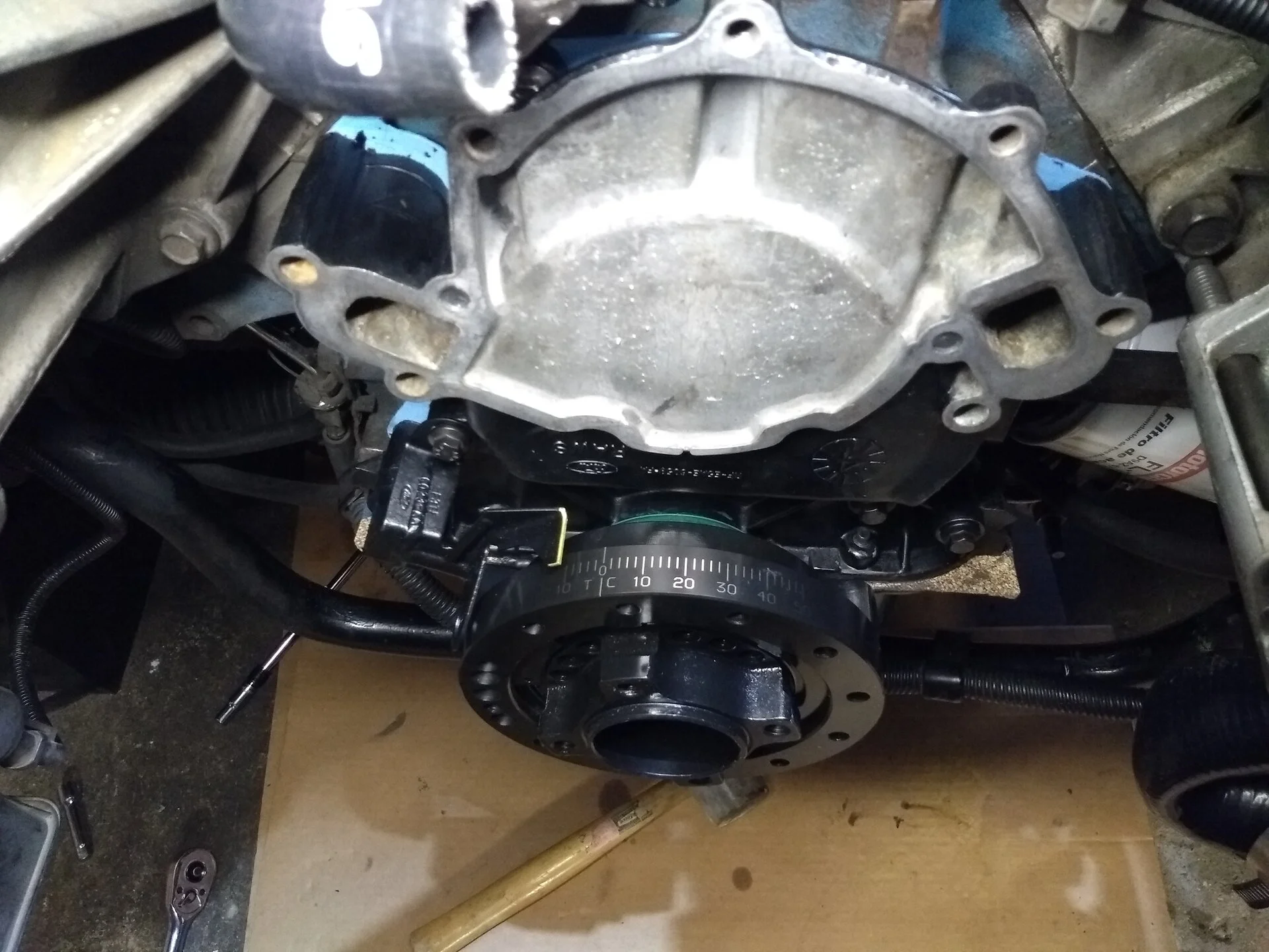

Loosened up the oil pan which worked. I did a couple heat cycles then retorqued the bolts. Haven't driven it much yet, but so far so good.
