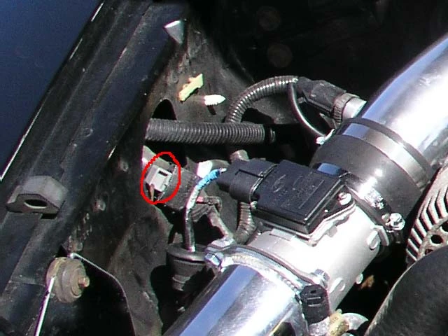

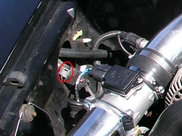

It's a grey plug that is held pretty closely to the hole in the fender. It is towards the front of the car by the passenger strut tower. It is about 3/4" x 1/2" x 1/4".
It's circled in red.
Unplug it, start the car, set timing, shut off car, plug it back in.
