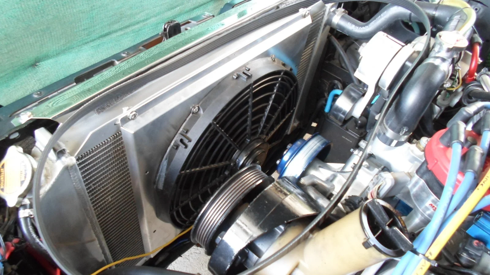

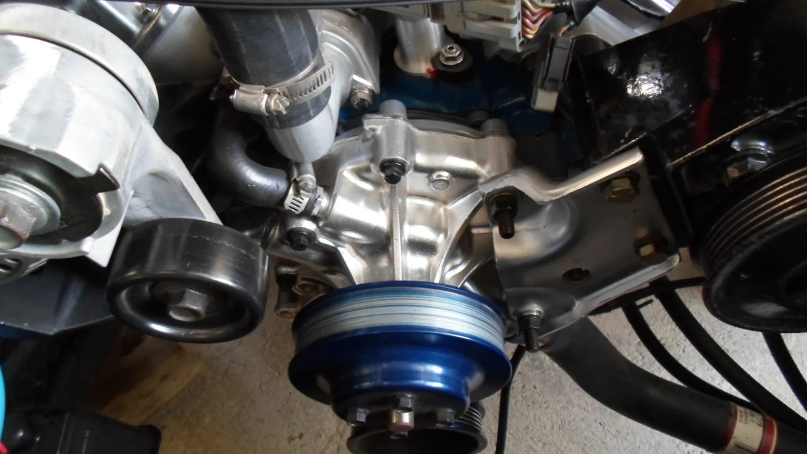

Fan and Radiator just fine..but what about the Waterpump?? stock or some High Volume ?? Counterclock !!I changed my Ford Motorsport Junk Waterpump for a PWR high volume, its just 160$ ..also had the Mishimoto Shroud with twin 12".. no good..changed to 1 16" Fan... now Temp is very stable ..
