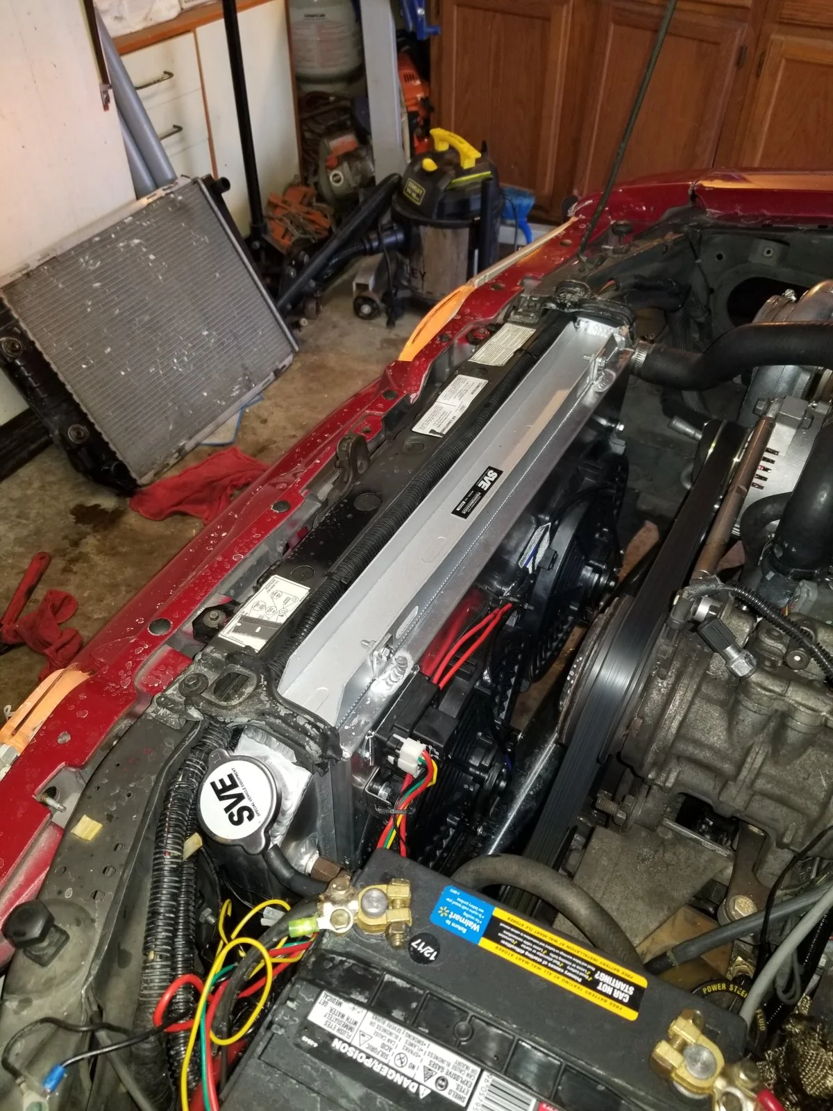

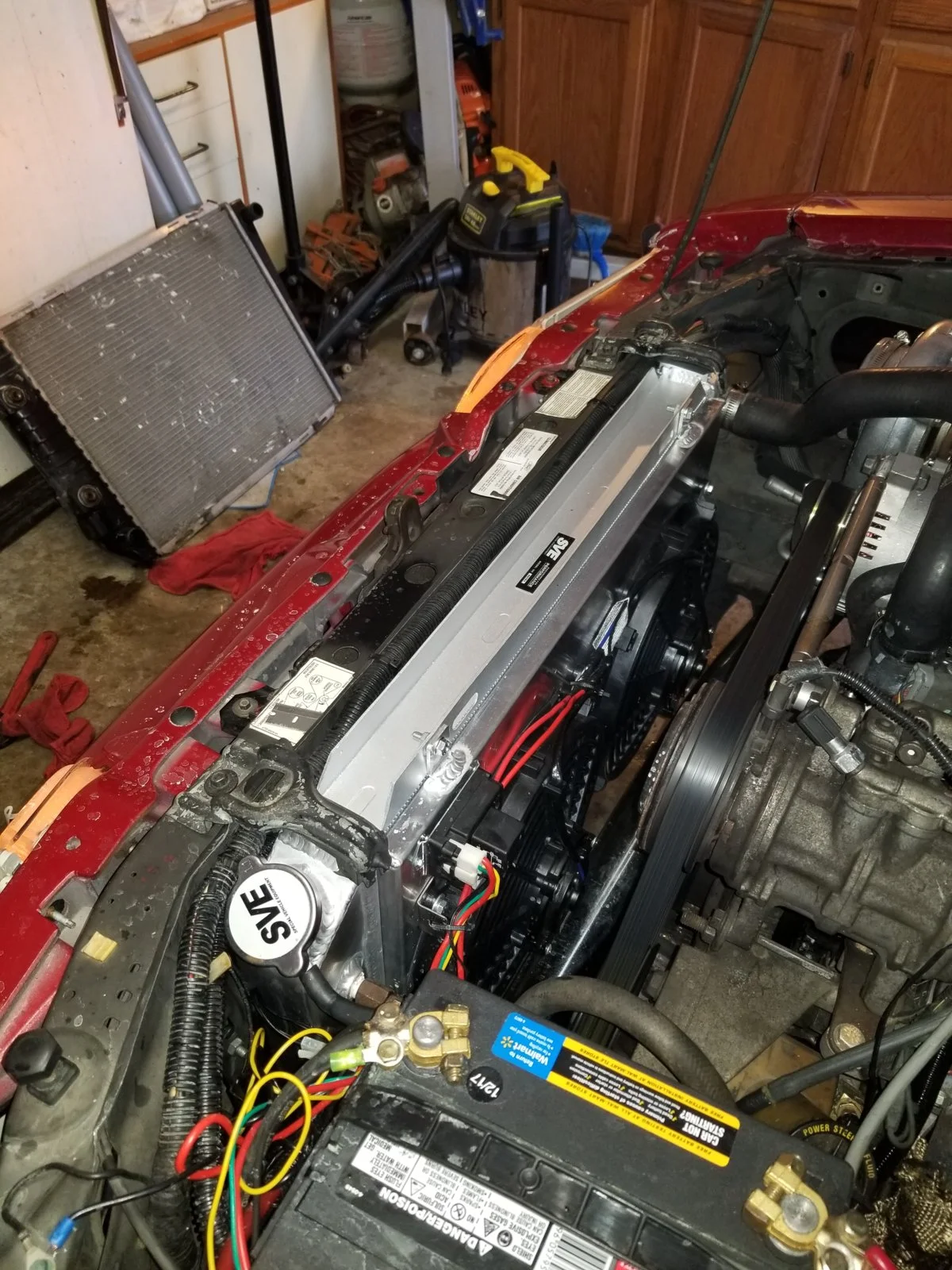

Hopefully some others will chime in, but I think you have the same cheapo fans that come with many of the other Chinese radiator kits. My bet would be that is your problem.
@mikestang63, @TOOLOW91, @CarMichael Angelo, @srtthis and others.
Joe
Even though when I'm doing 60 or more on the high way wouldn't there be enough air coming in to keep it cool under boost? Say with the junk fans? Would I be better of going back to a stock setup or something else?

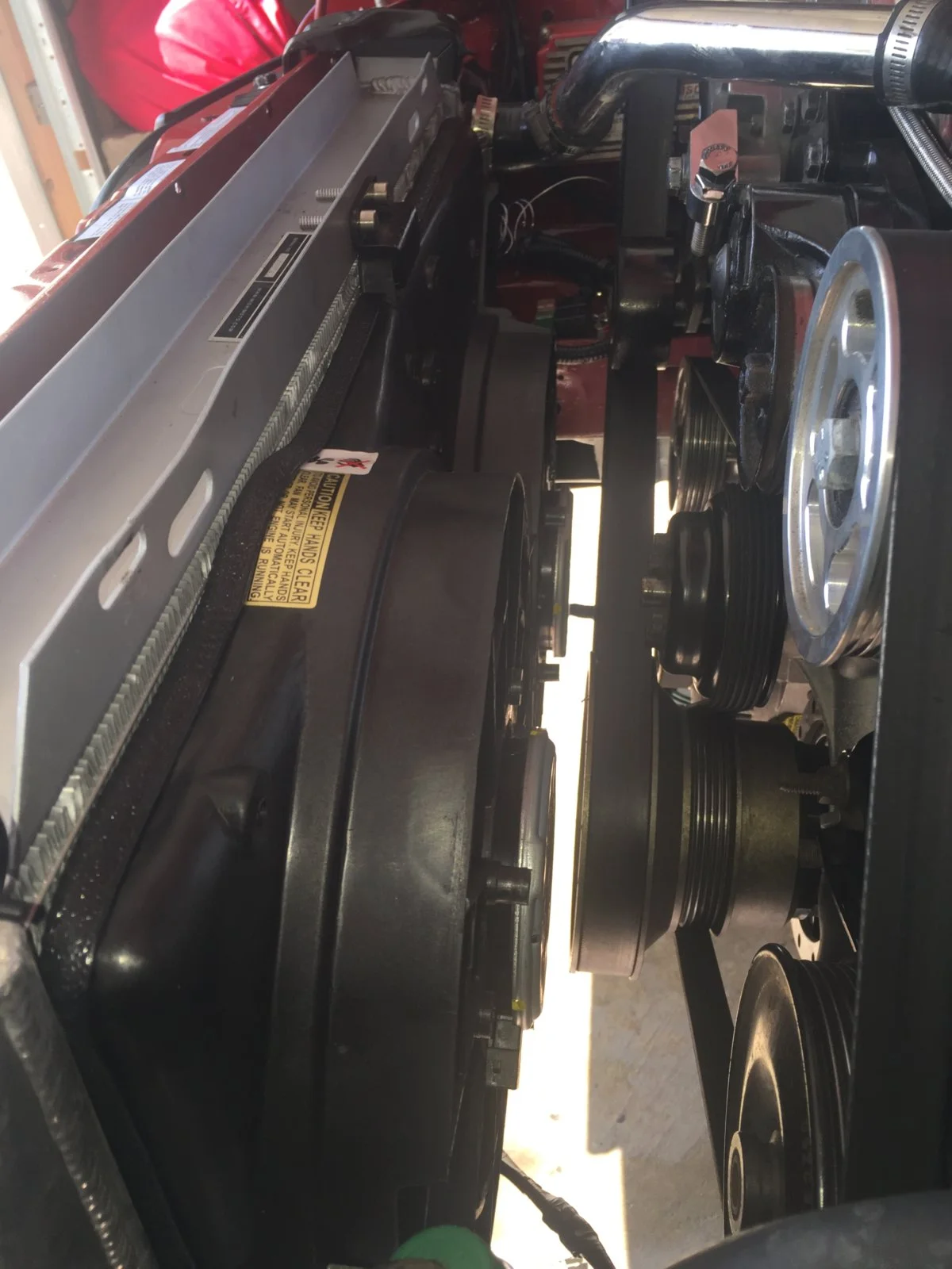

Hopefully some others will chime in with their thoughts. Part of the problem is that the shroud is so shallow that it does not allow adeqaute airflow. Don't go out and buyam anything different just yet, but that is my first guess.
I had a similar setup and ended up swapping to the dual contour fans. They pull a lot of amps but cool great. In fact, a few years back my big 3 core radiator sprung a leak right before a nmra race and I didn't have the money to buy a new one. Instead I bought an $85 stock replacement from advanced auto, swapped over my contour fans and ran the true street event without problem. Still have the stock replacement on the car today.

As for the fans, the 1995-2000 V6 Contours should have the dual fans. I've also read some of the Cougars and Mystiques use the same fan. Got mine for $25 at the local salvage yard. Cools my supercharged 306 just fine.

Yeah I'm going to talk to him tomorrow morning, I will let you guys know what happens with that, thanks for all the help going to get a different fan setup either way, because the ones I have now are on 1866 cfm for both!! Looking for a setup like the contor fans, if you guys know where any are let me know thanks
As jeff said id ditch those fans in favor of a mark 8 fan.
the timing is another issue all together. id call the tuner and see why he did it that way. or id find a new tuner all together.
Lol, oh yeah, we are talking 2500-3500 cfm for the oem style fans.
Joe
You can get brand new dorman replacements from summit for the contours that work well or hit eBay for a used oem set . I’ve used both
