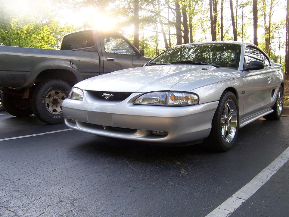

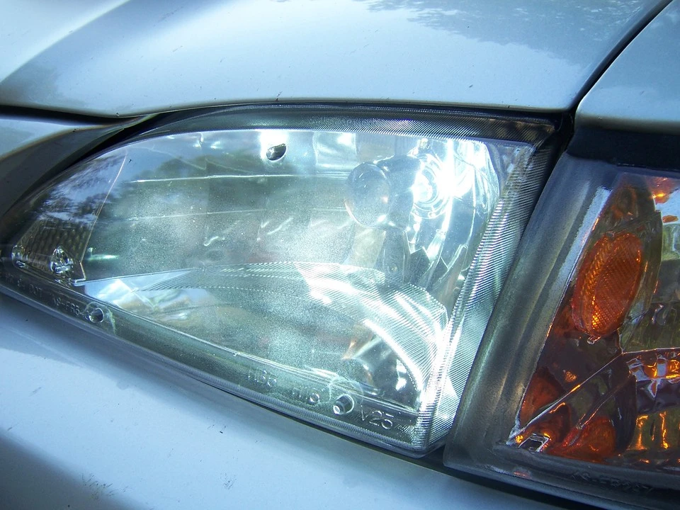

Here's what I started out with:
Notice how the chrome reflectors really pop from the rest of the front of the car? I honestly don't care for that very much; I feel the headlights are what make or break a car, and that they really need to flow with the rest of the front end. In this form, mine really stick out from the rest of the front, and I decided to fix that.

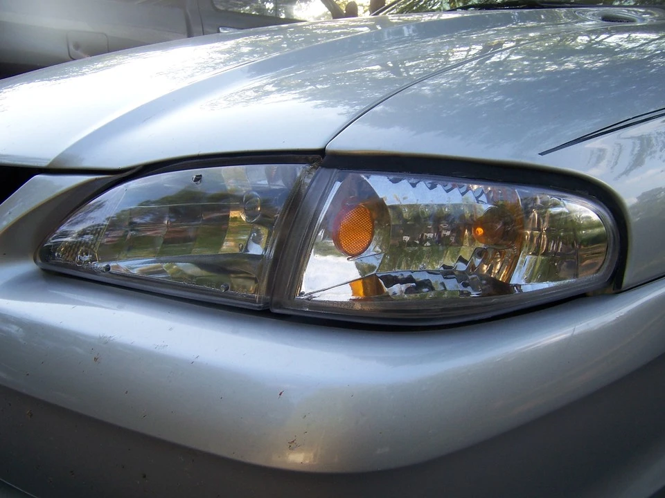

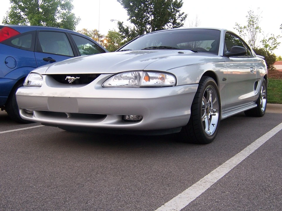

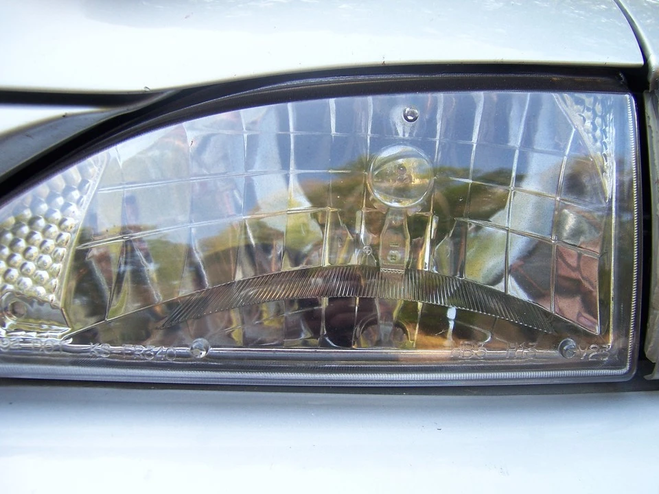

And here's what I ended up with:
All in all, I couldn't have asked for it to turn out any better. The darkness is perfect, in my opinion. The car looks much more aggressive now. I can actually see better at night because the tint has drastically cut down the glare from the HIDs, which has allowed me to point them farther down the road without blinding other drivers. The lenses are as clear as they were from the start, only a darker shade now. You can only see the paint droplets if you look really close. All in all, it's perfect.
Except.......
The lenses look a little cloudy/foggy when the lights are on. I'm not sure why, but I think it's because I've got such a thin coat of the tint on. But, it's really not all that bad. Very few people would even notice it before I pointed it out.
