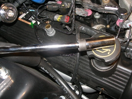

Get one of these spark plug extensions. You don't have to remove the fuel rails.
Definitely! I couldn't tell you how many times I've tried doing plugs without one and the socket kept coming off the extension and falling back in the hole.
pulmeovr said:
Spark plug extensions? Is that just a deep socket?
The spark plug extensions have the spark plug socket (with the rubber ring to hold the plug) locked onto the regular extension, thus avoiding the aforementioned headache. :nice:
Wrap some duct tape around your plug socket and your driver extension. It won't fall off anymore. Use a swivel at the top of the extension for more flexibility. The only hard plug for me is the one closest to the passenger firewall.
