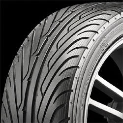

We have 255/40/17 yokohama avs es 100's all the way around and love them. Get them at tire rack for $116 a piece. They last much longer than previous khumos I have owned and are better in the corner and wet. Khumos had better dry traction. I would go with the 40 sidewall on a 255 tire. The 40 is a ration of 40% of the width, it actually within .6 inches in height to the factory goodyears. 25.7 inch diameter for 245/45 goodyears and 25.1 inch diameter for the 255/40 yokohamas. A 255/45 is around 26 inches tall. Having a bit shorter sidewall is better than a bit too big in my opinion. Less sidewall means better handling and its close enough (.6 inch) to not make your wheel wells look too big.
http://www.tirerack.com/tires/tires...rch=false&partnum=54WR7ES100&fromCompare1=yes
