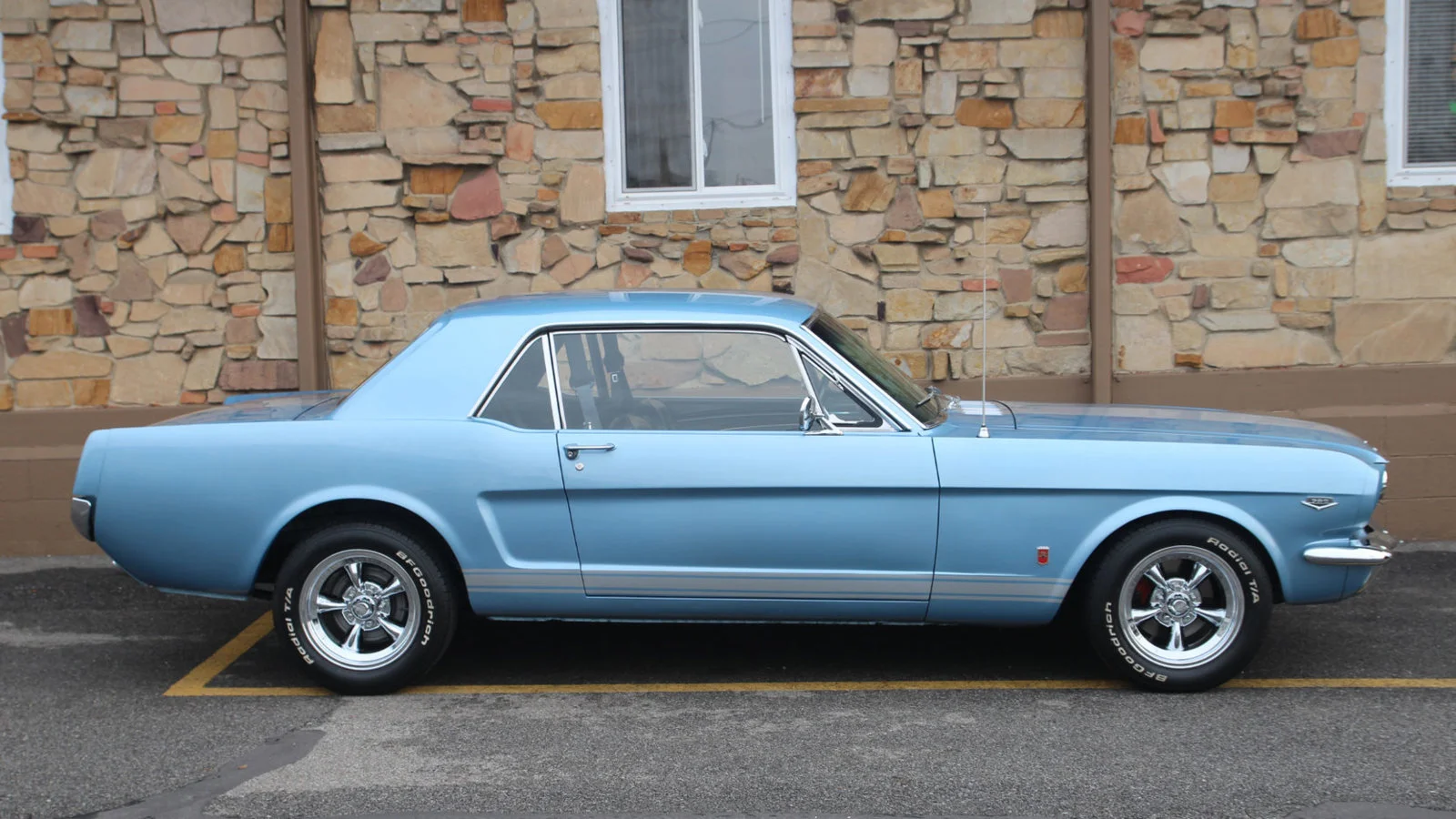

New to this. Have a 1964.5 and would like to put different tires on it. The 14 is so small. Ideas?

Torque Thrust 15x7 inch is in the running for the most famous mustang wheel ever.
Available in larger sizes and polished finishes.

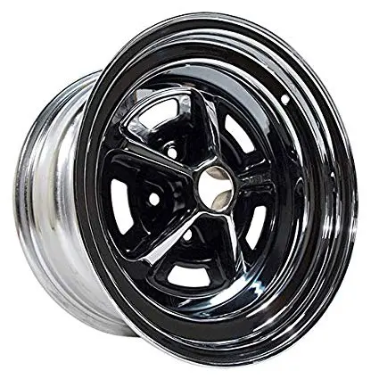

Amazon product ASIN B07MZX6L9VView: https://www.amazon.com/65-73-Ford-Mustang-Magnum-Wheel/dp/B07MZX6L9V

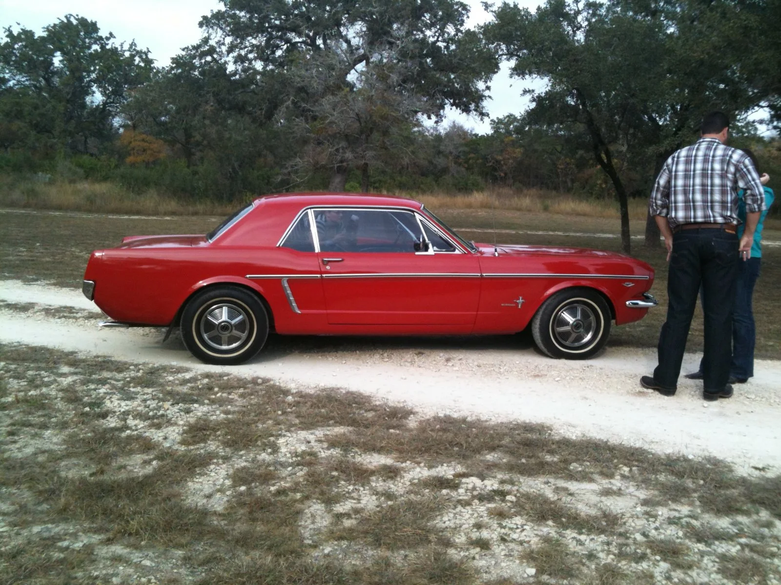

Lucy65 said:
Here’s the pic. And it is 5 lug

Nice1!
it looks good with the hubcaps on it too.

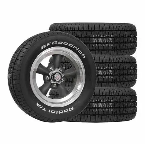

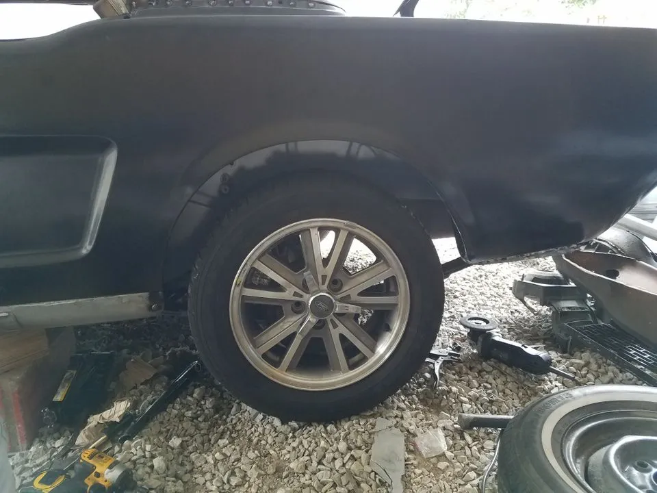

I personally have a set of 05 Mustang v6 wheels going on when it goes back together:
kinda faux-shelby...I think the tires on there now are 215/55/16...but I think I will probably try to fit 225/50/16s
(these require spacers/adapters if running the factory 7" or 8" rear end....if using an 8.8" no spacers needed in back)
