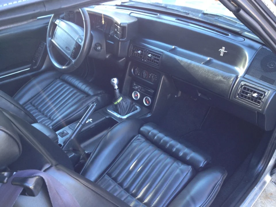

I've used the upholstery. I used the mach-1style in the last project. Changed the front sport seats over to SVO foam, and covered the rear seat to match.
Firstly, they are not as easy as "slip on". The upholstery fits very tight and has to be rolled on ( Think puttin' panty-hose on your seat).
Nextly, there are several anchor bars that slip into pockets sewn into the seat upholstery that have to be hog-ringed to the seat frame as you do that. There are two particularly tough vertical bars that "blind anchor" through holes in the frame that hold the seat back tightly against the frame.
There is an entire thread on here somewhere where I recovered the front seats in that SVO seat style in technicolor w/ really close-up shots that make my arms look like they are so hairy you'd think I'm a primate.
I managed, but it was far from easy. But when it was done, they looked great.
The only complaint I could have if I had one, was that the seats "sat" higher than I liked. Even the SVO foams made me feel like I was an inch too high from where I wanted em to be.

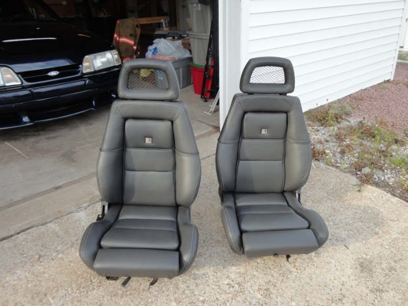

It's not that bad. You could more than likely handle it. I did it in my garage in about a day and a half. I took my time and it turned out pretty nice.
It was worth the time, effort, and cost savings.

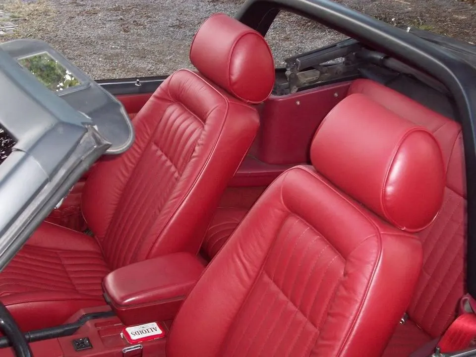

850 for vinyl is to high, I supplied the leather that I found online and have have right at a grand , material and labor, in these. Fronts, back and door trim panels with enough leather for several repairs if need be.

Thanks man, looks good. If you don't mind me asking about how much was the labor?
*Edit* So you just bought like a ream of leather and brought it to em?
This was a year and a half ago but material and labor was like 450-500 each. She said last year labor on the same flo-fit seats would be 750, they were a PITA 26 or so panels in each seat. That still puts you at 1200 for leather. I think it was Burnetts Village .com or something like that where i found the leather.
$185 per hide. How many did it take?
