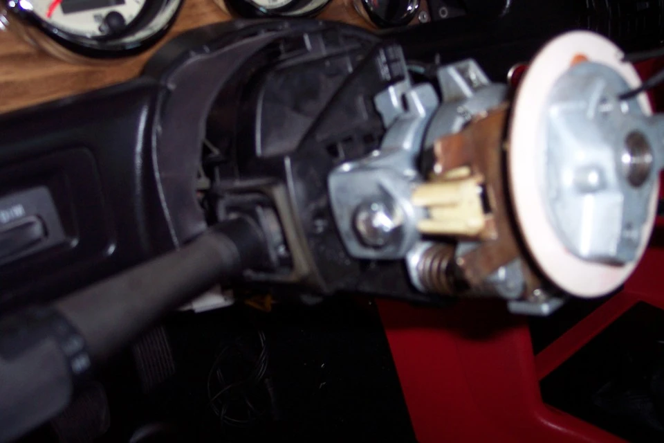

Embarrased to say that this pic is supposed to show the threads I tapped into the pivoting head.
And this of course would be the pivot portion.
The next blurry pic is of the two pieces married, and nutted together:
What happens when you do all this you ask ( all one of you). The column gets factory tight. It still pivots, yet it no longer wobbles. The left-right play in the steering was dramatically minimized. Most importantly and for whatever reason as a by product my diabolical column-ectaty,......
The stinking squeak is GONE.
Now I cannot recommend this solution to anybody else, because it takes the requisite drill press, and makes it really hard to get the column trim back on. but in my case, it fixed my problem. And there was always that "what if I "f" it up so bad I can't fix it?" thingy to consider....

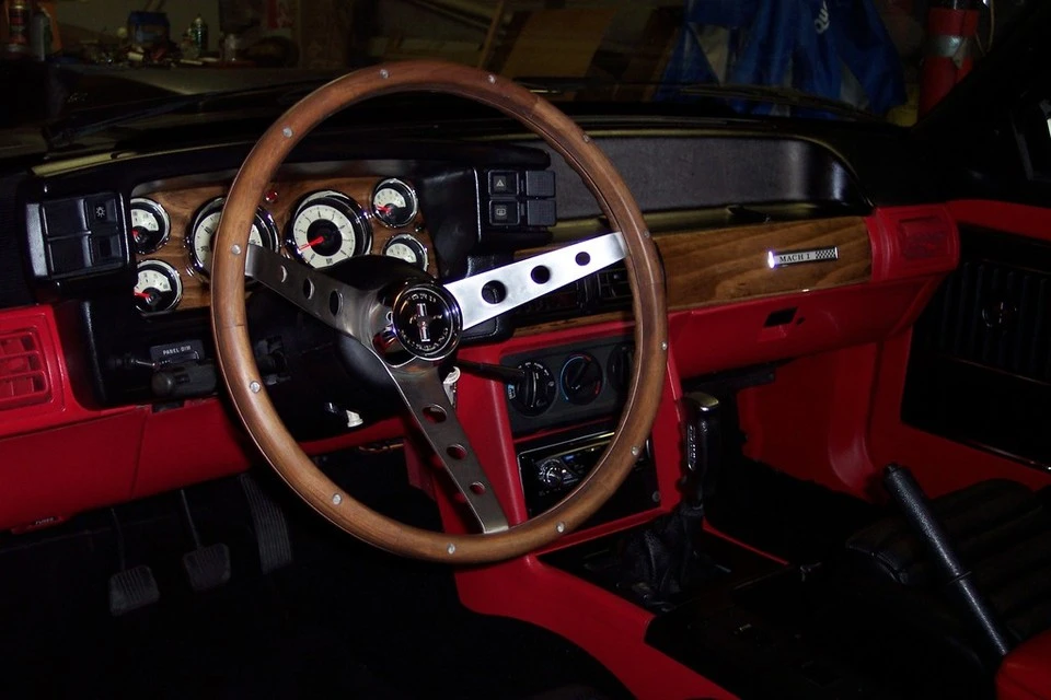

AS a footnote while I had it off, and since I was butchering things, I decided to "shallow up" the dish in my retro steering wheel. The wheel was really too deep for me, and it made me feel like I was sitting too close to it. I looked for a custom aftermarket piece, but they were all too "blingy" for me. So that said, I decided to "customize" it myself.
OLD WHEEL
NEW, IMPROVED "LOVE IT OR HATE IT" WHEEL
OLD,.....
NEW.
I cut 1.5" inches out of the dish, and welded it back together. Painted it gloss black and added red pinstripes to match the interior color.
I don't know if I like it enough to keep it, but for now I can stop feeling like I'm about a foot away from the wheel.
