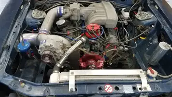

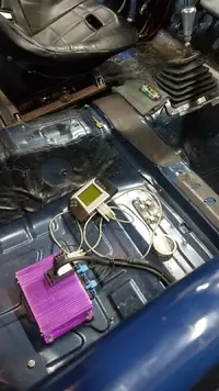

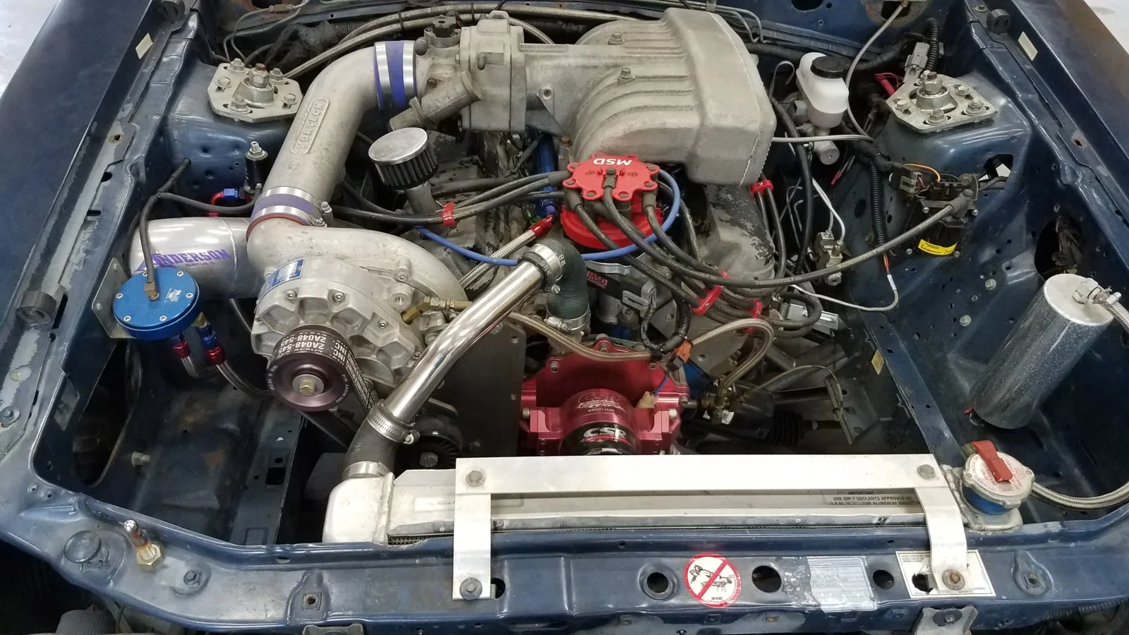

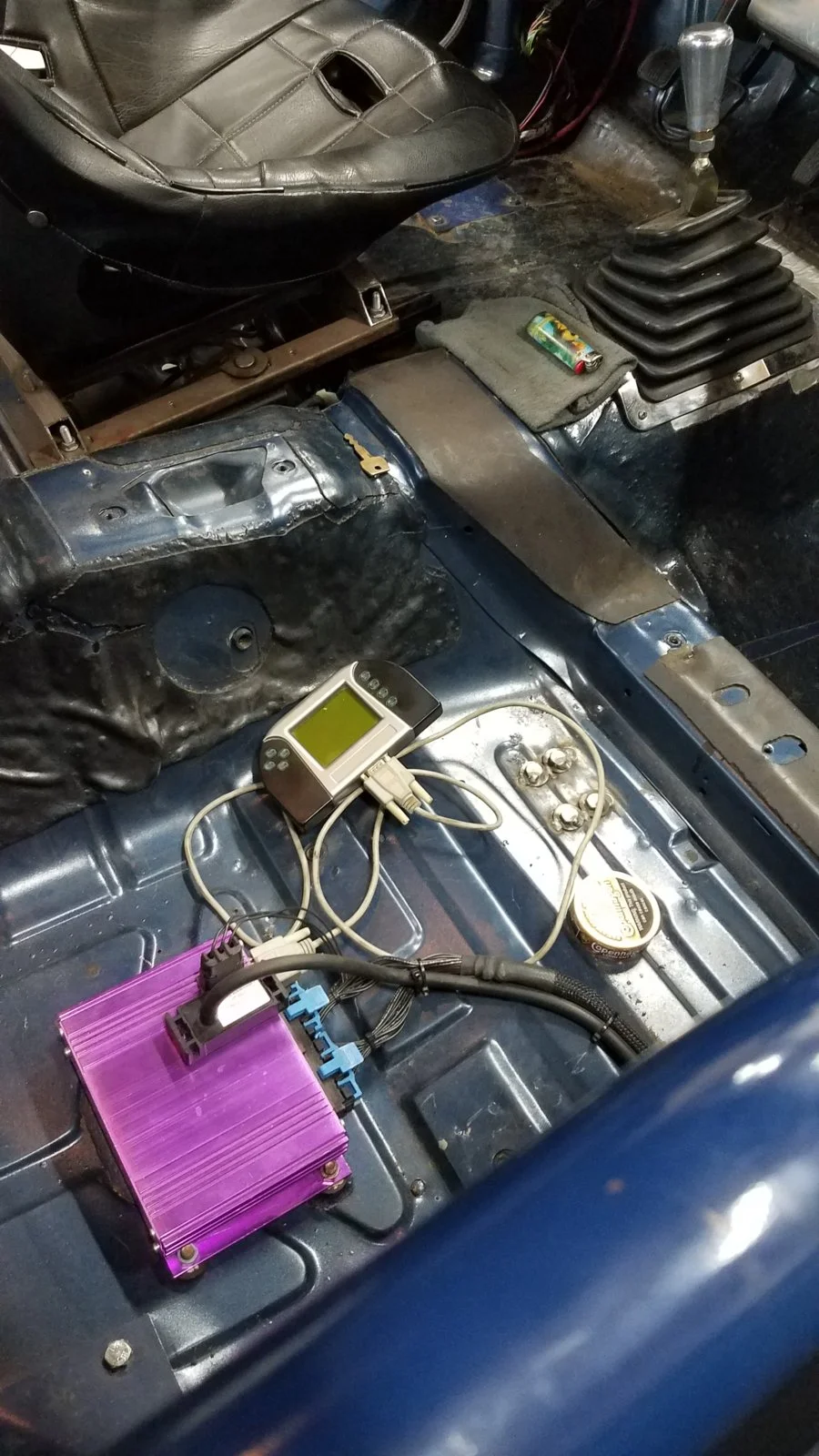

I appreciate your help I built the car 11 years ago and then had to put it away after only a couple hundred miles it's a 306 trick flow heads Anderson blower cam Vortec 5-speed 373 gear Anderson Ford Motorsports PMS system the car literally got put away for 10 years I'm just trying to bring it back to life I don't recall the egts being that high on it the high timing and high egts appear to come in before the standalone system comes into play also cannot seem to save changes on the engine management system you don't know anybody who is familiar with the Anderson Ford Motorsports PMS system do you this whole thing literally has two to three hundred miles on everything so I'm not looking to discard any of the items that purchased during the build

I am sorry I do not, I could however talk you through the basic concepts behind tuning an engine completely.... maybe @Decipha can help more he is good with the stock stuff. You can try using his website efidynotuning.com for more info on the stock ECU.
yea take that off and throw it in the trash toss a moates quarterhorse on it and actually tune it
also i see you have an msd distributor. Take that off and pitch it in the trash as well and upgrade to an oem stock replacement distributor.
egt is useless on an na gas engine
I had a PMS years ago, when my car was n/a it worked pretty well and was easy to use. Once I started heavy mods adding
boost etc. it seemed to struggle.
There are a lot better tuning options now especially for a boosted set-up, like Decipha mentioned a Moates quaterhorse is pretty
affordable and you can get them with a base tune loaded to your set-up to get started.
I currently am running a Stinger PimpXS which is a stand alone MS3 based ecu, still learning but it's been great.
