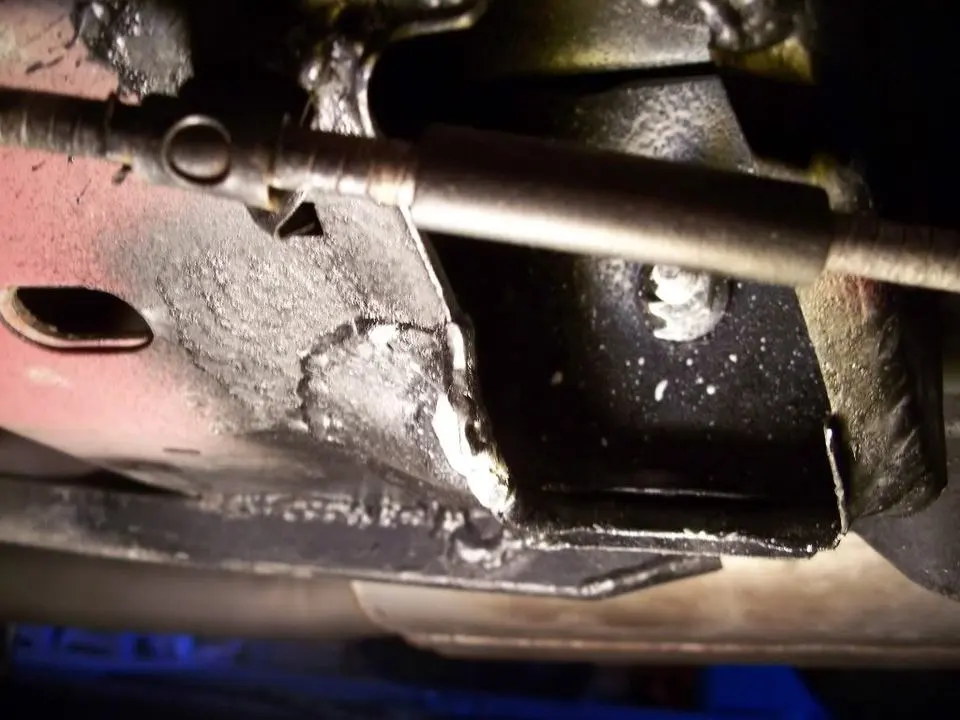

Same thing happened to me as 347HO, So I took the car to a local restoration shop that does high dollar builds to make sure it was done right and they charged me $200 to weld the torque boxes. The original spot welds on the top lip were being pulled away, so they pushed them back up and welled it and they put thick plate steel in the corners of the boxes and to the body it looks great and the car doesn't creek at all in the back any more. It took them about 4hrs. I could take some pics if you would like.

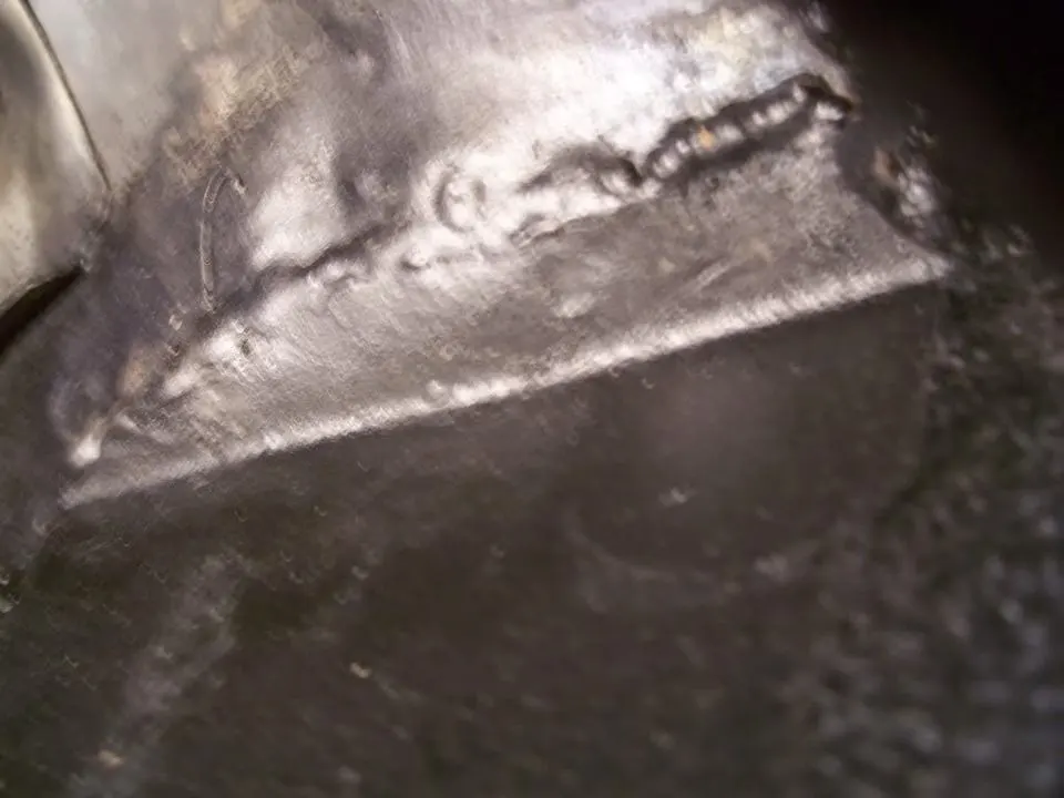

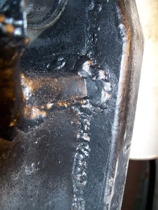

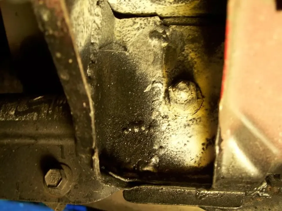

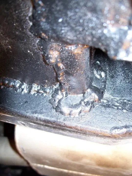

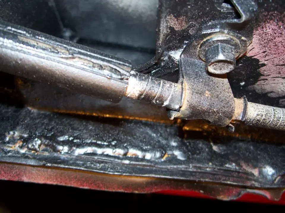

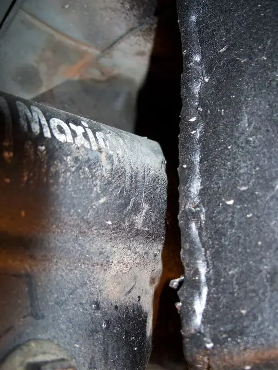

Here are the pictures they are the best I could get.
That's where he welded in a plate because it usually cracks there.
A piece of angle iron was welded from the box to the crimp weld.
Another plate was welded from the outside of the box to the subframe.
The same piece as above but a different angle.
The back corner of the box welded
The same corner as above but the inside with a piece of angle iron welded
The upper edge of the box where it is spot welded from the factory was weled from the outside and inside the car. I can take out the back seat if anybody wants any pictures of the inside were it was welded.
