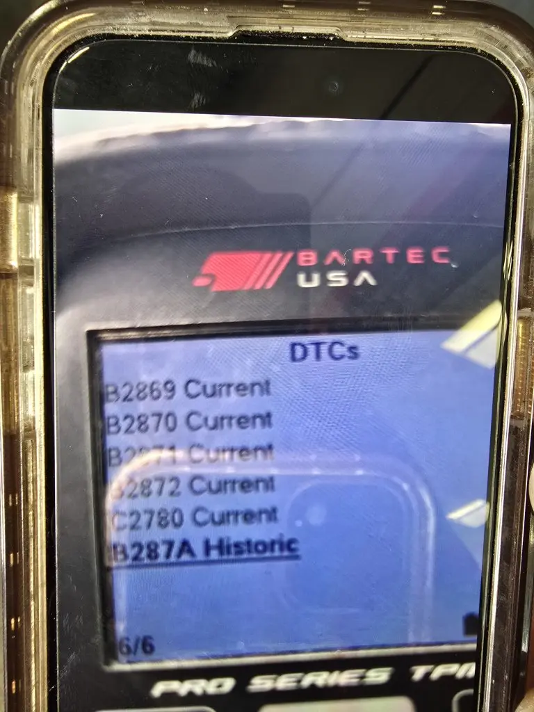

Hey all, purchased my first Mustang approx. 1 month ago (2014 GT). I replaced the tires and the TPMS sensors with a local tire store (Discount Tire) and I have been having issues ever since. For what ever reason the TPMS refuses to learn to the car. We have tried 4 or 5 different brands of TPMS sensors including OEM and still can not get it to learn. I have been to 2 local Ford dealers trying to see if they had better luck and its the same story, though 1 dealer told me that the BCM was working correctly. The tire store was able to pull a list of codes that ive included here. Is there some magic secret that I am unaware of? Could this potentially be because there is a tune on the car? TIA as I am brand new to Mustangs

A tune should not have anything to do with it.
Any device plugged into your OBDII port?
That can cause interference.
Also, the fact that two Ford Dealerships said they could not find the problem is amazing.
They are not even trying if that is the case.

Nothing in the OBD port I can confirm.
