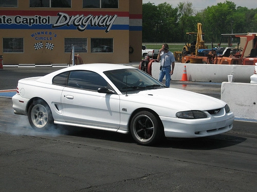

I went to the track yesterday and ran anywhere from 13.5's to my new best of 12.97 @ 105.5 with a 1.77 60 foot.
Combo:
trickflow h/c/i kit
24lb injectors
75mm Tbody
lightning maf
mac longtubes / prochamber / magnaflows
aluminum driveshaft
kc clutch
mgw short shifter
3.73 gears
Steeda springs
Tweecer tuned by Stanger007
315/35/17 sumitomos for 13.5 runs
17inch MT ET streets for the other runs
two runs at 13.5 @ 105 with like 2.0 60 foots
then two 1.89 60 foots and 13.1x @ 105 runs
then a 1.77 60 foot with a 12.97 @ 105 run
then a 1.84 60 foot with a 13.0x @ 105 run
Im satisfied that i broke into 12's with basically no suspension except some lowering springs which arent made for dragracing.
Any input from other trickflow h/c/i users?
