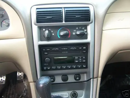

another 40th w/o traction control

so if there isnt a button does that mean it doesnt disengage or you dont even have trac control on your car?

For 2004, ford made it optional on all models of 2004 GT. It was an $800 option, and not a lot of dealers got it so a lot of 2004's out there have neither ABS nor traction control.
SO if your 2004 doesn't have the T/C button, you don't have ABS as well.
