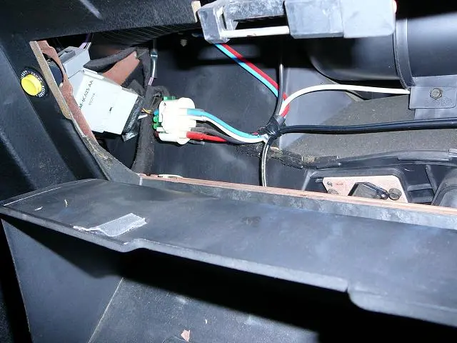

Apparently there is a TCM back behind the glove box somewhere. How do you get to it? Or, perhaps, how do you take the glove box out? If I can get that out, it would probably be pretty easy to get to the TCM.

You can squeeze in the rear sides of it and it will completely fold out.
Take some pics of where that thing sits if you can.

Illustrations show it just to the right side of glove box opening

Actually what he is talking about is called TCSM (trans control switch module).
It recieves signal from the TCS (trans control switch) and is used by the PCM to determine automatic shifts and to operate the TCIL (trans control indicator lamp) to indicate 4th gear has been disengaged.
Basically on this model they used a module to lock out OD and turn on OD light.

The main thing the TCSM does that I know of is to toggle OD. The black box is about the size of a large pack of chewing gum. It has a white sticker with black numerals for the part number. It's a 5 wire affair in a 6 pin connector.

You just reach behind the glove box and you can feel it. We pull them from auto 94-95's when we go junkyarding because they are impossible to get new. The supply is dwindling. I had 2-3 of them but used them all recently.
Even Jerry W. told me that they are just used for the OD light, and you really didn't need it, but guess what, the tranny had major issues with OD when it was not there. I've seen this on a couple of swap cars. So you really do need it.

i'm guessing it is that white thing behind the trunk release switch. am i right?

No thats the low oil level relay there. It should be on the other side of the glove box.
