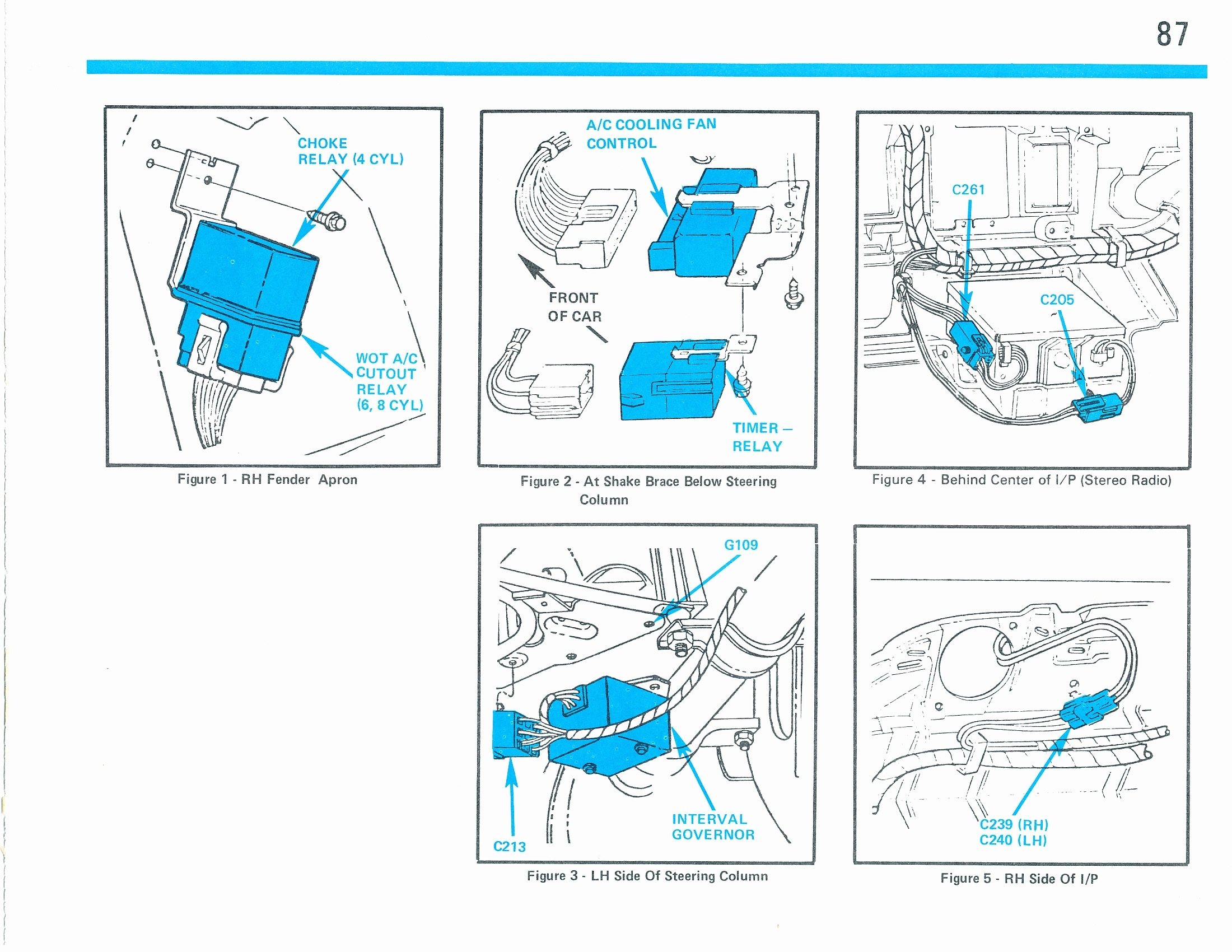

If your car has interval wipers, there is an interval governor box (black) located under the dash near the left had side of the steering column. The Ford part number for an 86 will be E4ZZ 17C476-A. The Motorcraft designation is SW-1914.

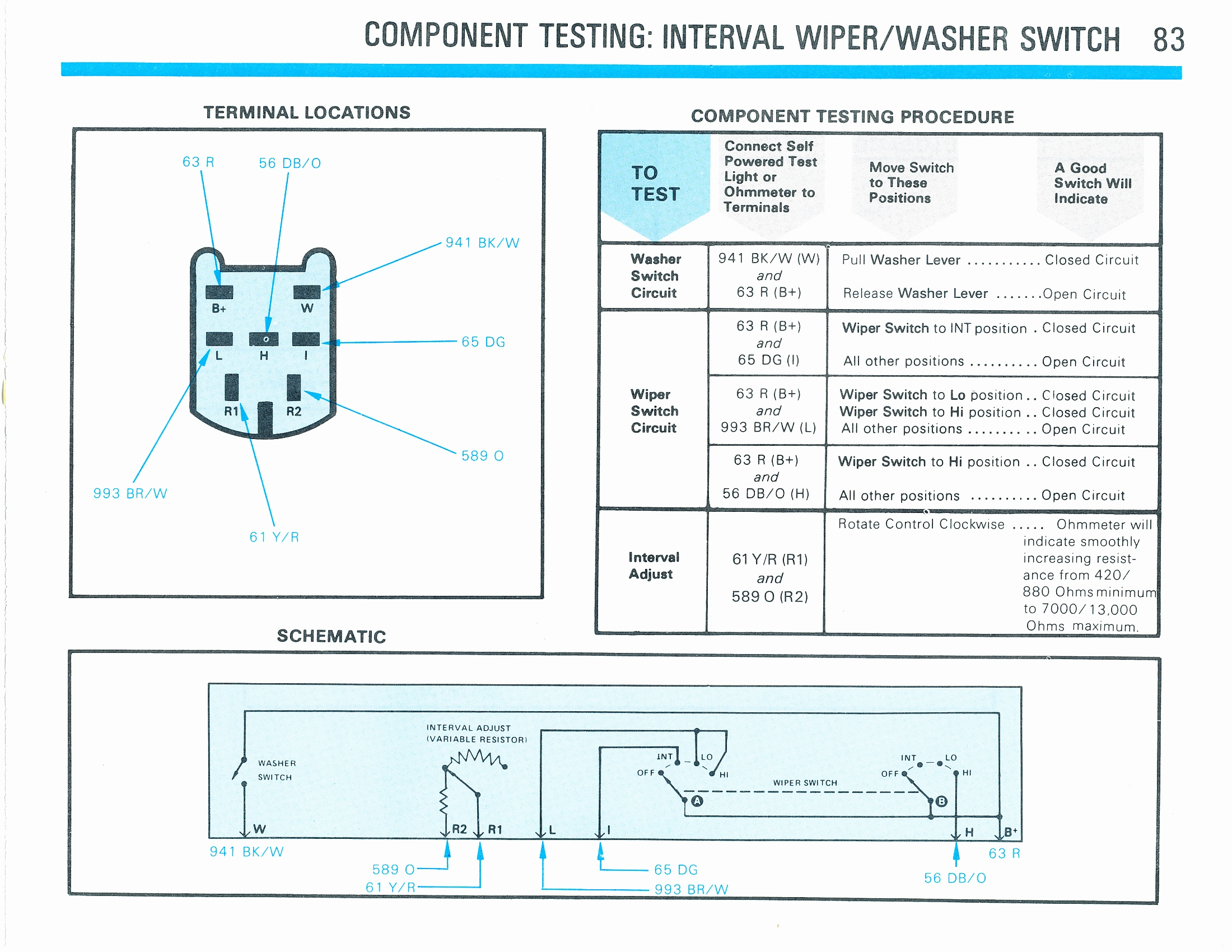

And you're right, they are hard to find. If you do find one they usually want big bucks for them. They aren't reproduced. If you have an EVTM, there is a testing procedure for the wiper switch that might give you an idea what the problems is.

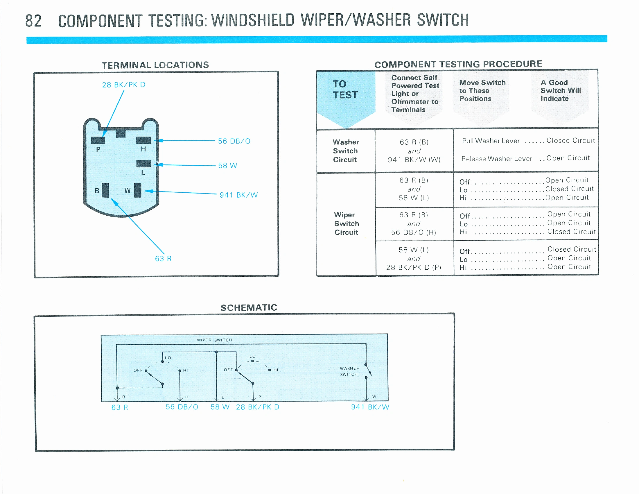

These are the two pages from my 85 EVTM on wiper switch testing. Not sure if it's different for an 86 or not. Wouldn't think so, they both used the same parts for the wiper system (at least on the passenger side of the firewall).
