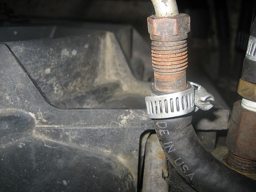

Here is a pic of what I'm talking about, the space before the thread starts prevents me from threading in the fitting. This is the top return line:

I'm sorry to say I ghetto-rigged the return line on mine when faced with the same problem. I slipped a hose over the flare and put a hose clamp immediately behind the flare to hold it.
It was supposed to be a temporary solution until I could get the AN lines and fittings that are sitting in my shop cut and made. Now almost a year later, the rubber lines are still there and have survived being daily driven and several track visits.

94, that's what I was talkin about. You will have a hard time finding flare fittings that work. Remove the intermediate fitting (that is still in your radiator) and attach it to the hard line. The intermediate fitting uses pipe thread where it goes into the radiator. You can now connect NPT fittings from Lowes to this. And you can screw a barbed NPT fitting into the radiator.

Thanks for all the advice I went to a machine shop to see if they had it or could make it and he recommended what he did on his Ford. Just slide the hose over the line and clamp it down. He said that should do it since it's a low pressure line.
That is how I have always done it and it works just fine.

That's how mine is currently as well. While it has held up, I think it looks a bit tacky and plan to redo it some time soon. If you do decide to go that route, be sure to check it periodically for leaks.
