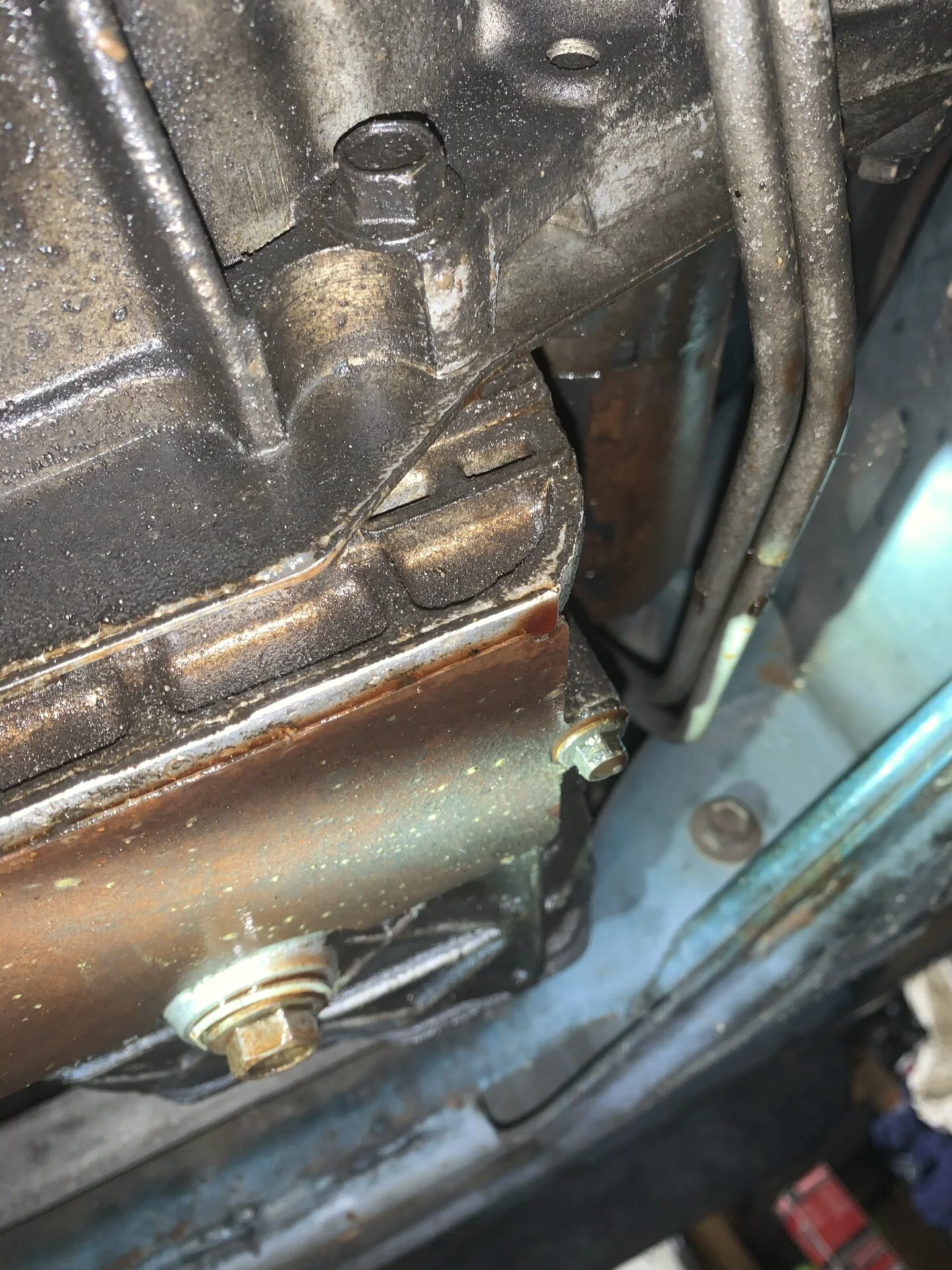

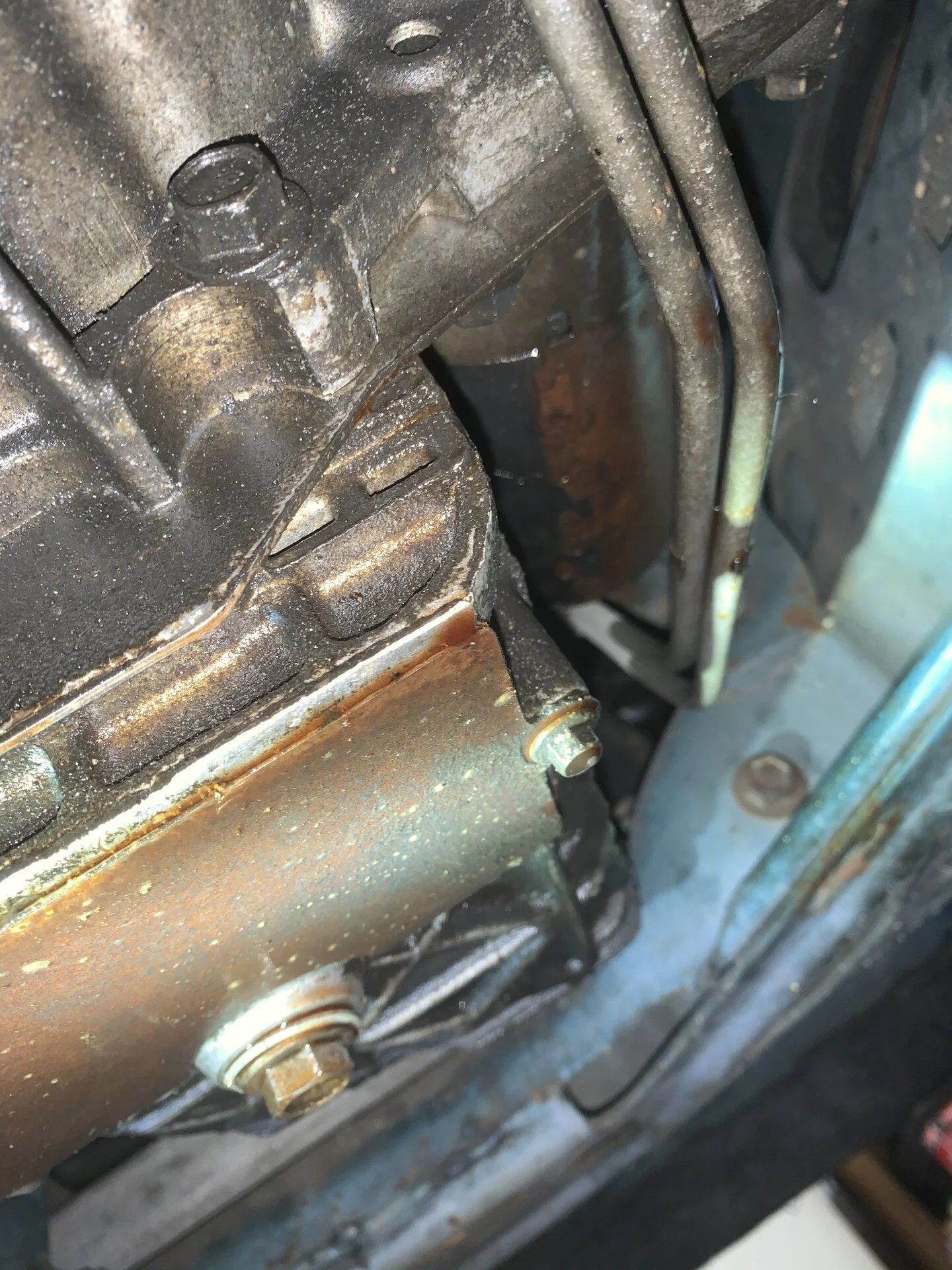

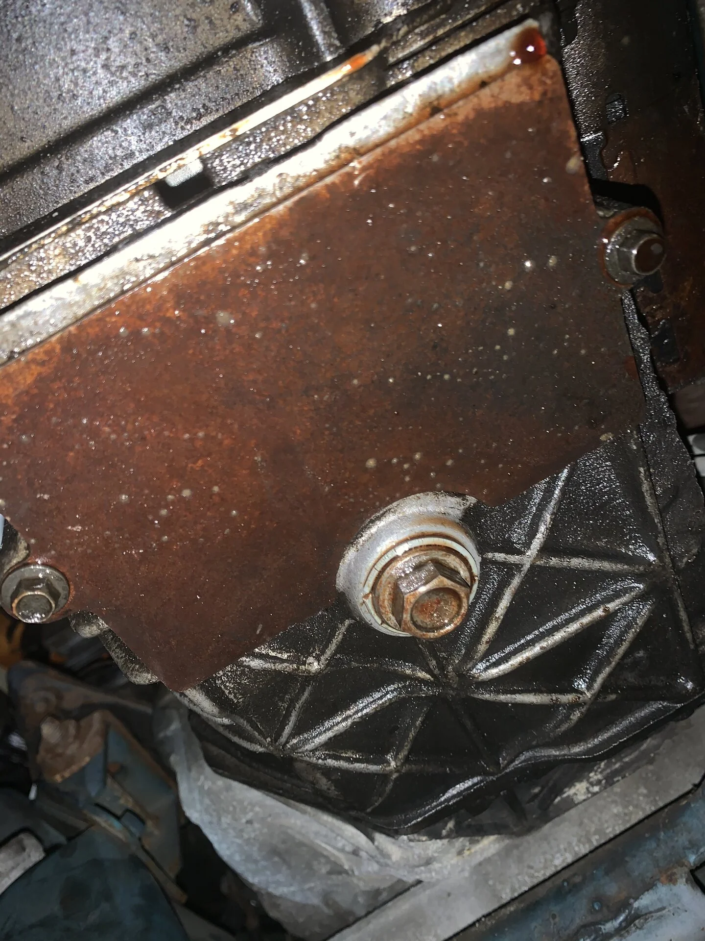

glowstang93 20+ Year Stangneter Feb 9, 2003 853 8 39 Illinois May 26, 2021 #1 May 26, 2021 #1 Got back home just in time. Leaking tranny fluid bad out of the inspection plate on the oil pan. Any clues what could be the cause? 2.3 Attachments 67CCA2CF-B42F-4F98-AABD-30626DC873B5.webp 396.6 KB · Views: 131 DB49E93B-66C2-475D-B8AF-E74624830516.webp 437.5 KB · Views: 141 174BED94-6DD3-4CAA-832C-3E2AC3EBC073.webp 392.6 KB · Views: 151

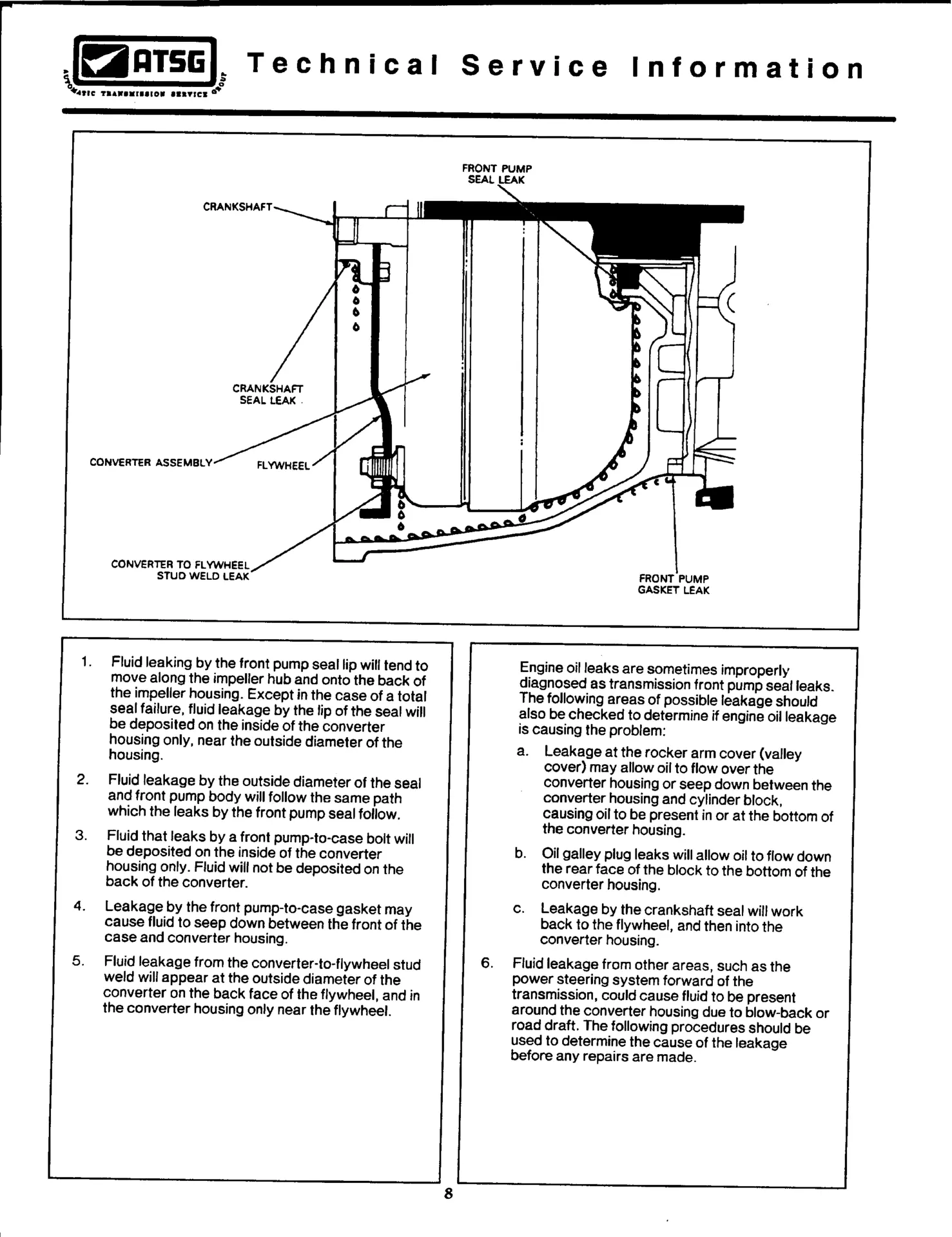

J junkyardwarrior Well-Known Member Jan 10, 2011 400 113 63 Jun 21, 2021 #2 Jun 21, 2021 #2 many possibilities, and A4LD transmissions are known for front end leaks. A lot of times its the seal but not always, so you should address each possibility. Read into it some more: Attachments upload_2017-1-21_5-54-45.webp 179.6 KB · Views: 113

glowstang93 20+ Year Stangneter Feb 9, 2003 853 8 39 Illinois Jun 21, 2021 #3 Jun 21, 2021 #3 Sorry I didn’t post back. Shop replaced front seal.
