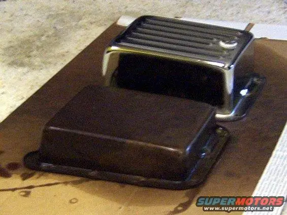

Went with deep pan
OK so here's what I ended up doing. Instead of switching filters and using the slightly shallower chrome pan, I found a deep chrome pan that adds 2 qts to the trans. The pan is 4" deep at the deepest point with a drain.
