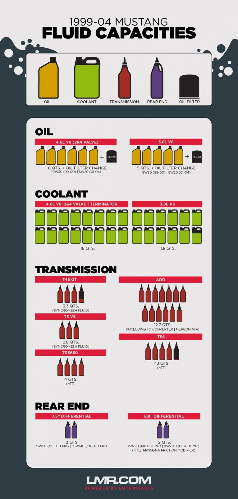

J jfernandez31317 New Member Jun 3, 2019 2 0 1 38 Texas Jun 3, 2019 #1 Jun 3, 2019 #1 This my first post I have 00 Mustang gt with the T45 trans. Just wanted to know what would be the best trans fluid to change it with and how many quarts should be used?
RaggedGT Been here over a DECADE and still no CT Mod Dude Jul 20, 2014 4,739 3,188 203 41 Taylorsville ky youtube.com Jun 3, 2019 #2 Jun 3, 2019 #2 Welcome to Stangnet
J jfernandez31317 New Member Jun 3, 2019 2 0 1 38 Texas Jun 3, 2019 #3 Jun 3, 2019 #3 Thank you! Do you recommend any brand?
