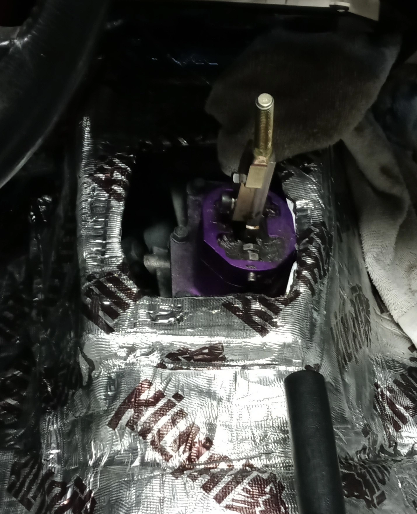

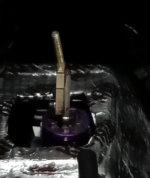

My shifter or transmission leans towards the passenger side is this normal do I need engine mounts trans mounts or both 91 convertible GT ..... TKO-600.... if I need mounts I’m thinking about energy suspension ... ?

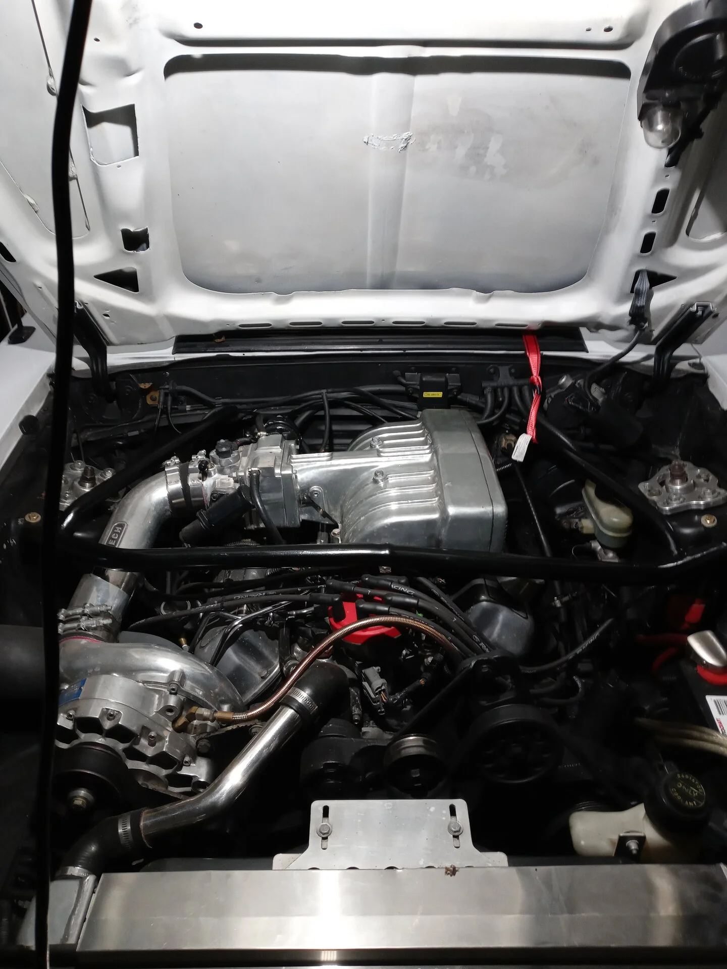

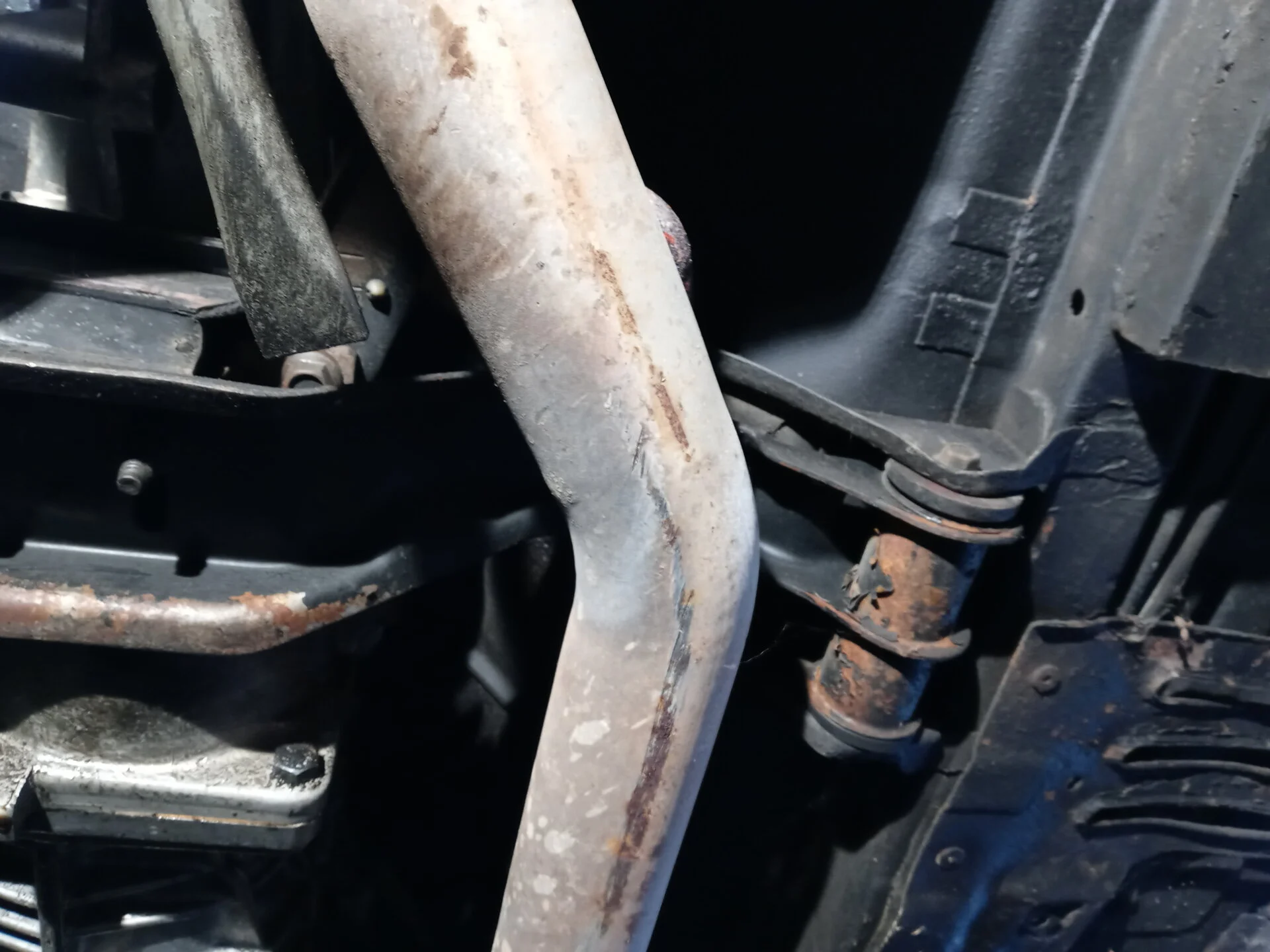

I’m going to really look at the engine today and climb up under the air just to check everything out .... i’ll report back might even have some pictures .... thanks

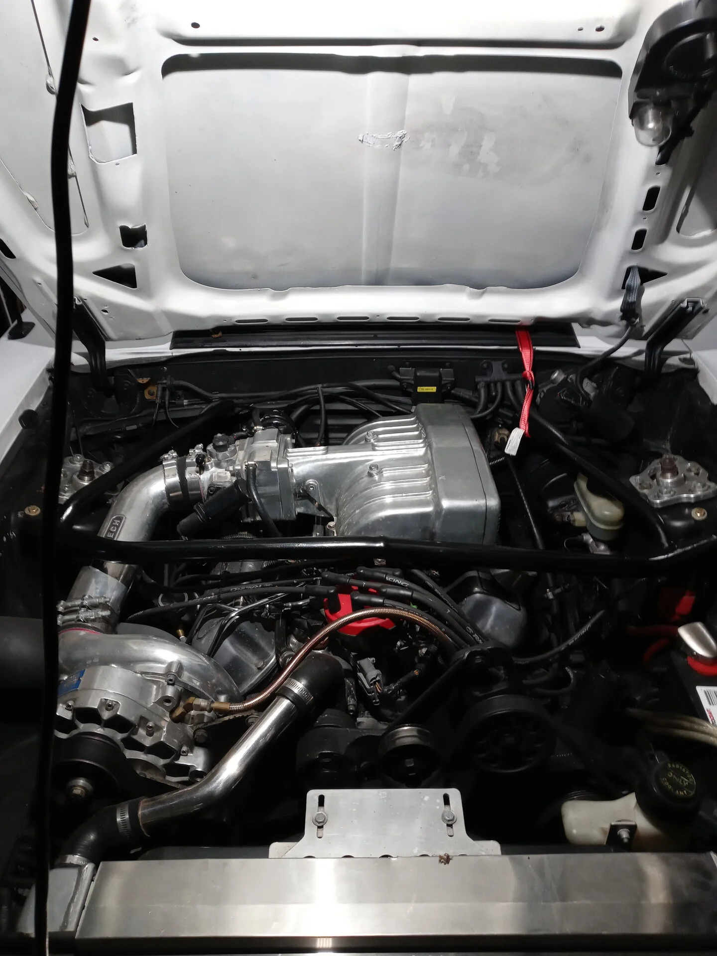

I’ll have the car up on jackstands and I can really take a good look this weekend .....

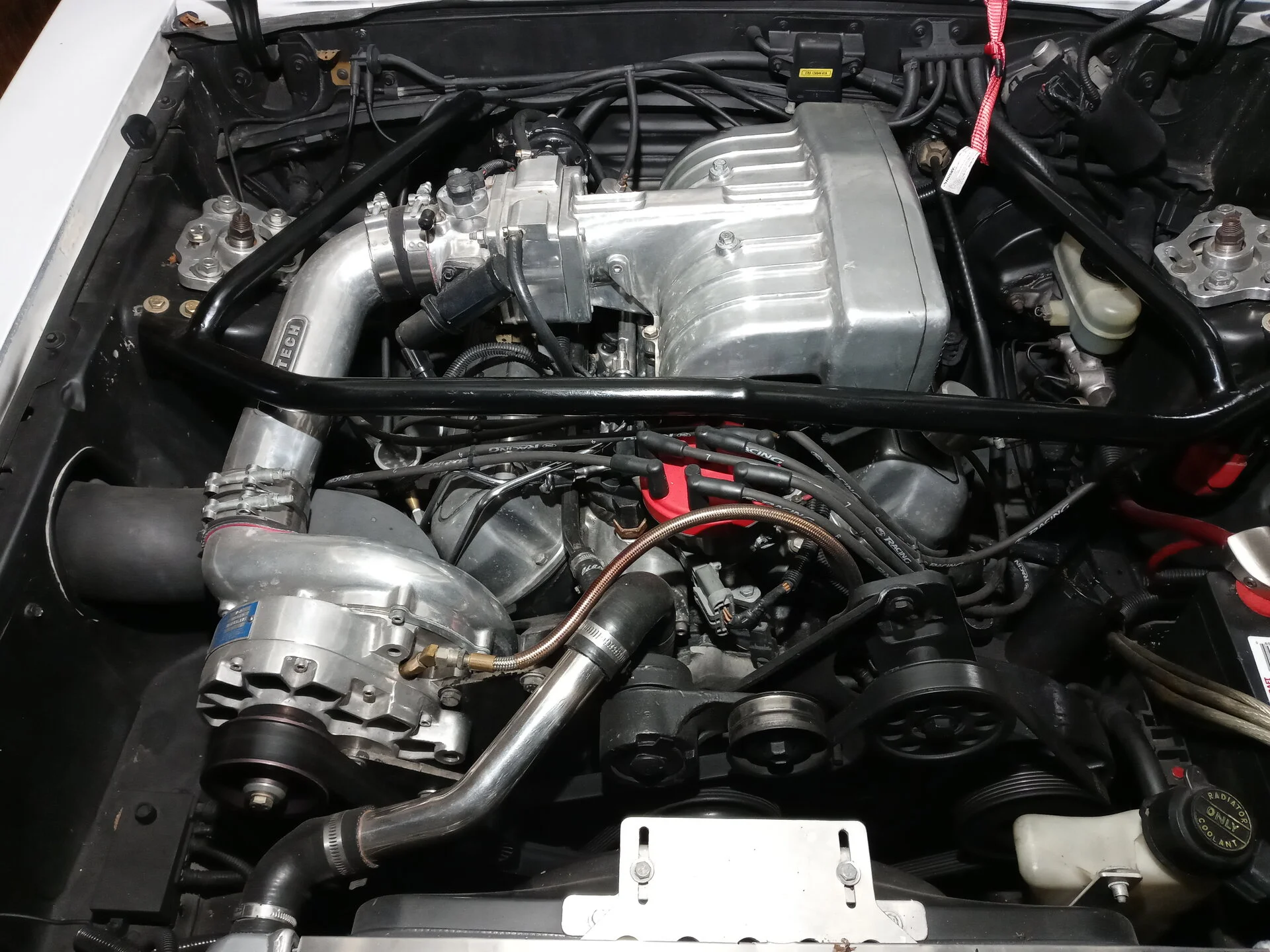

Maybe my eyes are fooling me but the engine looks rotated counterclockwise. This would explain the transmission tail being rotated that way. If the engine is straight and the transmission is bolted to it, it can't be bent that far off.
Reactions: 1 person

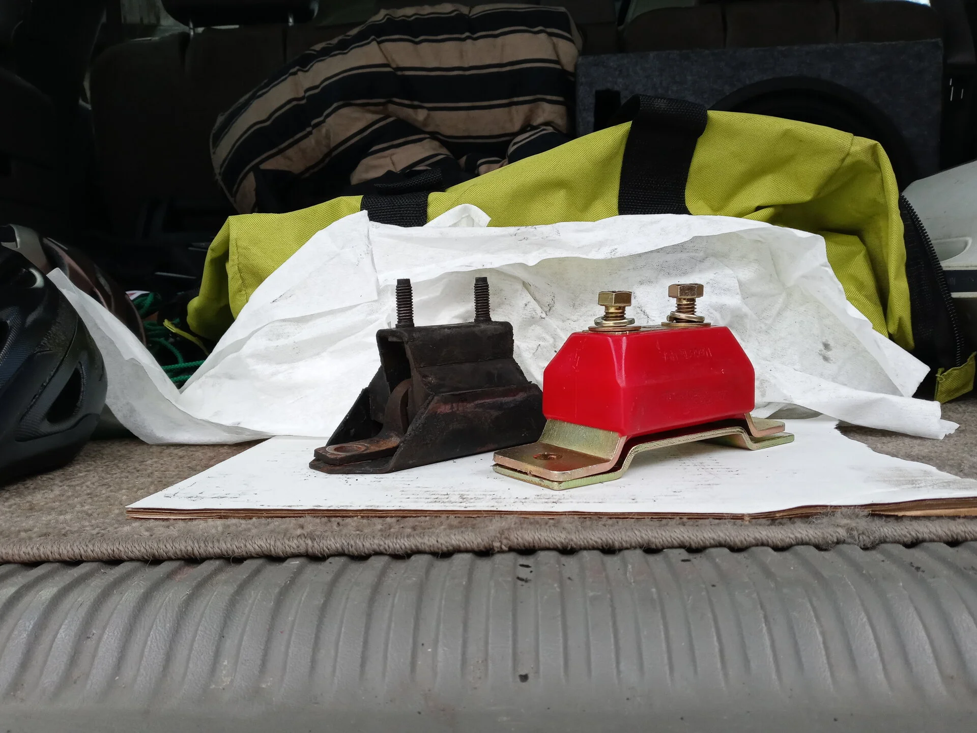

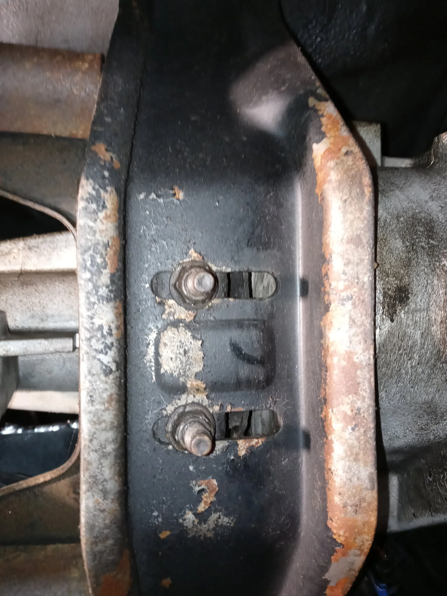

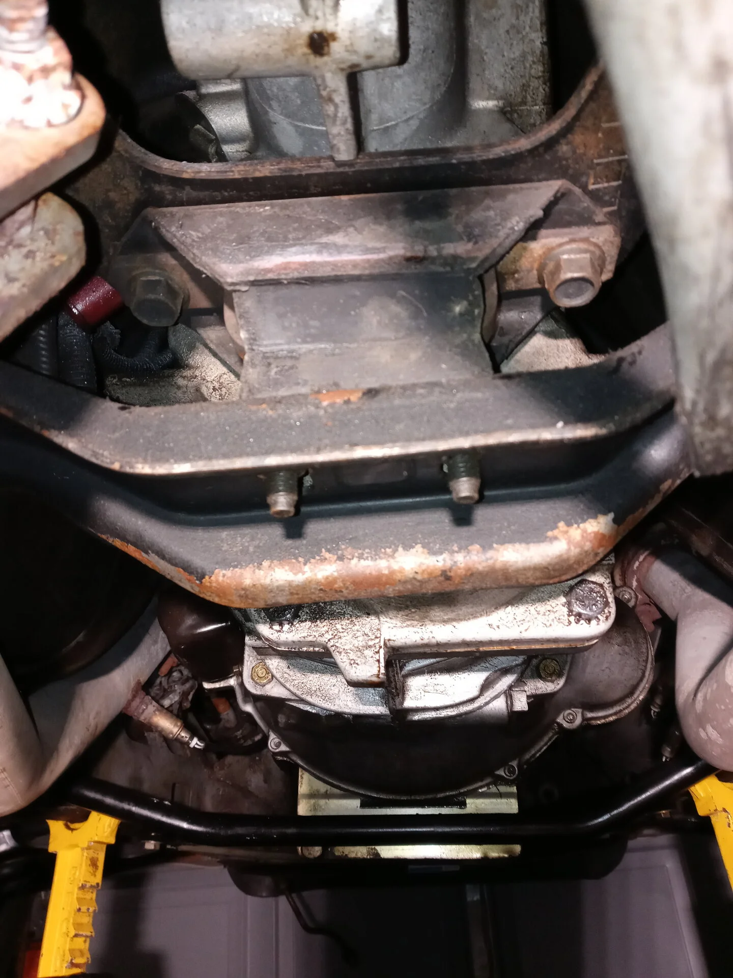

Ford double hump crossmember.... Energy suspension bushings on it it’s welded even .... by the summer I’ll have there trans and engine mounts.... couldn’t get a picture of the engine mounts .... it does lean/angle towards the passenger side .... but it seems like you would have to correct it at the engine mounts ????

Both sides of my crossmember look the same ...... I guess that’s what this hobby is all about figuring out all the little problems....:oops::rolleyes::banana:

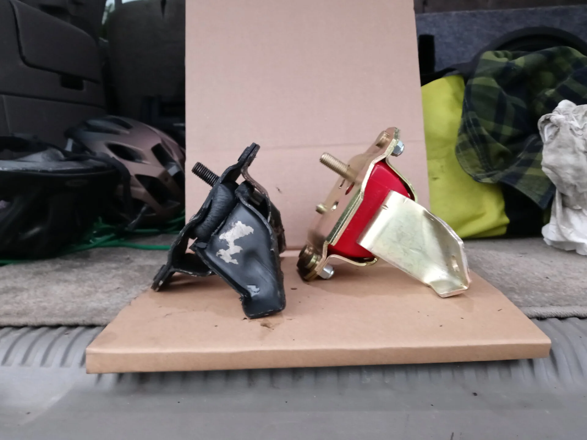

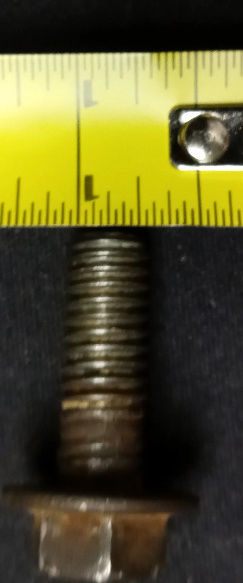

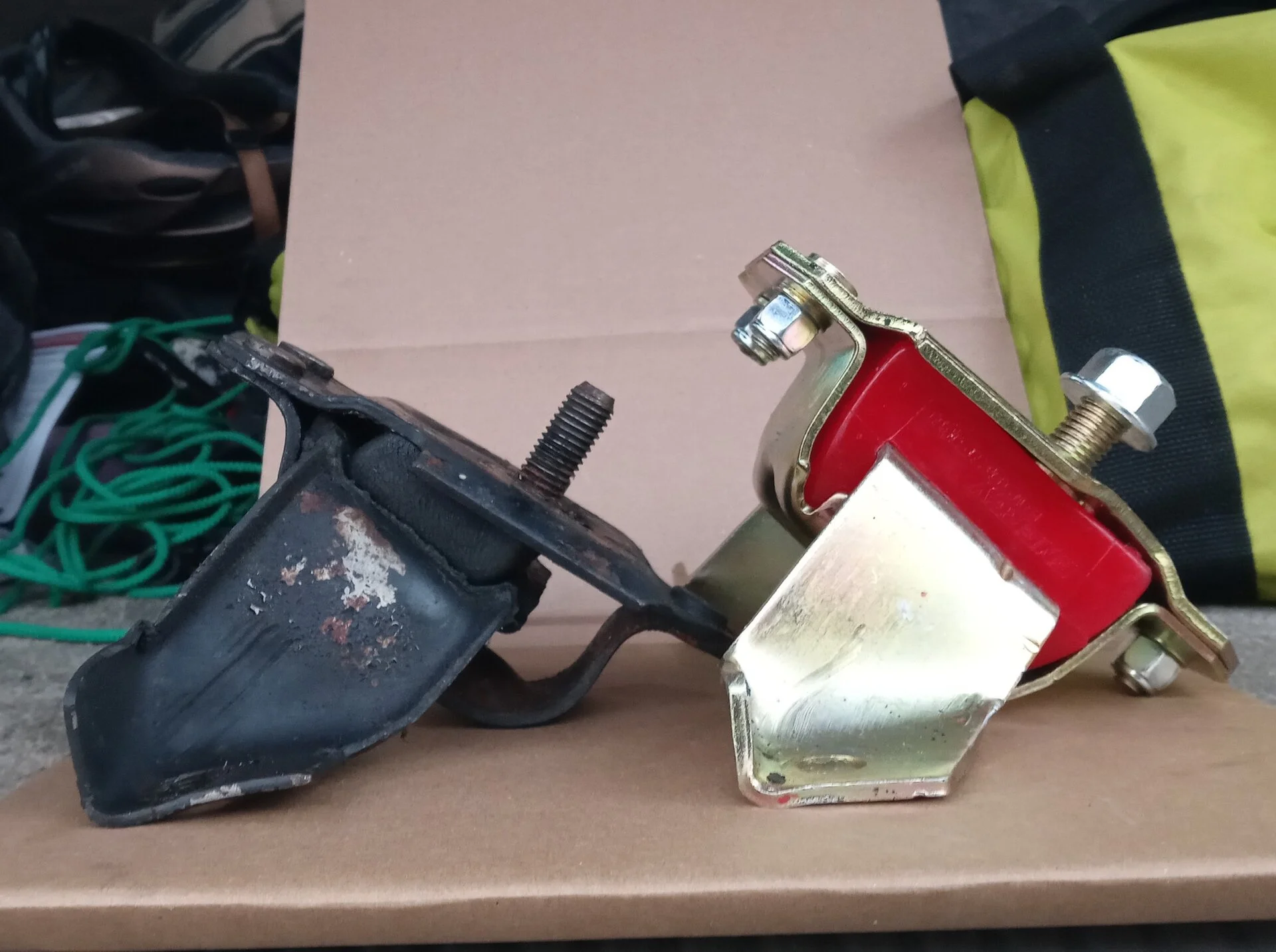

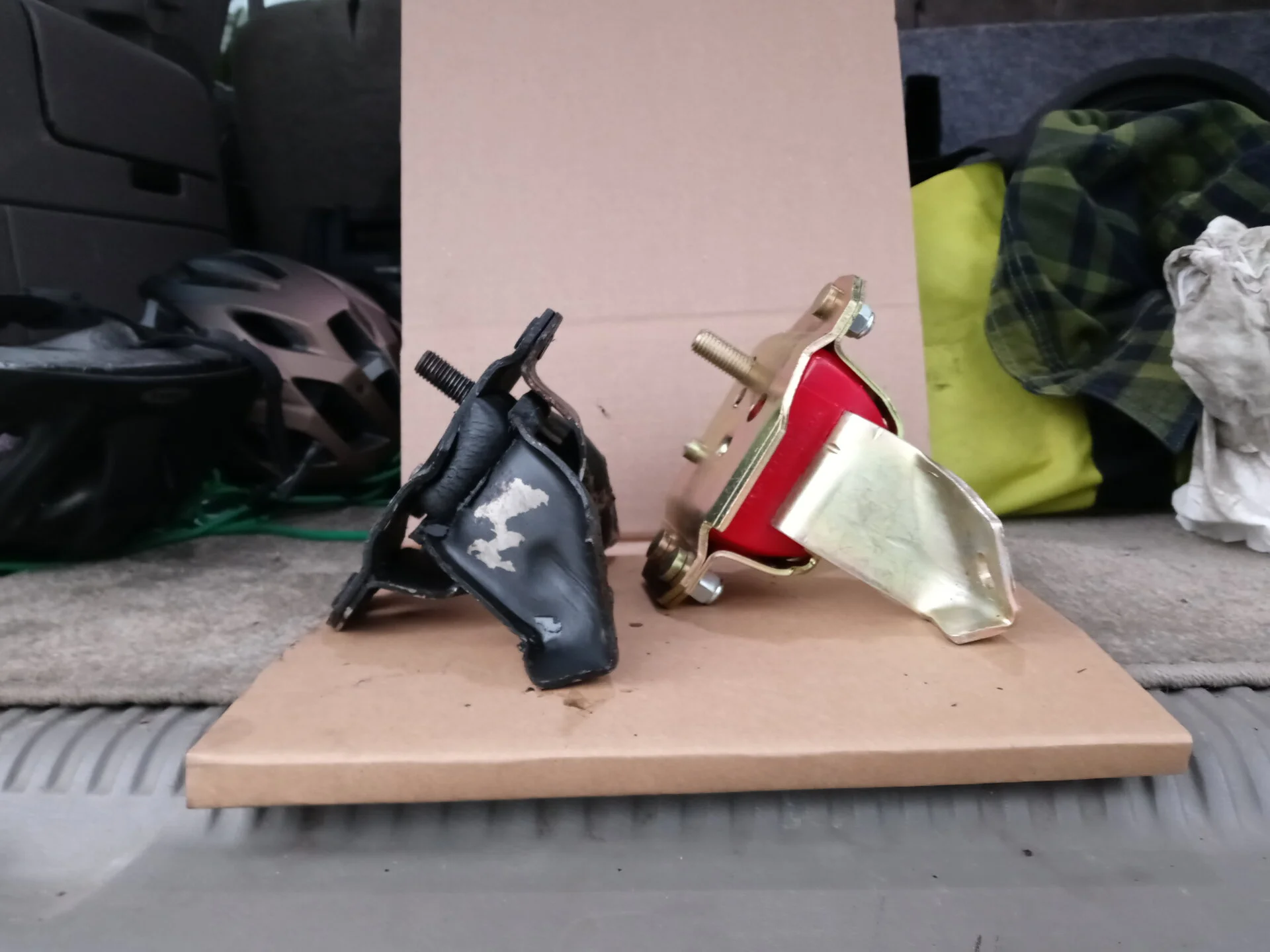

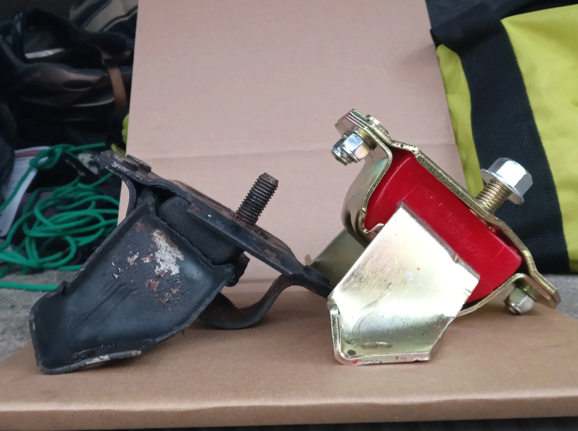

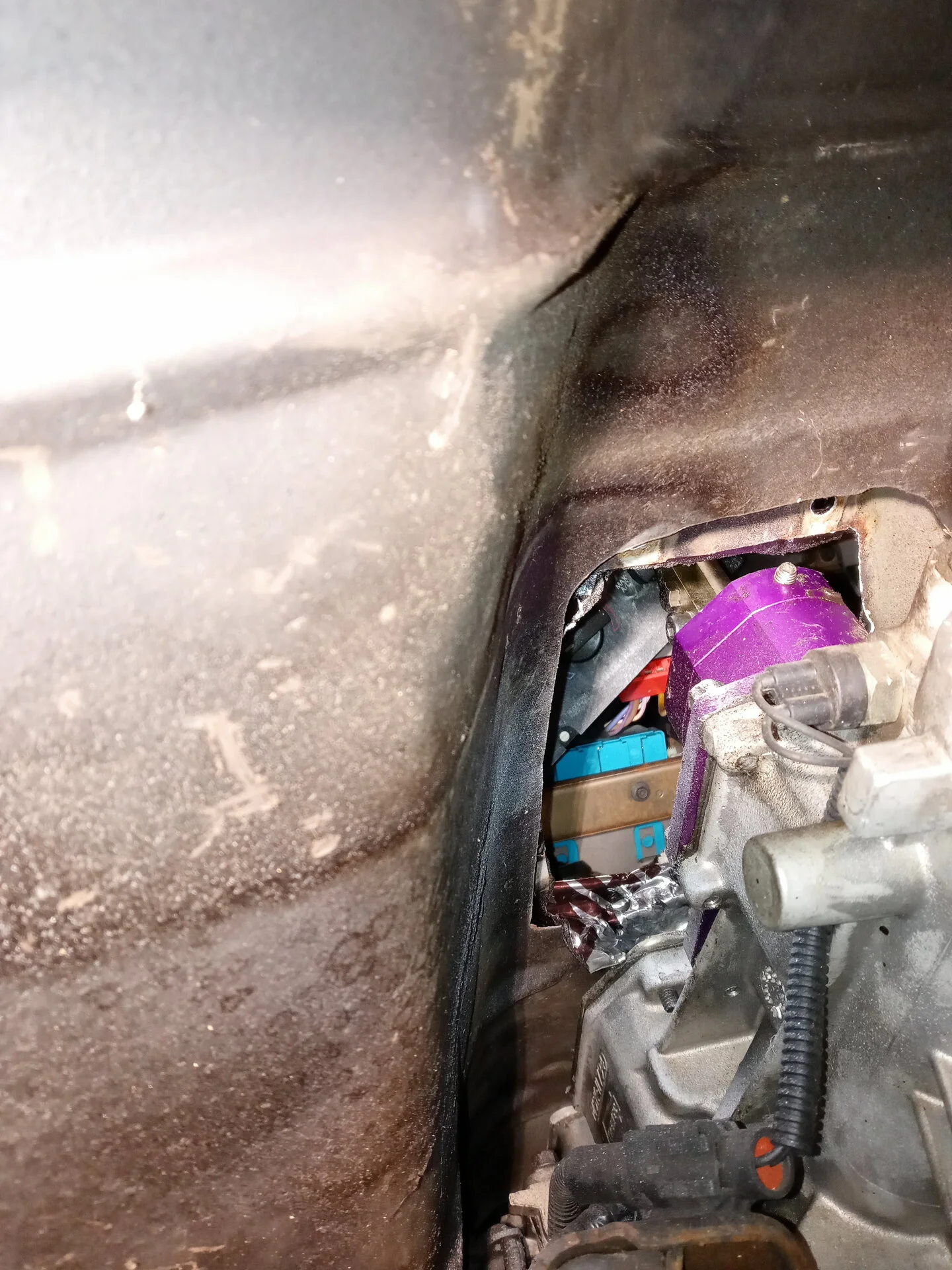

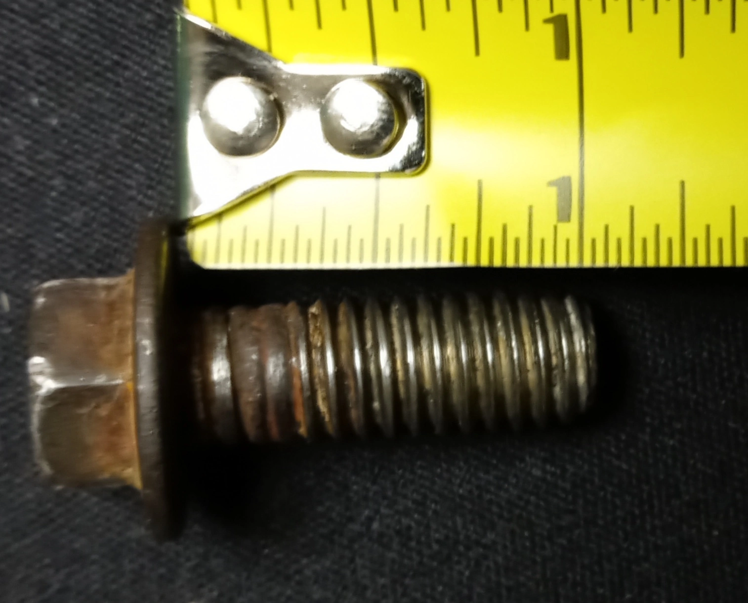

I put on the new engine mounts sits much better one of the engine mount bolts seems to fit loose... so I’m waiting on some ARP bolts....hopefully I won’t have to Heli-Coil it...... I got there trans mount I’ll put that inn in a day or two....

:poo: always something now that the engine is raised and straightened a little....... strut tower brace is hitting my supercharger tube and I got to take the brace off to get my dizzy cap back on..... just had my strut tower brace Adjusted by the welder to fit the engine a year ago..... :mad: :mad::mad::mad: good thing I got all winter ....
