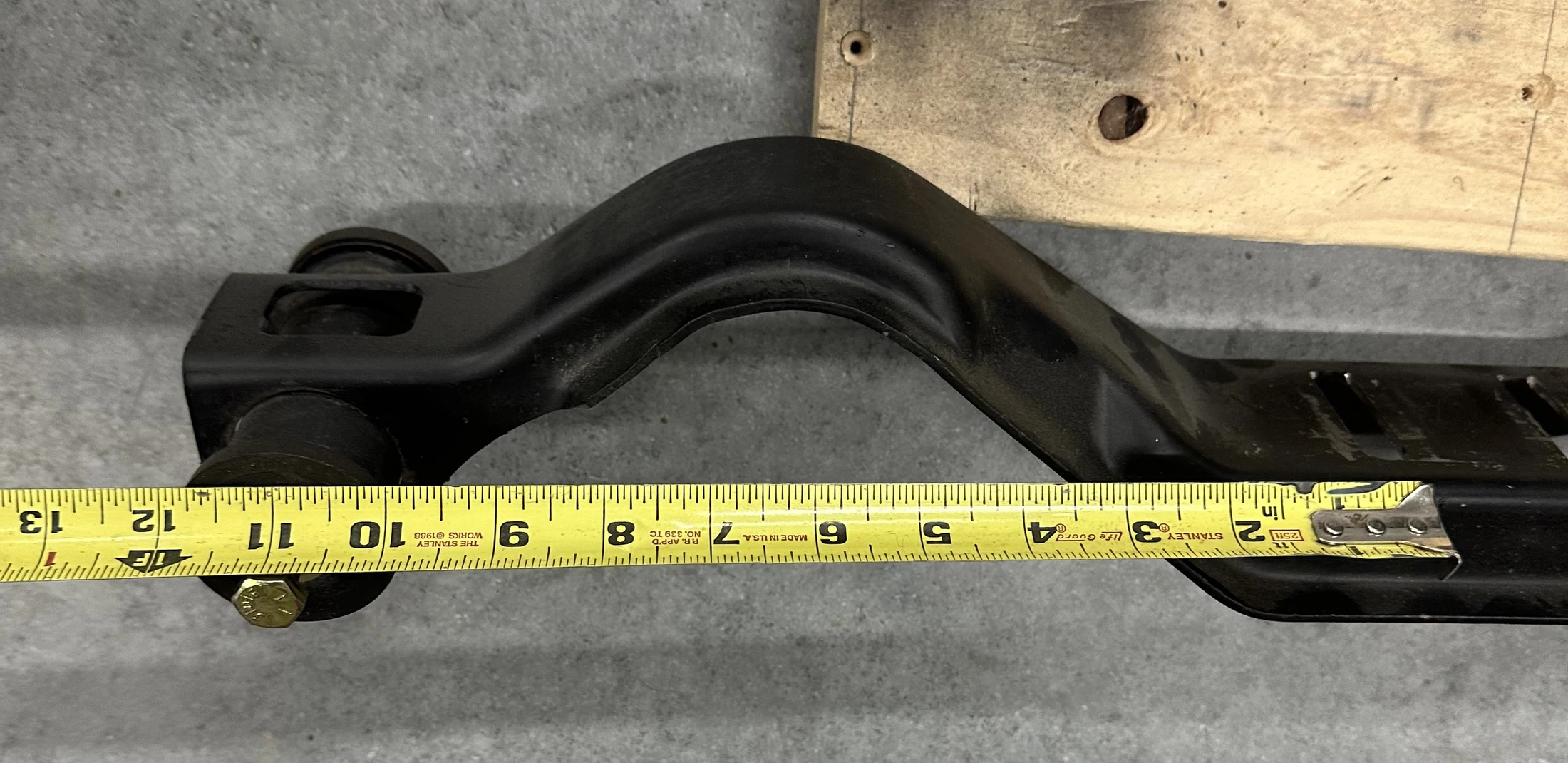

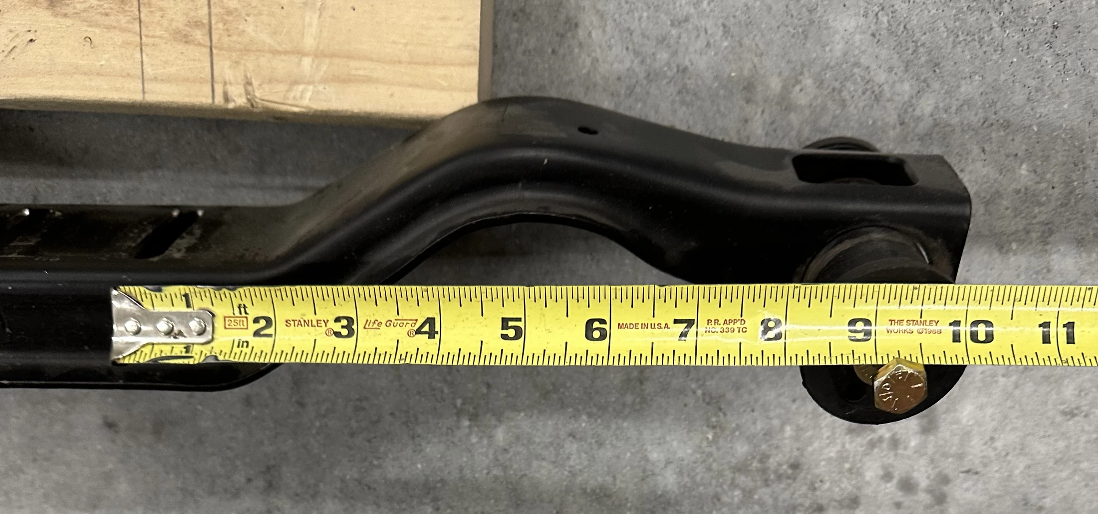

My guess is you need to flip the crossmember. the two slots in the middle of the cross member are not centered. Just happen to have my old crossmember off the car so I took some pictures. About 1-3/4" difference side to side.
