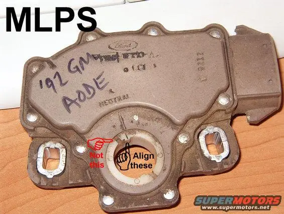

:nice: make sure it's align correctly

It is lined up, but I am trying something else.
