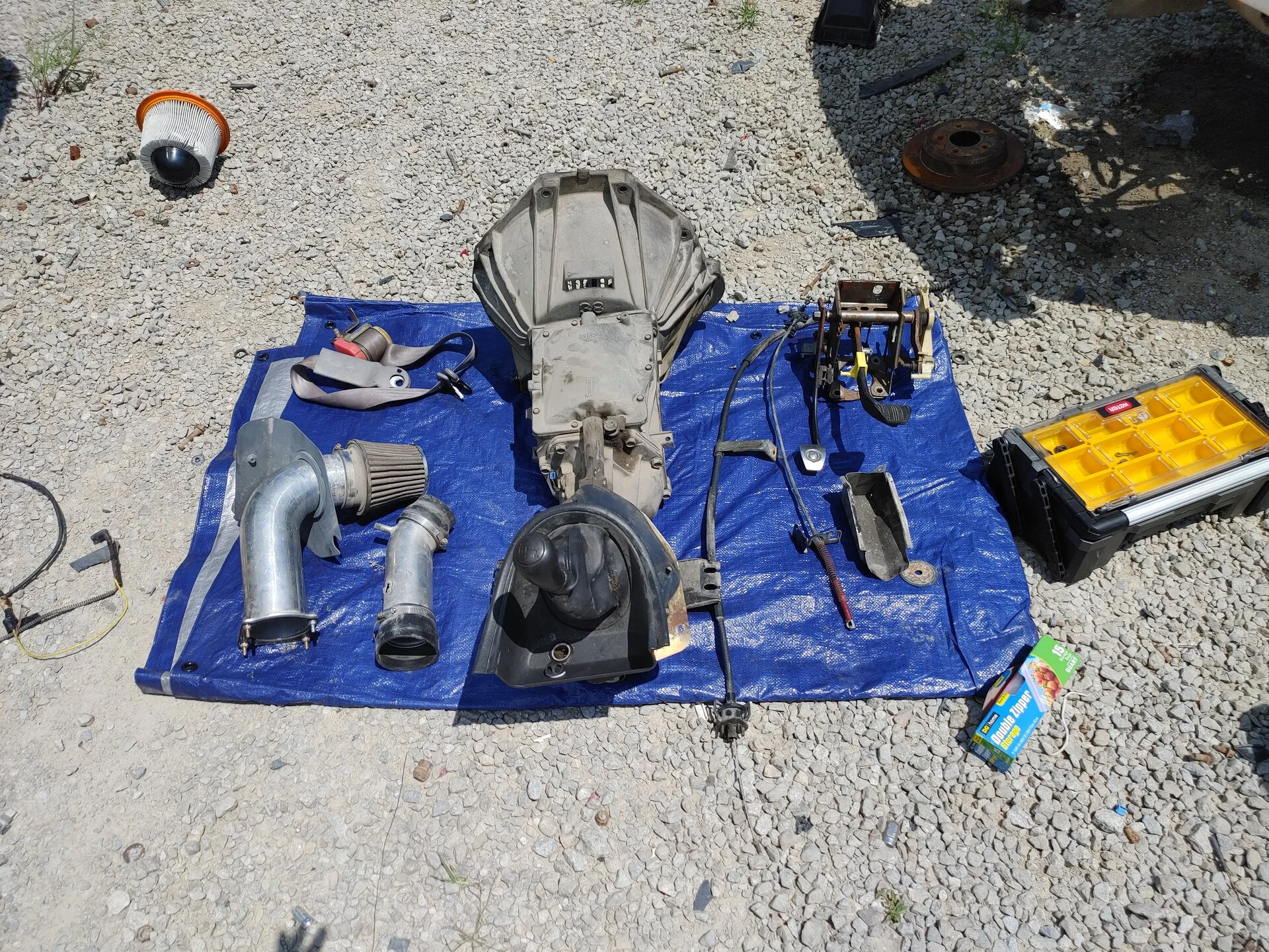

My son and I are swapping out his AOD with a T5 in his 01
When I get home tonight I will take a picture of the shifter handle where it attaches to see if it matches up to yours.
In this post, I have a picture of my T5 with a Tri-Axe on it. But if the one you are talking about is stock it wont match up.

This is the one I pulled from an 01 at the Pull-A-Part that will go in my sons car.

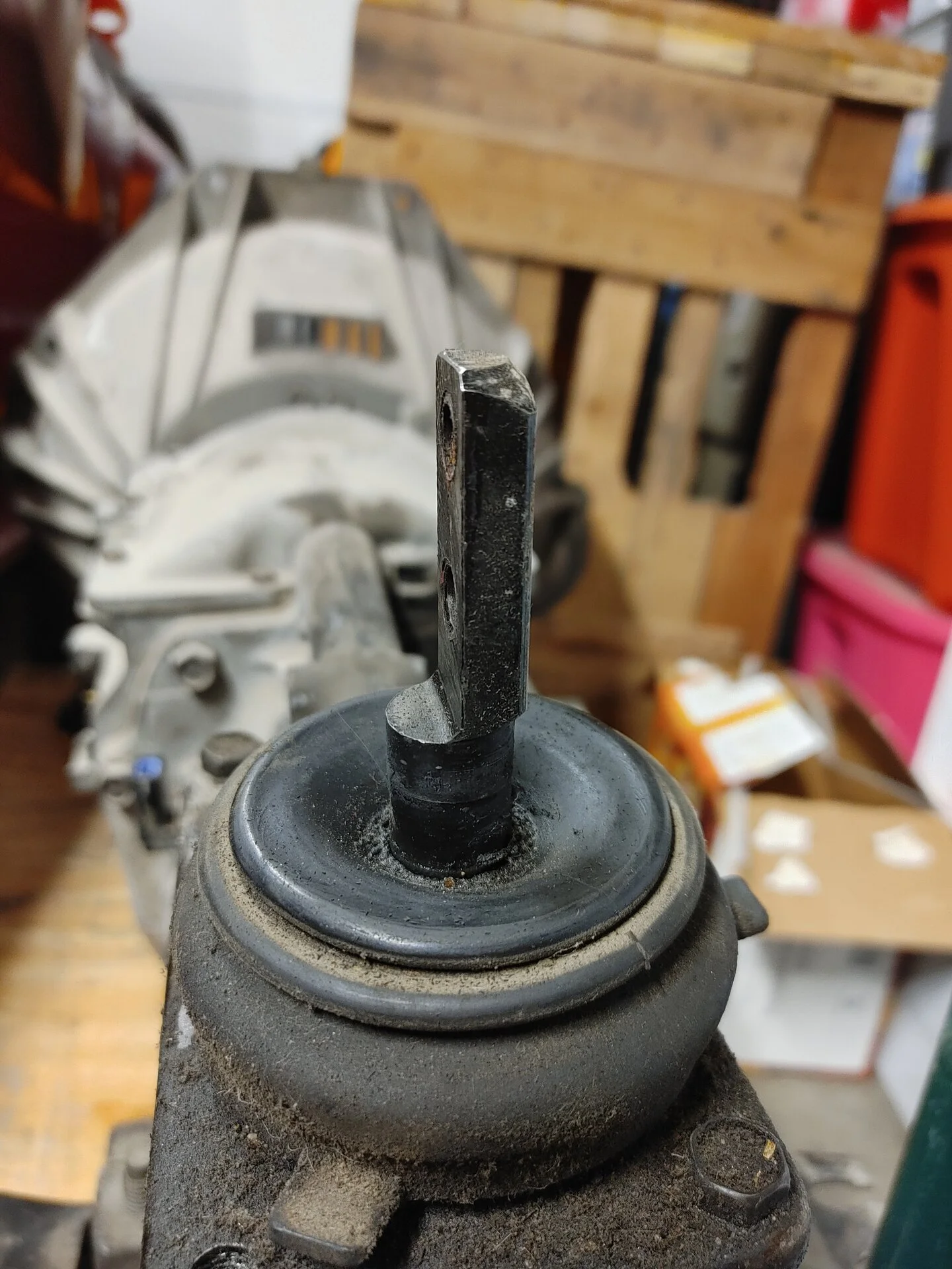

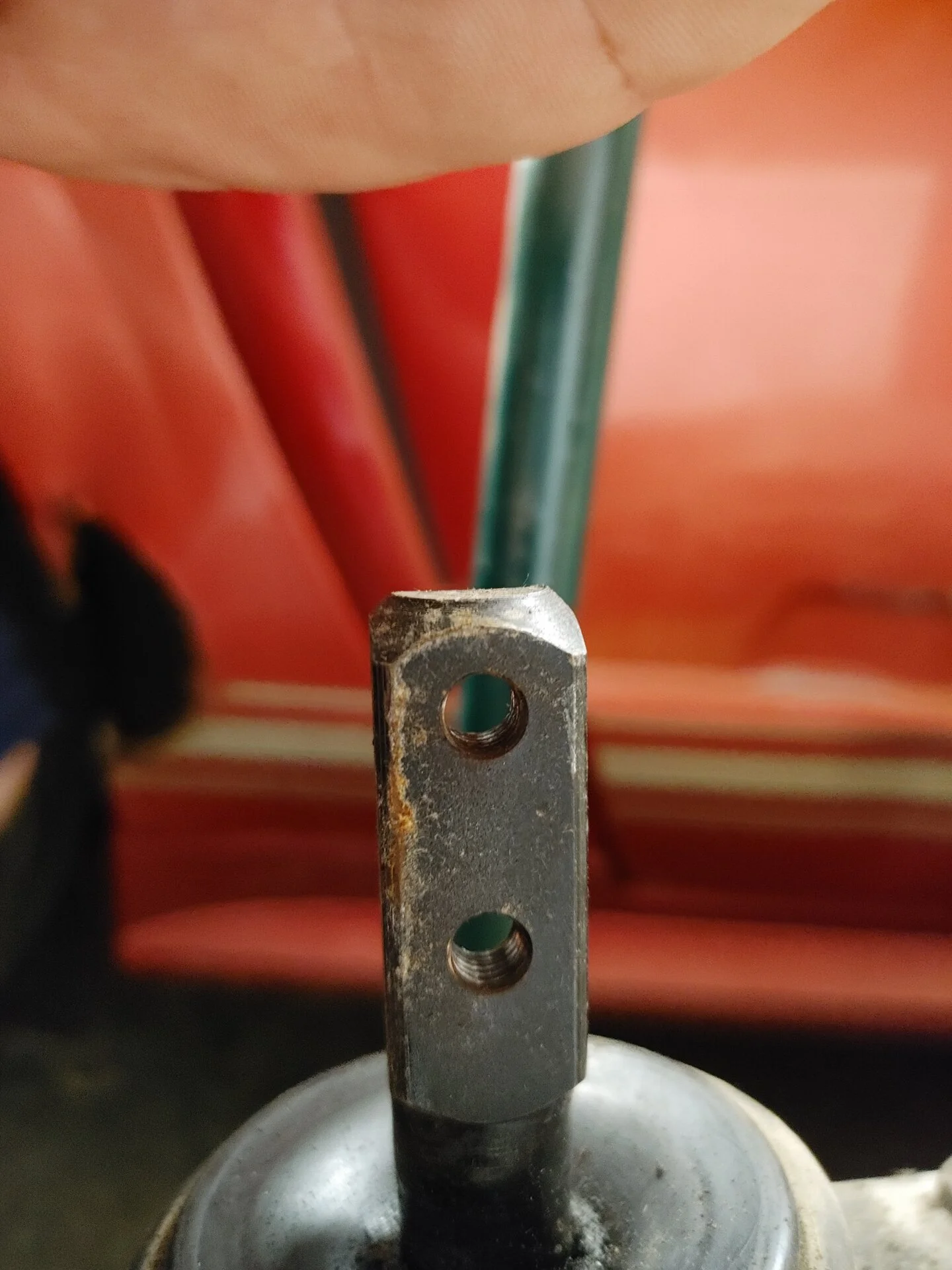

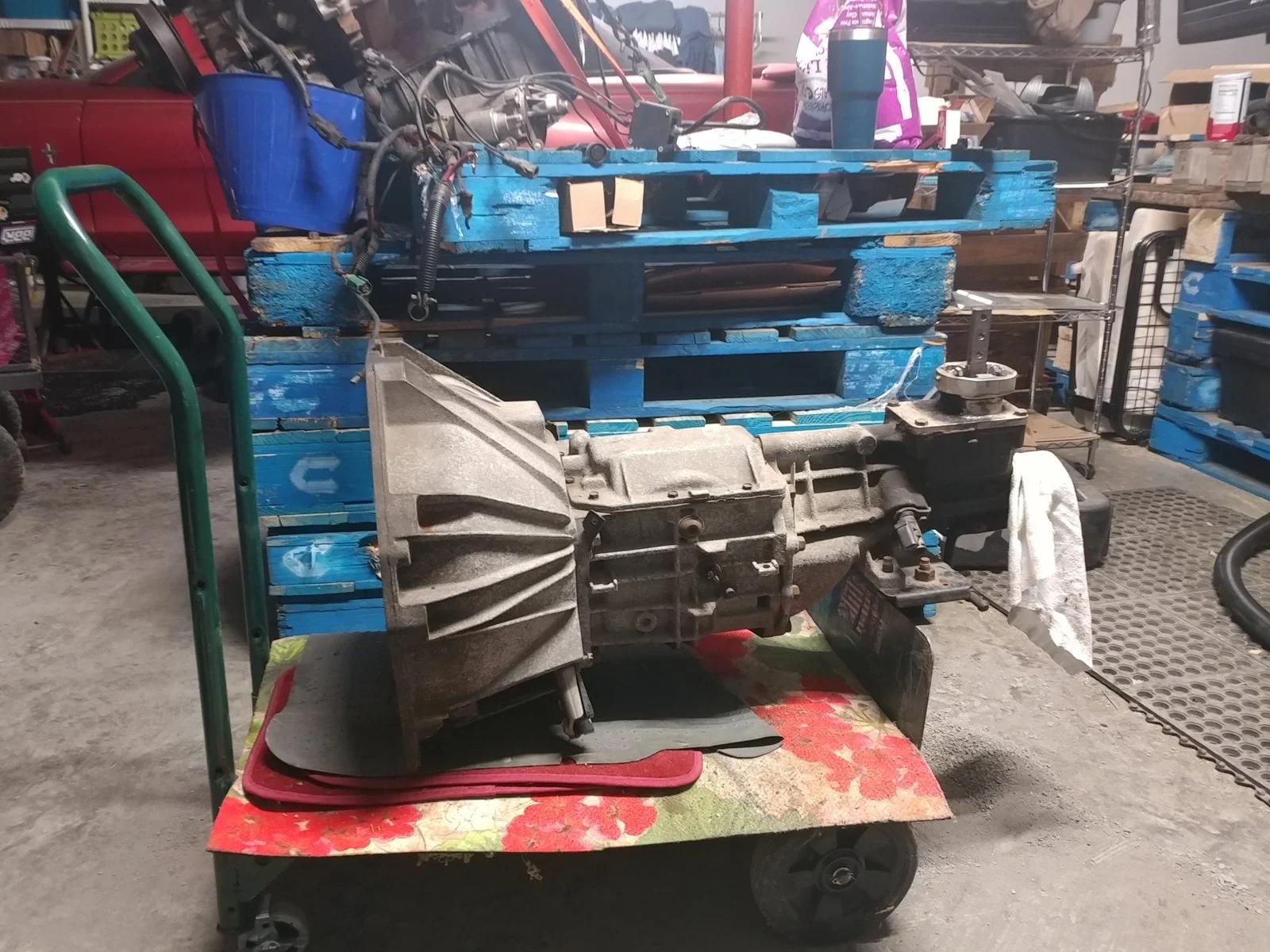

My son's T5
