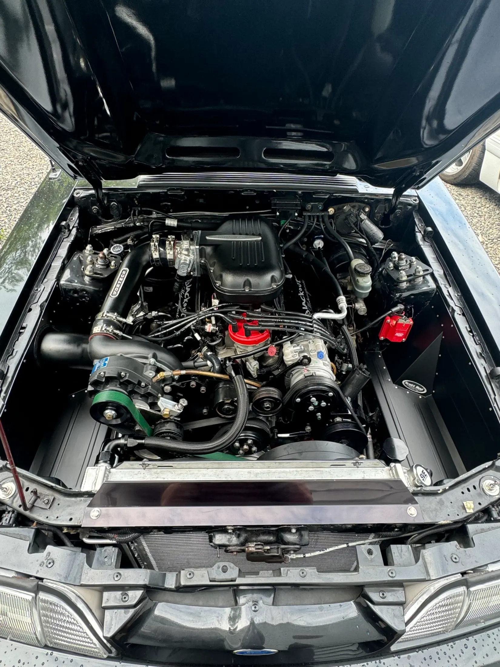

I'm going to take another crack at this, because ultimately I do want to install this intake and I believe IT IS doable with a stock height hood and OEM height k member.
I was researching past posts on the installation of this intake and stumbled across this Corral.net article from 2018.
https://www.corral.net/threads/trickflow-r-upper-vs-trickflow-box-r-upper-actual-dyno-test-and-analysis.2515434/
Within the post, the author "engneer" talks about gaining 33 horsepower by adding a Box-R intake over his old R-Series on his 331 engine with 190 heads. How did he make a 1 1/4" taller intake fit under his Miata hood? He purchased online and utilized a 3/16" adapter plate https://docs.google.com/forms/d/e/1...thuYNgjruB5kfJ4O853BSsy2Y5BlSA/viewform?pli=1 rather than the 1" plate the Box-R came with. Additionally, he ground the base of the Box-R in order to get the taller 12 1/4" Box-R the same height as the 11" R-Series. This created some additionally problems in itself, but since you all have been so supportive in helping me spend money, I'm going to ask for solutions here again on the following areas:
Distributor: the OEM Ford Mustang distributor is not compatible with a 11" tall Box-R intake. So I'll have to purchase a reduced height disturber. I know Holley makes some. For those who have done this, what is your suggestion?
Fuel system: My existing Kirban fuel pressure regulator hits the underside of the Box-R. A Standard Ignition non-adjustable fuel pressure regulator is considerably shorter, but still hits the underside of the Box-R. I understand I'll have to bend the fuel pressure regulator base plate downward to create more room. Additionally, the fuel pressure return line coupler hits the underside of the Box-R. Other than purchasing aftermarket fuel lines, I suspect much of the return line could be bypassed completely by cutting it and connecting a fuel rated rubber hose from the regulator base to just behind the alternator (see photo). This would give the Box-R underbelly the additional room needed to sit flat on the lower intake without rubbing anything else. If this is unwise though because of the threat of fire, what would be the better option.
So that's it, I believe. Purchase a new reduced height distributor, tweak the fuel pressure regulator downward and remove the return line coupler connector.
If my existing 11" R-Series fits under my stock height hood, then logically a reduced height 11" Box-R would have all the same throttle body and fuel linkage attachment points and should be fine.

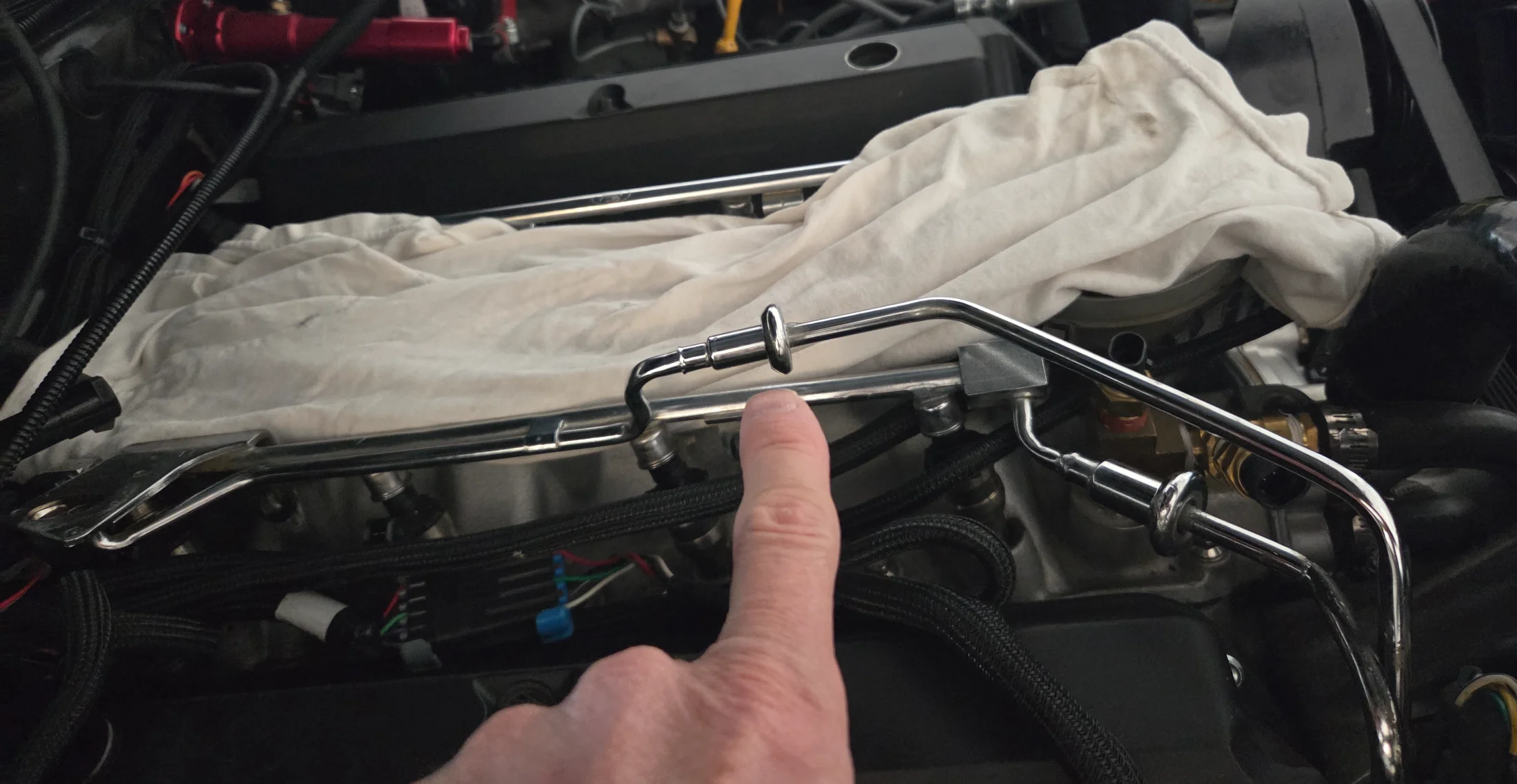

I would just cut both ends off and have some steel 6AN fittings welded onto them. Find a reputable tig welder and that should be a piece of cake. Then buy these adapters to go from the stock lines to 6AN (other companies make them as well):
https://www.russellperformance.com/ford-return-side-efi-x-6an-fitting-with-black-finish-640873.html
https://www.russellperformance.com/...i-x-6an-fitting-with-black-finish-640903.html
So what I am talking about here is ditching the two hard lines between the fuel rails and the lines they attached to down under the passenger subframe in front of the shock tower. Use the adapters plugs some 6AN fittings and braided 6AN hose to connect to the 6AN adapters on the stock fuel lines and the 6AN fittings you have welded to the stock fuel rails. Black hose and fittings would look really good in my opinion.
Remember, you said to spend your money.
