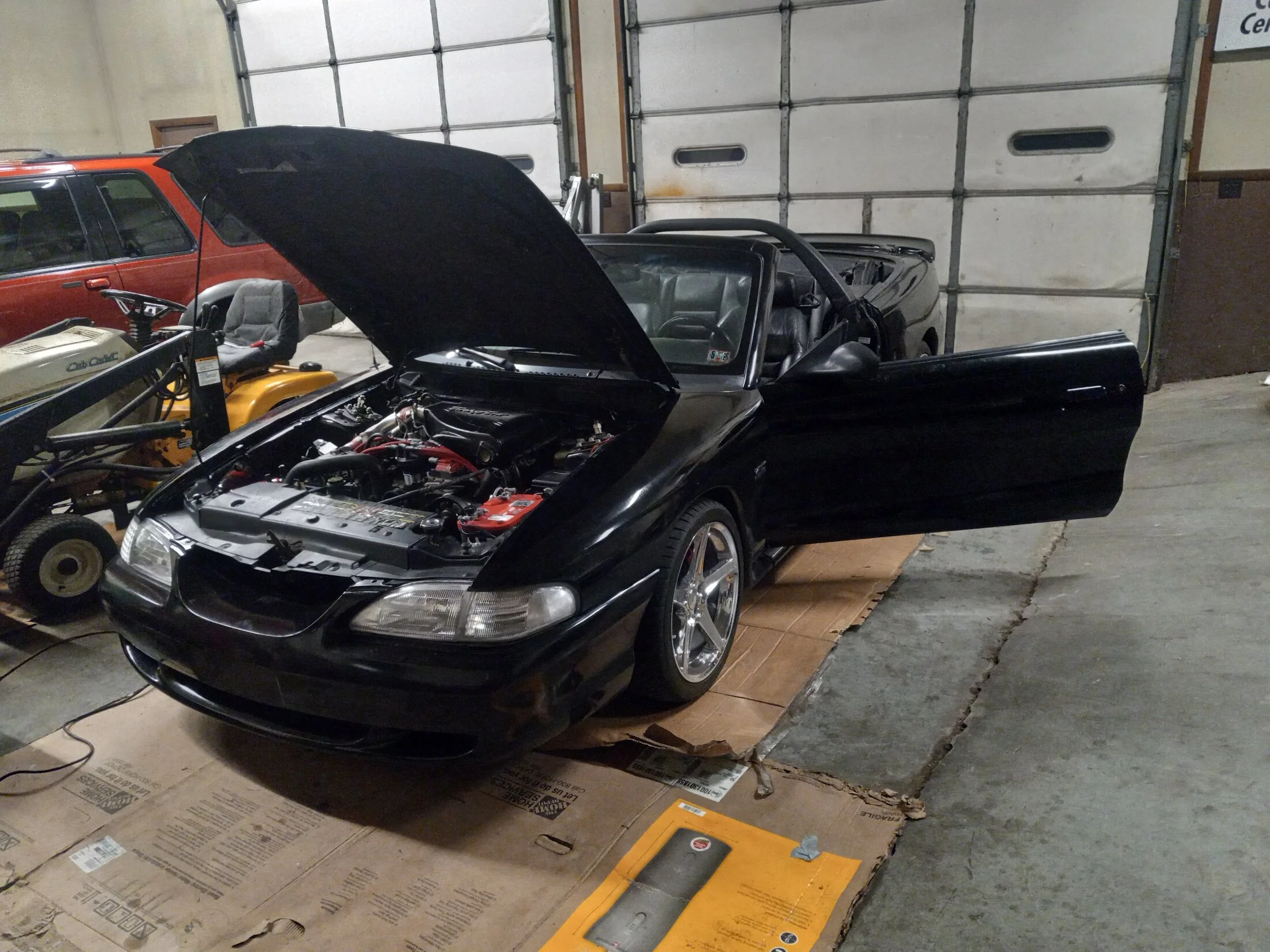

Hey guys need a little advice. I don't know what to set my base fuel pressure to. Some guys say 40 psi base with vacuum off and plugged, some guys say 55 to 60psi base. Just bought the car and put new fuel rails and FPR on it. I have the base set at 42psi drops to 39 with vacuum on. Car does run rich at this setting. Here is what I'm working with: 1995 gt 331 stroker. All emissions delete EGR delete etc. Trick flow track heat upper and lower intake. TFS stage 1 cam. Twisted wedge heads 1.6 rocker arms. Trick flow fuel rails, unknown aftermarket FPR with guage. Accell 30 lbs injectors. 70 mm accufab throttle body, 75 mm mass air sensor, custom cold air intake. 190 liter fuel pump. 5 speed manual. Any help would be great, I'm so new to EFI and have little knowledge on these things as my previous mustangs were carbed from the 70s. Car is running rich, but runs good. Just want to make sure I'm in the ballpark of correct FP. I've read anywhere from 40psi to some guys saying 55 to 60. This is a NA engine, no boost. Thanks everyone!
