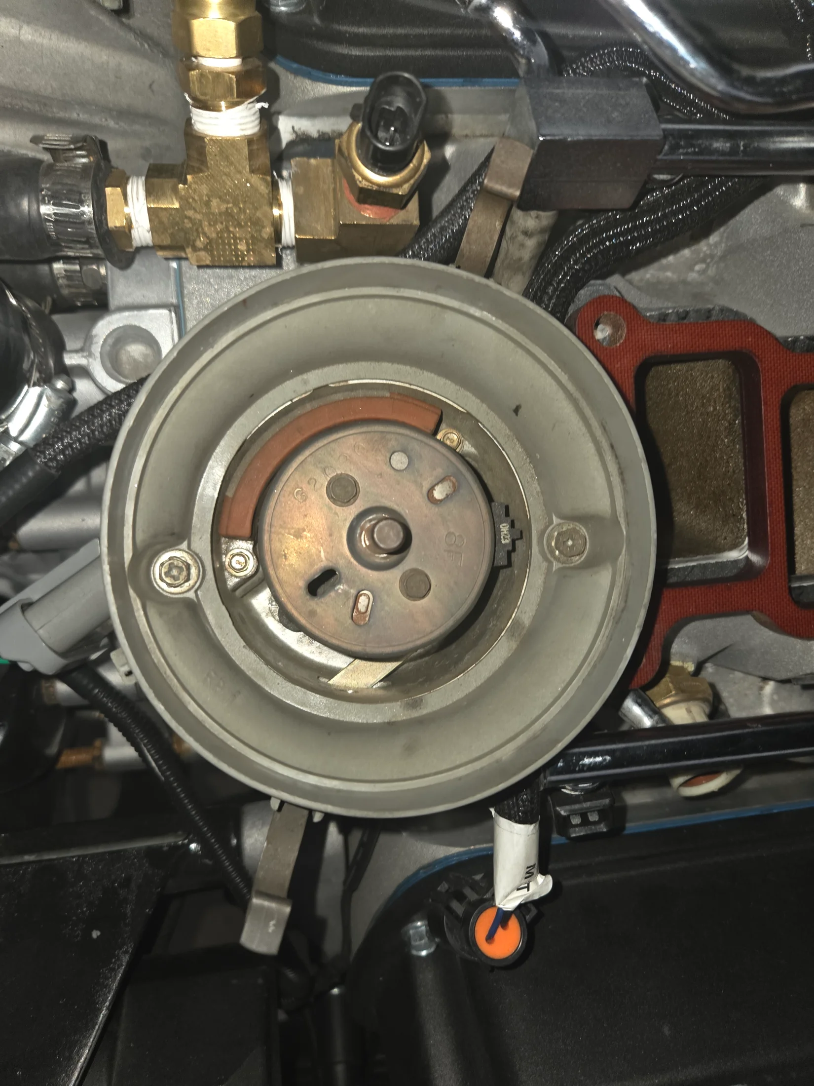

Would this help?
View: https://www.youtube.com/watch?v=mQ8zjOdz1rE&list=PLcVDdk9ePTEE-xnYKWiyA2tXWdQASm9kx&index=3
Those are noth Vac operated. I have not looked at ours to see if the same is possible.

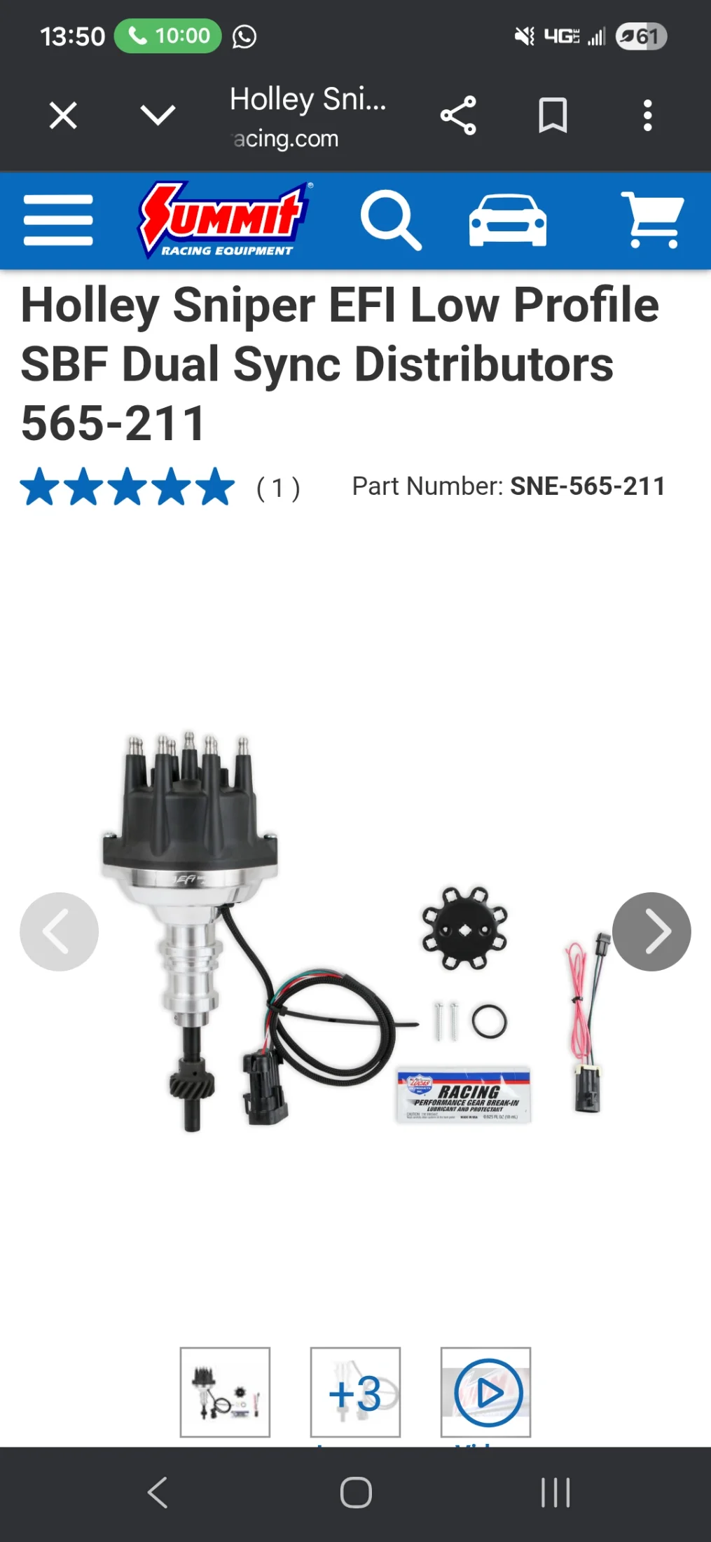

I have the Holley Terminator X ecu. How much shorter is your distributor? I suspect I'd have to go your route distributor wise if I reduced my Box R's height by 1.25 inches.
Thought you were still on a stock ecu I apologize , it’s shorter for sure

Was it plug and play for you? Install and fully connect able with your Holley ecu?
You have to run a ignition box with this as well if you don’t have one
You get the distributor which plugs into your Ignition plug on the main harness. The white points wire gets hooked from the lose wires in the main harness now to the msd box points wire. Msd feeds the coil and that’s it.

I spoke with Holley and they confirmed tbis MSD distributor is quite shorter, but I'd also have to run an ignition box as you mentioned.
Gotta mil down the upper, purchase a 3/8" adapter, MSD/Holley distributor + ignition box, aftermarket fuel rails and adjustable FPR. The cost keeps racking up bigly.

I dont see how to attach the Standard AL482 cap as the old collar is attached by two screws and the new cap is snapped in place.

I keep meaning to try it but never got around to it.
I have a spare distributor out in the garage. I may order the parts and see what's what, first-hand.
This would likely solve my distributor height issue and honestly save me almost $1K for a distributor, ignition box and adapter connector.

I just ordered both parts from the Jungle Website.
I'll let ya know what I find.

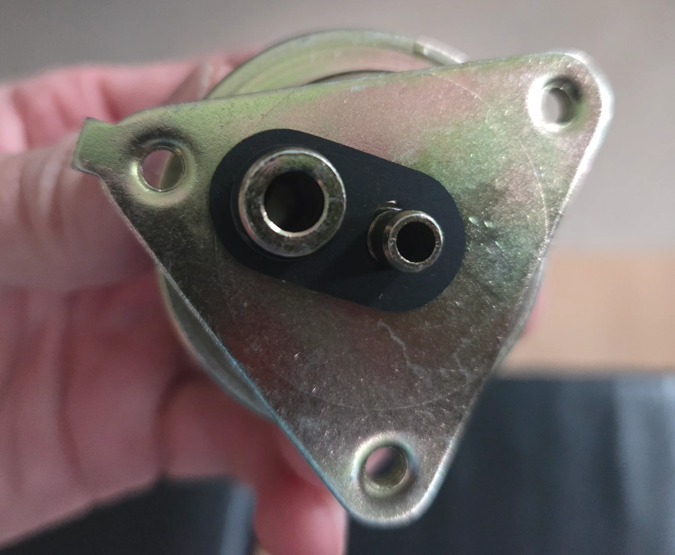

Do I need to apply any dielectic grease or anything to the rubber oval on the base of this non adjustable fuel pressure regulator to ensure good sealing?
