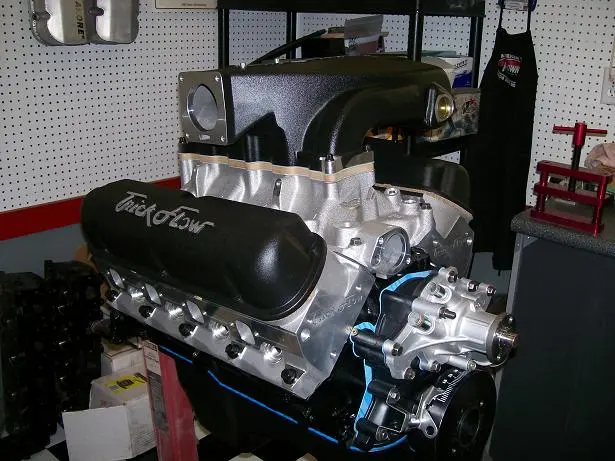

Guess I'll see when I try to lower this bad boy in there.
