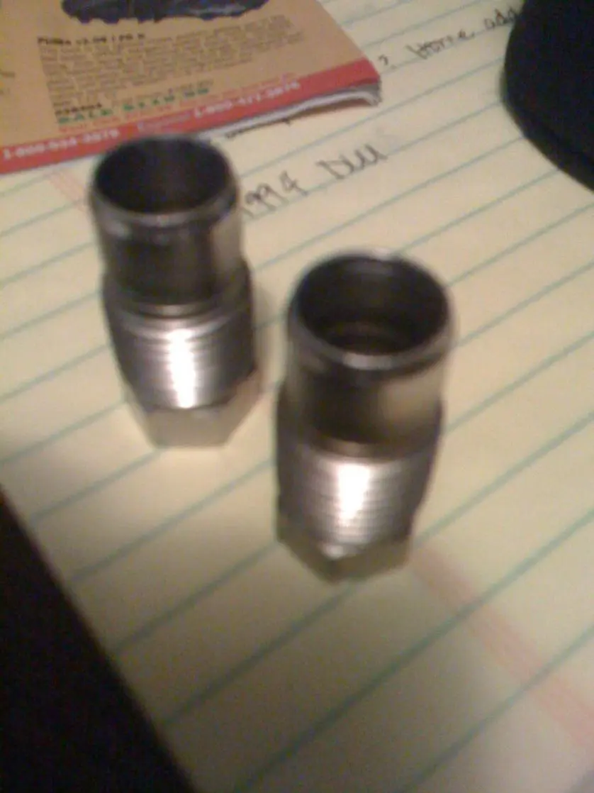

As the title say i TRIED to change my spark plugs today on my 2005 that has 60,000 miles and i got 6 of the plugs out with no problem and on the last two plugs the nut and thread came out and no plug. I am now fishing for some answers. Do I now need to take off the head and take them out that way or can i soak them some more and finish sliding them out.
since the porcelain is still in the head you need to get that out first then the rest of the plug..
first thing you need to do is pour a little under a teaspoon of carb cleaner down the plug well and let it soak for 20 minutes or so..
then using long needle nose pliers try to remove them using a up and down motion
if you get that removed then you need special tool 303-1203 and I can post instructions on how to tap and use the tool to remove the ground electrode shield
if the porcelain breaks in the shield then you need special tool 303-1398
good luck

I finally finished taking out the pulls. I ended up ordering the Lisle "tool mentioned above" it worked out great. I would recommend that tool if your plugs break. Its not that hard to use and they (2 plugs) in 30 mins.

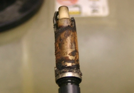

What makes me nervous about this tool is the picture in their blog thread of the extracted ground shield. Their tool first pushes the remaining porcelain further into the ground shield to expose an internal bore for the left hand extraction thread to grip onto.

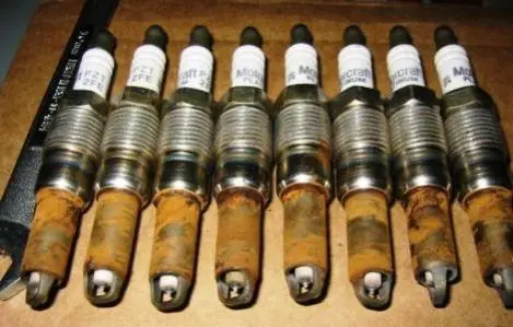

The first picture is what the original intact plugs look like - notice the intact ground strap electrode.
The second picture is an extracted plug. The caption says that the electrode is broken, but it looks like a piece of the electrode and ground shield are actually missing. Did those fall into the cyclinder? If they did, I can't think that's a good thing. :shrug:

Mine did that but it doesnt seem that any of the ground shield fell in. I turned the engine over a few time just in case (with out the plugs in) to blow everything out. I put like 60 miles on it today and everything seems fine. I guess time will tell if anything fell in. If it did then that just gives me a reason to get a short block.
