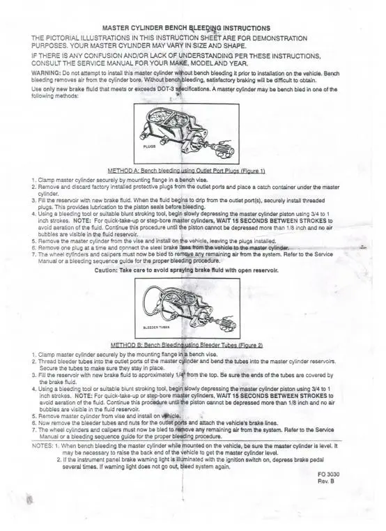

I had plenty of trouble getting mine bench bled in the car, aparently it can be done if you get the MC level by jacking the car. I pulled mine and did it on the bench. It took many pumps, i wonder if you are allowing air back into the system with the setup you are using for bleeding.
I made up my own bleeding set with some old brake lines / fittings and some clear hose method b (See attached distructions).
The other trick is to not pump too fast, this foams the air up, if you bleed it on the bench it must be level.
I got through 1/2 a box of beer while i was doing this, for best results take your time .....
Steve

This is correct. If you jack the rear end of the car up high enough to make the MC level then you can bench the MC in the car, I have done this and it does work. Its best to just bench the thing before it finds its way into the car but some times that just doesn't happen.
