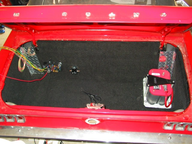

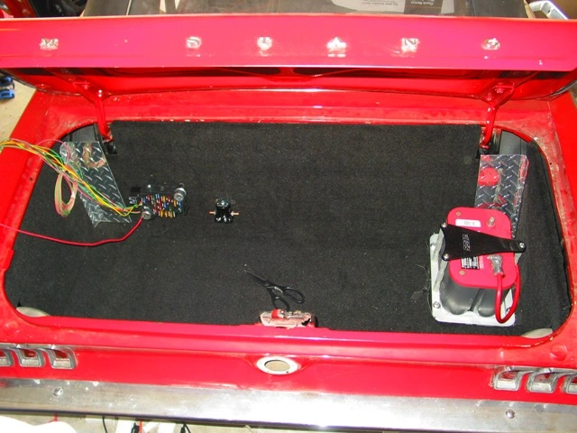

Here are some pics of what I did to mine. The wiring isn't complete in these pics, but you can see how the trunk is done. The panels were made from MDF (fiberboard).The front (solenoid panel), bottom, and rear are covered in carpet, while the 2 side pieces are covered in the same fabric I did my door panels in. The solenoid is from a mid 80's Mustang. I found it looked better as far as wiring goes. The box is for tools or other things. The 2 billet lights in the rear panel come on when the trunk is open.
The "kit" you guys are talking about might be the $180 one from Texas Mustang
http://texasmustang.com/trunk carpet.htm
